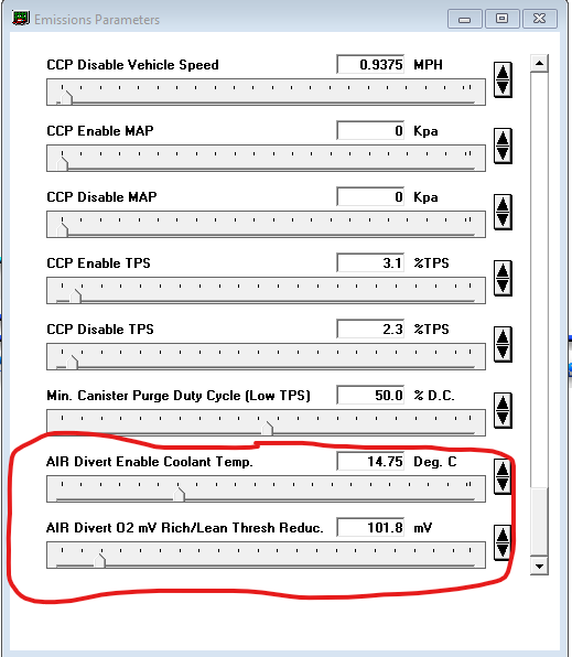

I don't believe that's the case.
In the 8D code at least, there is a 100mV offset applied to the O2 sensor reading when the air pump is on.

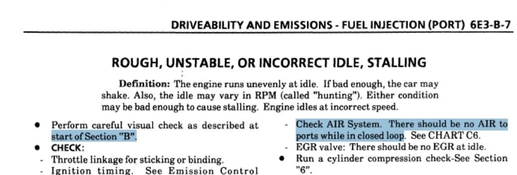

I don't have 8D but if that is there I would sure like it. The below image is from 87 FSM says in exhaust in open loop and if air flows to exhaust at all times it can cause a rich condition, could you please post the 8D page it would help.
Thanks

Here's the 8D... I looked in 6E, but didn't see anything. Maybe that parameter simply wasn't added to the definition file for Tunercat or Tunerpro. Even in 8D sometimes one or the other will be missing a parameter.

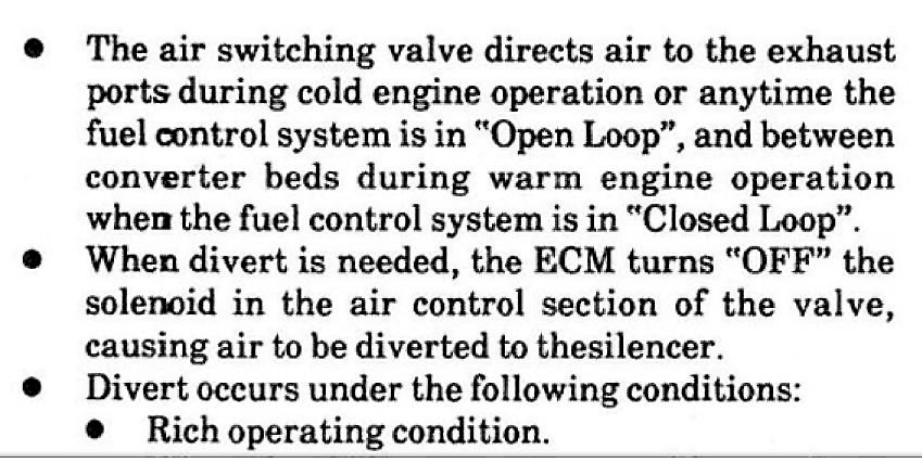

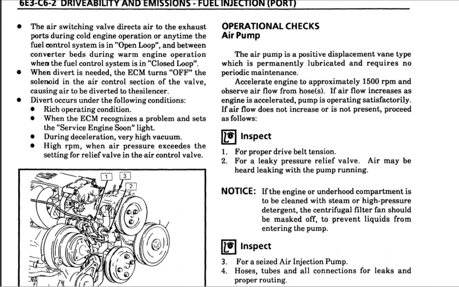

I believe it is the control valve that opens to the exhaust ports, your 8D stuff is interesting and I don't know what to make of it. I did find this trying to post something for rough unstable idle.
Thanks for the info
