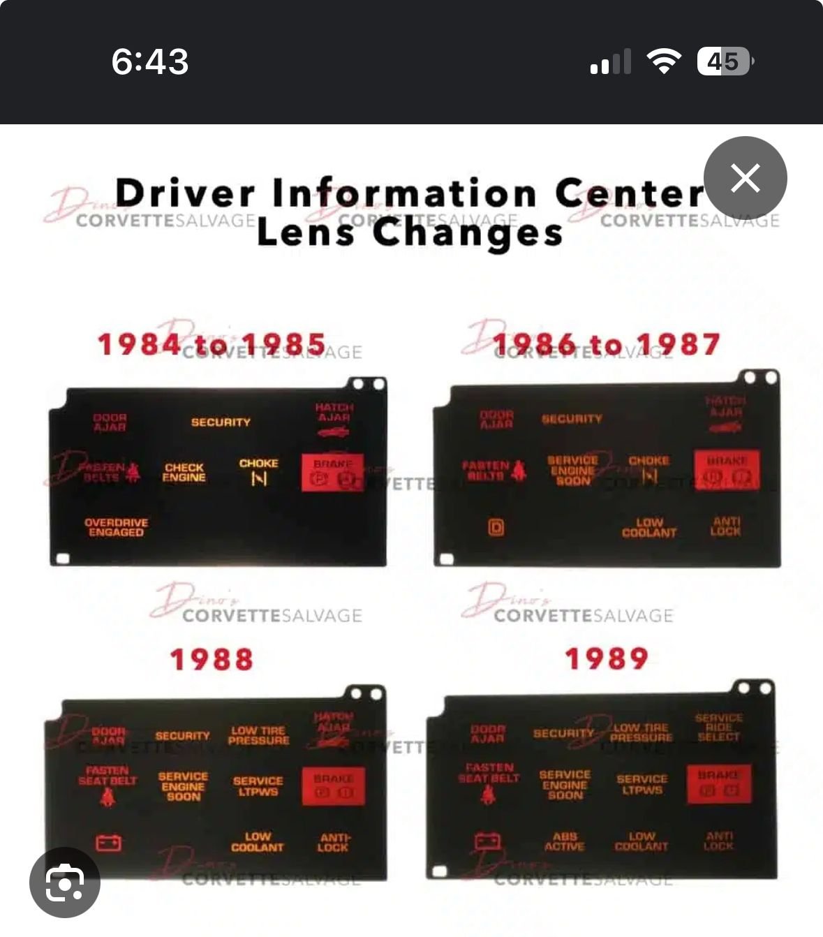

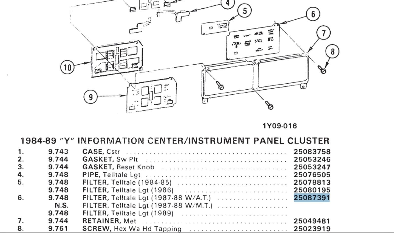

Looking for a replacement DIC Lens for a 1987 (manufactured 11/86)….every site I look at says 86/87 lens are the same.
I installed the “86/87” lens only to discover that there is an OD light instead of the battery warning indicator in the lower left. There is already an OD light in my tachometer LCD.
Any idea why my lens appears to be a one off?

Based on the snapshot of the different years, I would guess you have a late production '87. It appears you need the one shown for '88....again, I would guess that GM started the lens change at the end of the '87 run, not at the start of the '88 run👍

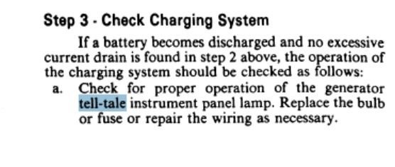

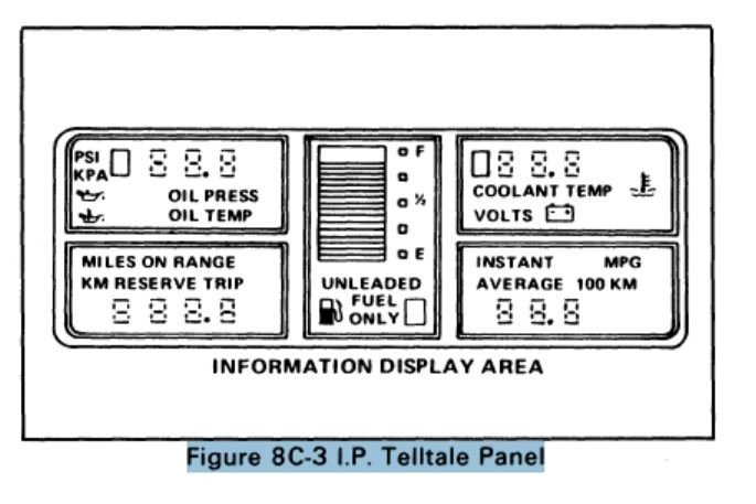

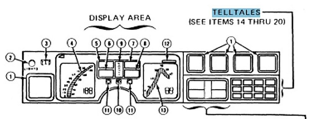

Just checked my 87 built in 2/87 and I have the red battery light lower left. Both the owners manual and the FSM botch the name of this panel using interchangably DIC and Tell Tale panel. The DIC is supposedly the fuel gauge area and the Tell Tale panel is the panel your replacing.

35+ years later who knows when/if maybe the DIC assembly was changed. I don't believe suspecting an early/rolling change as mentioned to be correct. The PC I believe is likely the same so when advertised everywhere 'multi year' is always mentioned. Can you find a vendor for only the filter?
I find some GM SPO information that suggests that maybe Dino's images are maybe incorrect. Their info is generally thought to be pretty reliable but ....
In an older GM SPO I see 25080195 for an '86 and then 25087391 for '87 and '88 'filters'.
OP - if yours is still out of the car there should be a label on the housing. What is the number & 3 letter code on that label?

This should be yours 25087391 if you have an AT tranny.

That's exactly why I asked the OP for the 3 letter code and the part number off of the label of his DIC. I'm trying to 'help' the OP by maybe identifying what he has now AND maybe what to do to validate! Your link looks to have supplied what he's included in his original post?

It just corrects his post that it is not 86/87 that are the same but 87/88 that are the same. Or to be highly technical "pick the one that matches" .
Corvette Central looks like they have it wrong at least for automatic, maybe that is for the manual tranny.

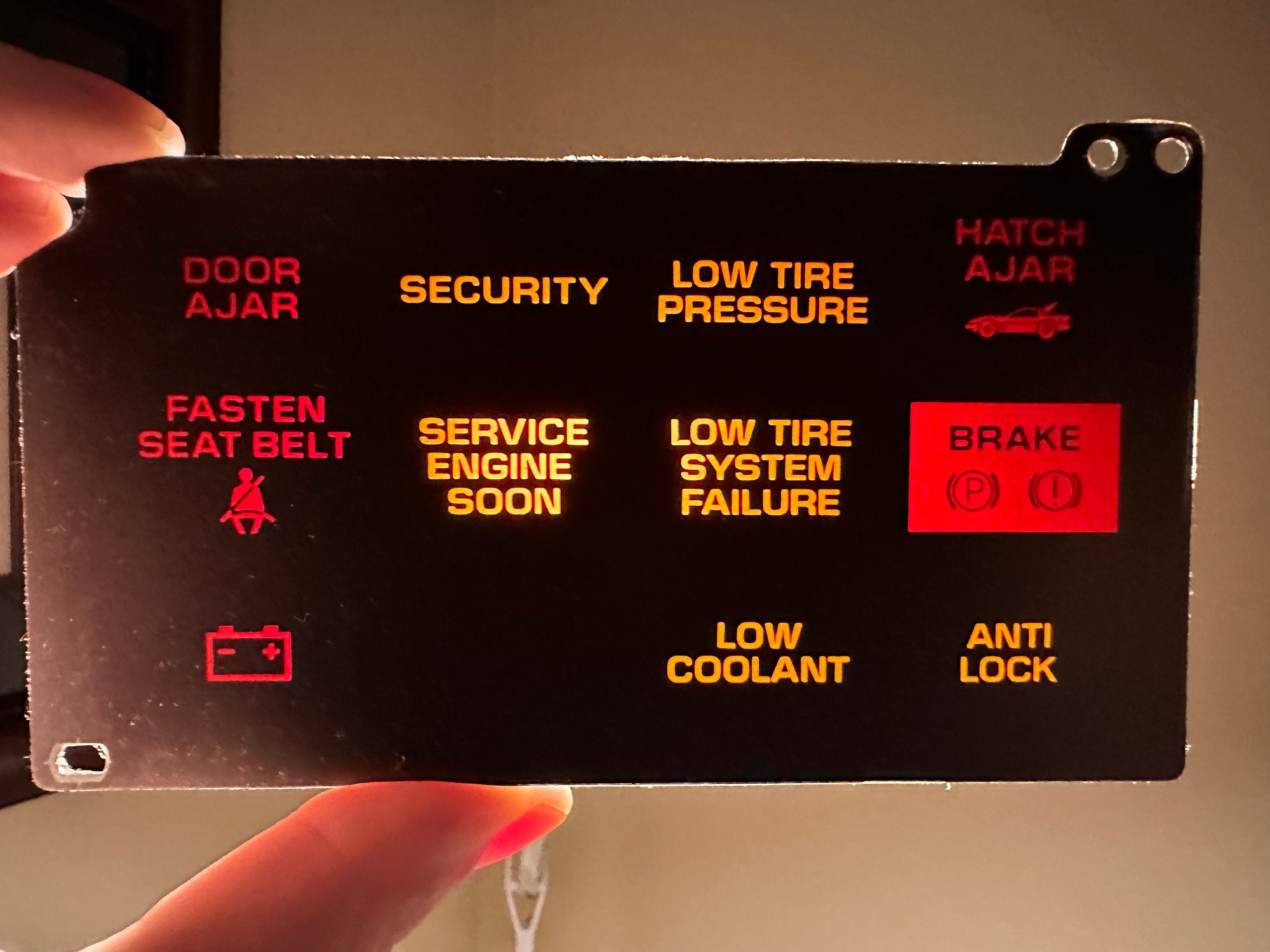

I'm not sure about this. They had tried to start the tire pressure monitoring in 87 but was a failure they only built 41 cars. The warning for giving the Low Tire Pressure in the information centre might have already been in production. I would agree that it looks as if the 1987 and 1988 share the screen.
