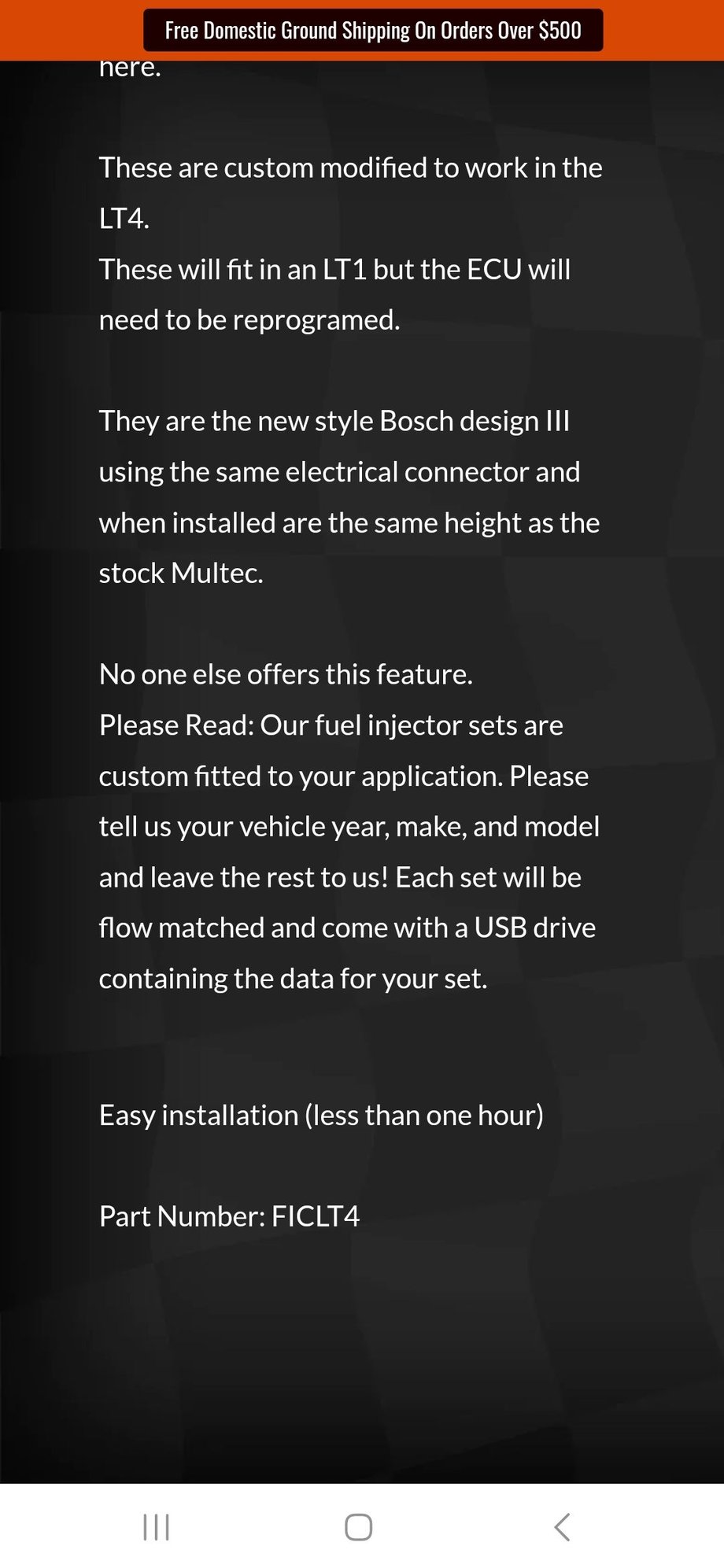

This is the description of the injectors I bought. According to FIC, no tunning required unless being run on an LT-1.
https://fuelinjectorconnection.com/p...l-injector-set
