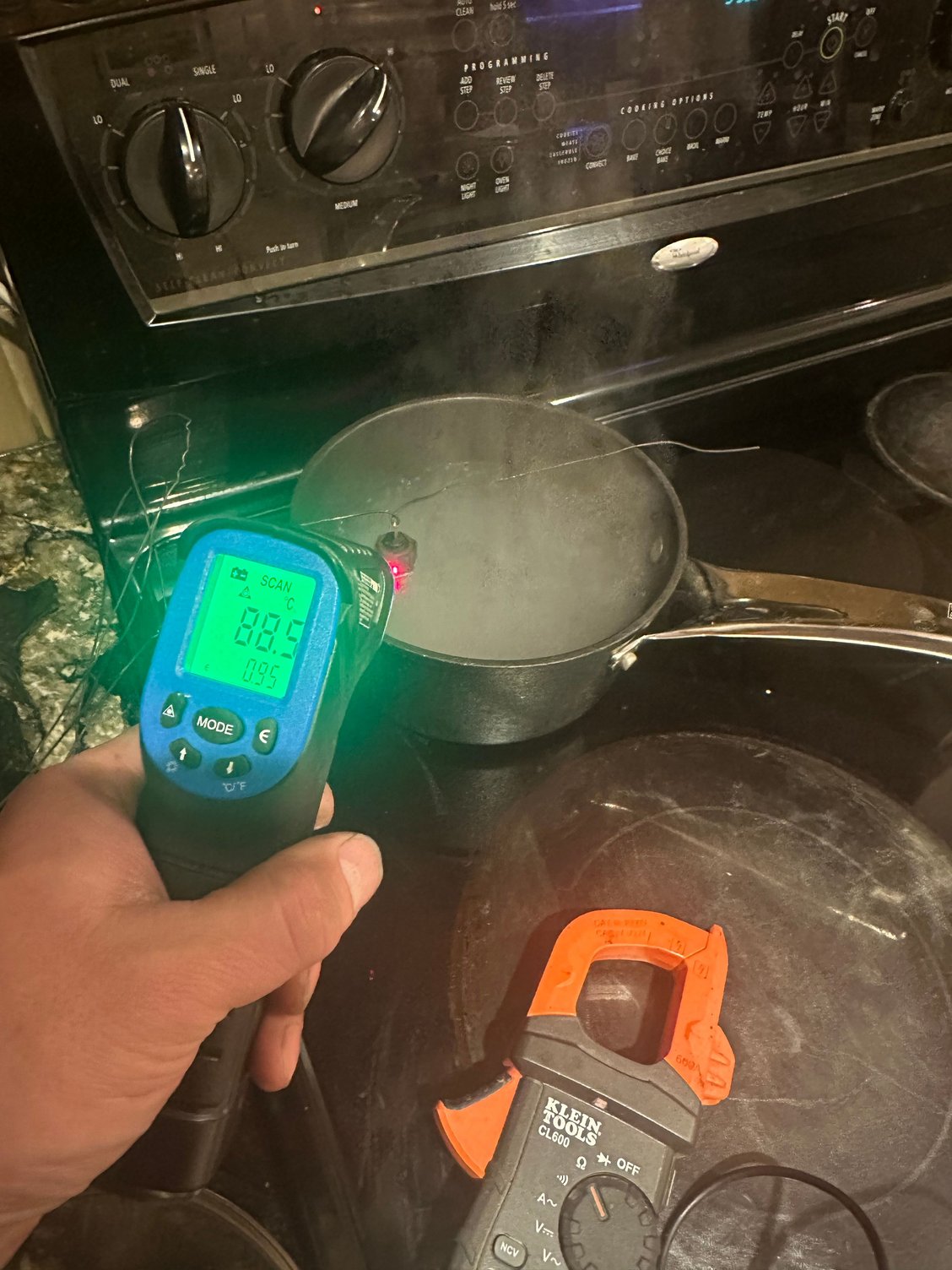

84, fan is operated by a temp switch, passenger head btwn 6 & 8.
Car came to us with dead engine from overheat.
As im about to drop a resealed donar engine in, i have been checking everything i can to discover root cause of overheat. Furthermore the car had a manual override for the fan operation. So, proper cooling system operation is suspect.
Hence testing rad fan switch.
i read the switch, if factory, which it appears, grounds the switch on the relay when temps reach 230f (110c)
I could not get my boiling water to surpass 95c. I could never reach continuity btwn the blade and the threads/sensor body. OK, needs to be hotter. So i never verified it was capable of creating the ON signal/ground.
But here is my question….
I switched to resistance, i watched as the ohms increased as it cooled. in real time.
Why would it do that? Id think this should be either ON or OFF. As i watched the resistance increase with every second that passed as it cooled….i wonder if maybe a PO bought a “coolant sensor” and inadvertently installed the wrong one for the job. The tested switch appears to behave like a temperature sending unit. Changing resistances with fluctuation in temps.
Will an ON /OFF switch have a scaled resistance?
Thnx, VT.

Im not sure if the blade style that changes resistance that came out of the head was the correct one or not. but i did learn, after using a map torch, that the resistance drops from in the high hundreds of ohms once heated. at exactly 50ohms, the circuit is COMPLETED and exactly 51 the circuit is opened again. Given my harness looks factory, id say this is the factory “switch”. That said, due to the inaccuracy of the flame method i couldnt nail down the actual temp it grounded at. only the ohms. the laser would read 30d difference if inmoved it even a tad. I *think* the 50ohms was around 120c. Too high.
Furthermore, I have learned that proper temp switches turn ON, and stay on even below the ON temp. So the fan can draw the temp down below the ON temp. Whereas this switch that i tested, is on/off at 50ohms like a light switch.
I couldnt get the ts136. I did get a ts147 from my lps. The issue is that nobody posts what the on off temps values are. certainly nobody posts what the resistance levels are in relation to temps.
Either way, i have my lps sourcing a ts 136. It will arrive eventually. In the meantime i’ll head back to my daughters Frostbite 84 thread and keep rolling. Looking to get the valvetrain in tonight 👍
