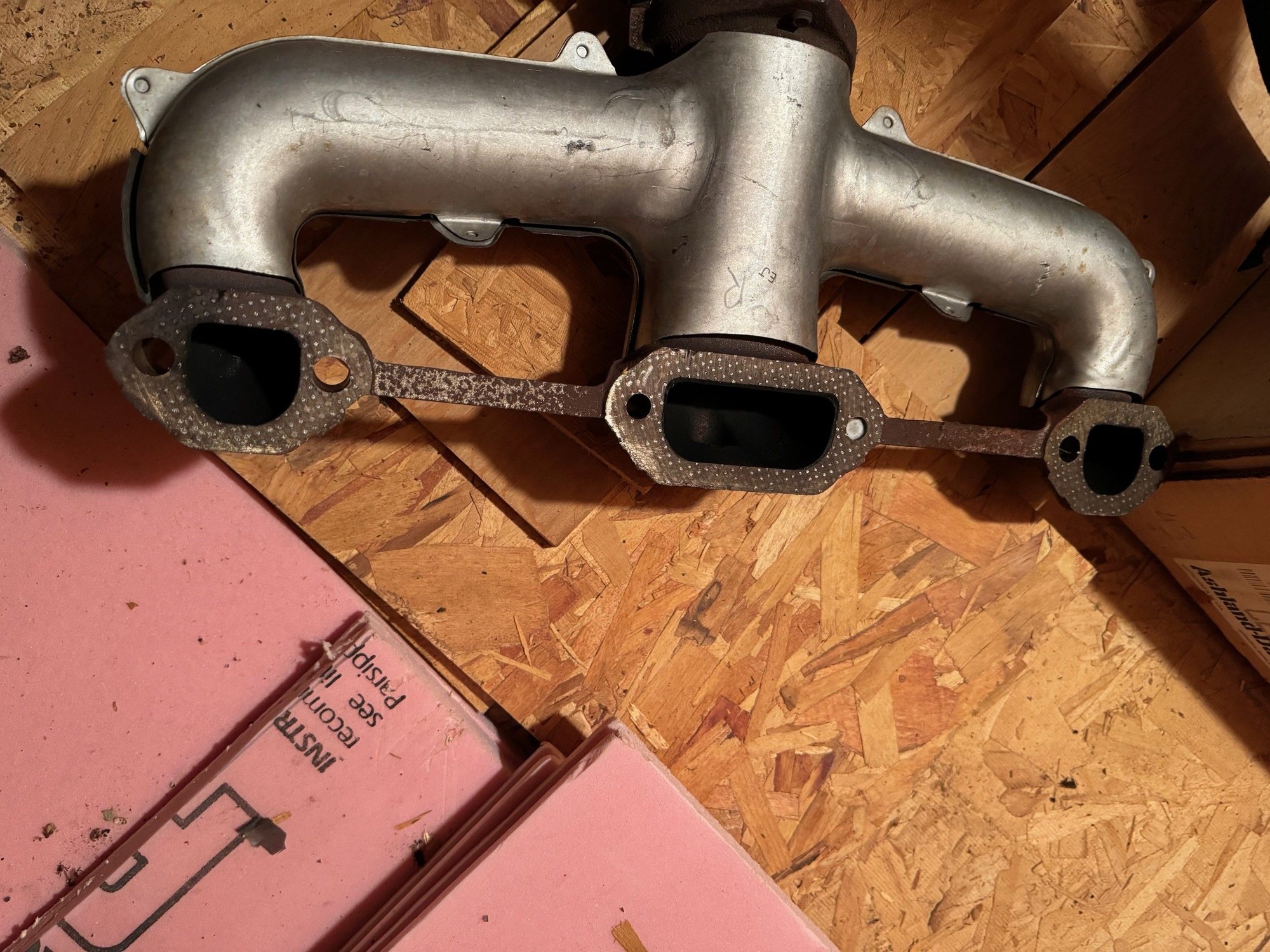

Originally Posted by LT-1 kid
I think the stock manifolds are well designed, headers won't do anything for a stock motor
headers look and sound good, but are hard to install, and expensive, than you need to
customize your exhaust
You think this is a well designed exhaust from a LT1? Hooker shorty headers are much improved over this and are a direct bolt on to original downpipes. No modifications required.
