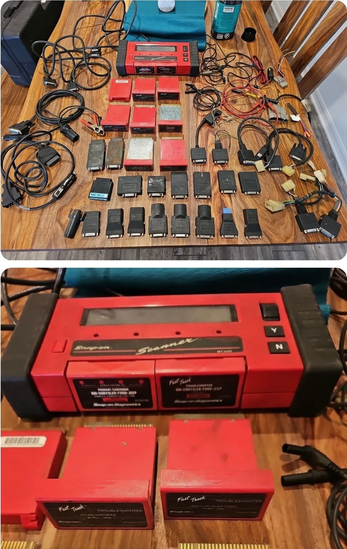

I’ve been told the Snap On MT2500 is a good scanner however I seem to find them bare or all the stuff for every vehicle out there. I only plan on using it for my 89 Corvette to read data so I can evaluate how sensors are functioning & hopefully dial in all the basics before going on to performance changes, etc. I need to stop throwing parts at it & hoping I stumble upon the fixes.
So is this a good OBD1 scanner for a novice use? While they are available on eBay, how do I assure I’m buying a good unit & what additional pieces do I need/want if buying this unit?
