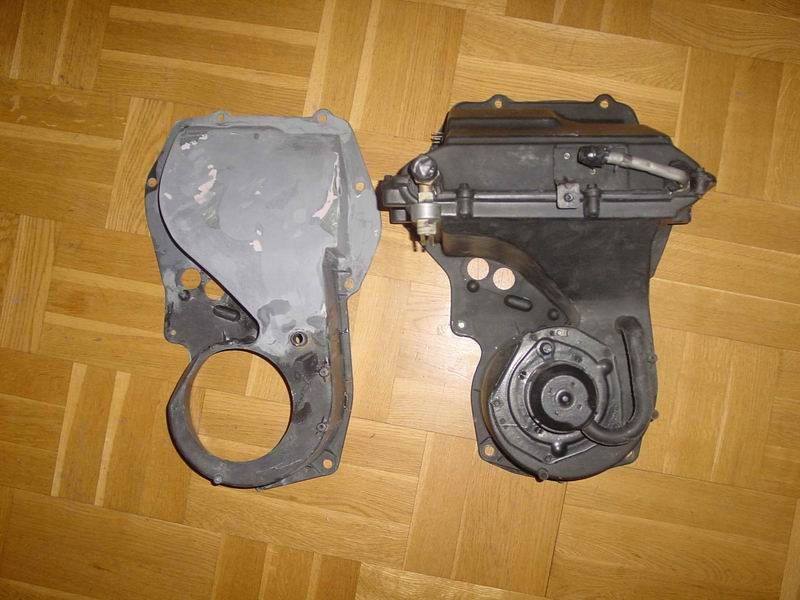

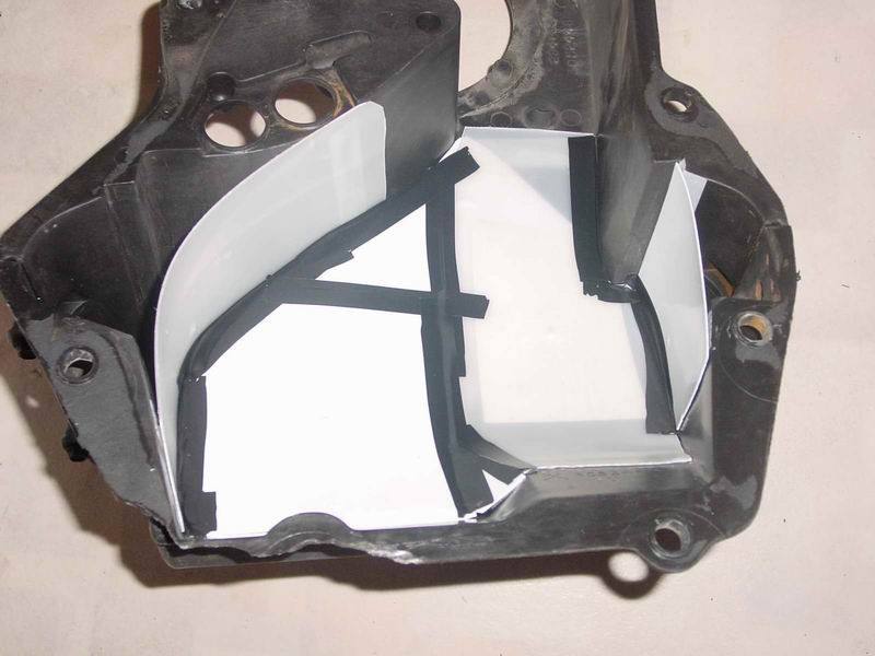

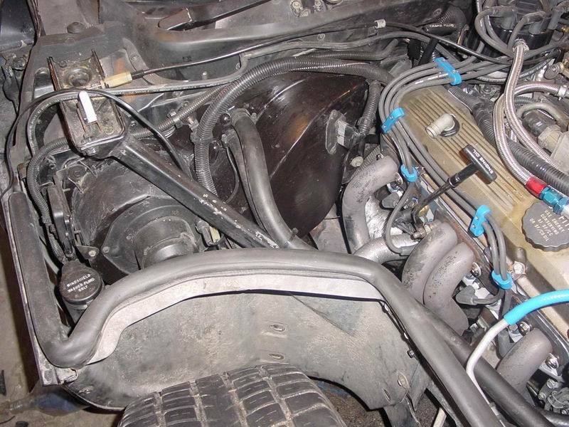

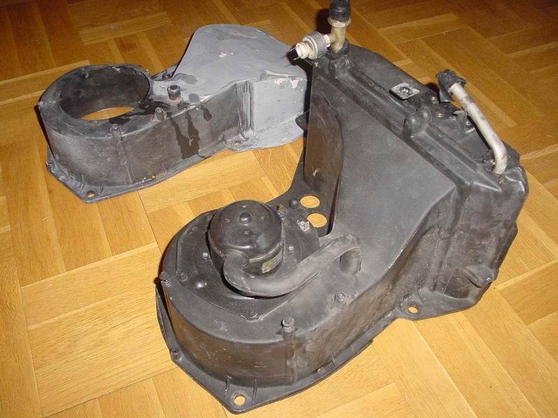

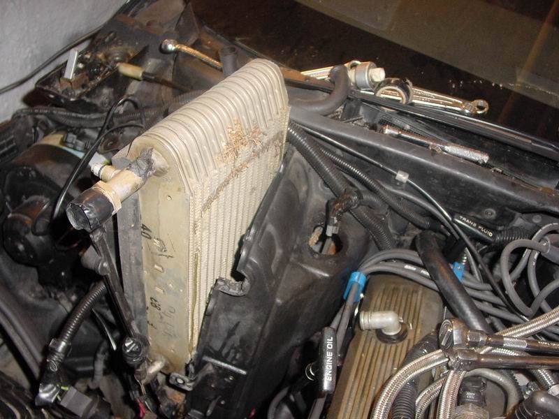

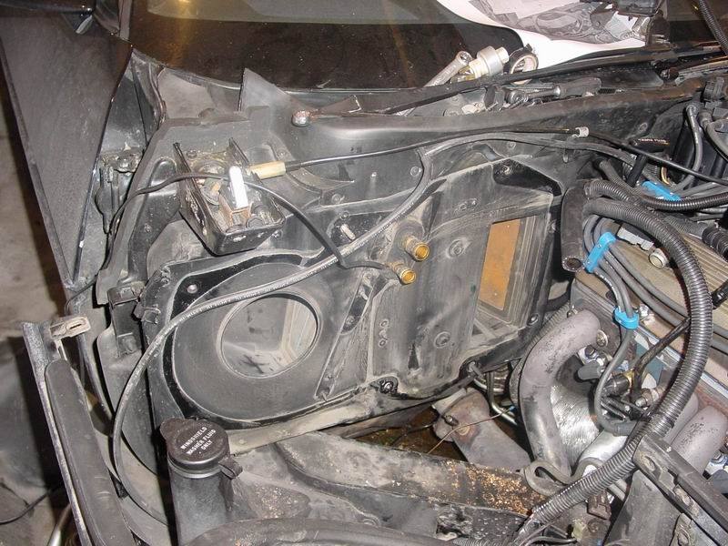

One thing I did over 20 years ago after removing A/C was to modify the fan housing.
On cars models with A/C as option there were often a smaller fan housing without the evaporator, and a bigger with, but the C4 Corvette were never offered without A/C.
It was a bit of work to cut the fan housing apart, create a "mold" and fiberglass a new shape.
I also mixed in black carbon powder from a laser printer in the outer layers of the resin. It did not mix easily but I like the result.
I have very good access to spark plugs and I would do it again,
Finished:
Before:
Evaporator:
As you see the heater core is on the inside:
"Mold" to create the shape:
