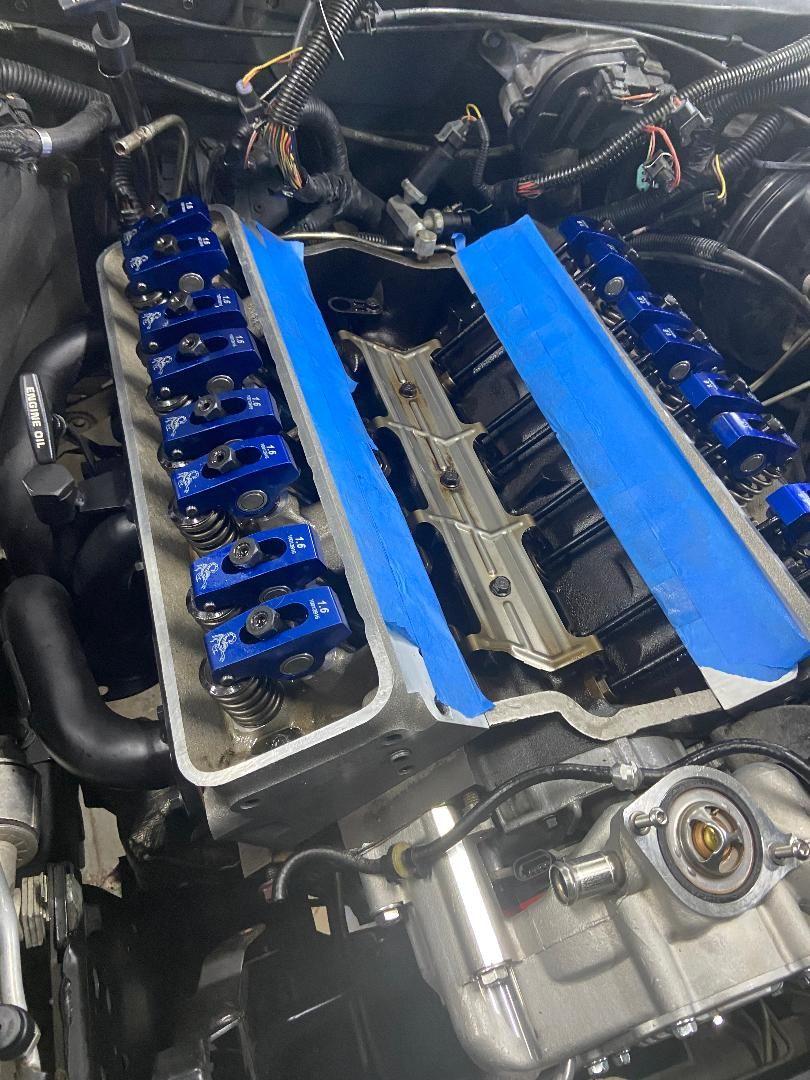

Has anyone experienced that before or have any idea what might cause that? Could it possible be something other than the transmission? Went through the motor in the fall to add some power but everything looked good from the heads up. Decked the heads, added better springs, and some roller rockers. Been running great motor wise.
