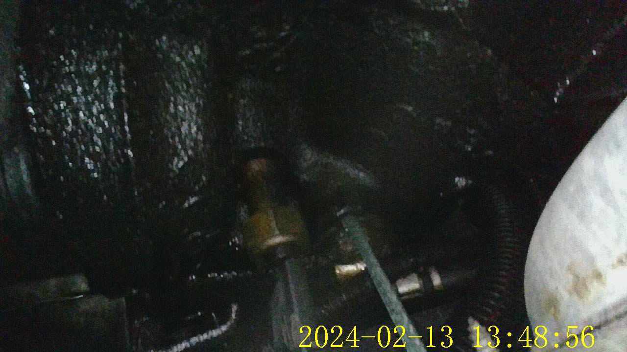

Need some help. I have a BAD oil leak coming from somewhere on the driver side of the engine. Looks to be coming from somewhere above the oil filter but not the oil cooler (Z51). I have a scope and it seems to be coming from the area in this picture. It is not coming from the Oil Pressure switch or sender from what I can tell. What sensor is in the picture? I swear it is coming from it.

Ok, after more research I guess that is the oil temp sensor. I think the oil pan gasket is leaking right around that area. I can see the oil flowing behind the sensor more than from it. Hopefully changing the oil pan gasket isn't too hard?

Does it make sense that oil would only be leaking when the engine is running if it's coming from the oil pan gasket?

UV won't help. I can actually see the leak flowing behind the temp sensor... I am just surprised that it isn't leaking barely at all if any when it's not running. I am going to need to get it up and the air to get a better look I guess. For now looks like the pan at the rear some where.

The leak can be seen happening behind the oil temp sensor not the oil pressure sensor. I am just surprised that it doesn't leak more when the engine is not running.

Engine not running, no oil pressure. No oil pressure, very little if any leak from the oil temp sensor. That sensor is under pressure when the engine is running, just like the oil pressure sensor at the rear china wall.

So yeah, the leak is lower and behind the OTS in the picture... it's basically streaming right at the pan seal. I will see if I can get video with my scope.

Wow... almost a year later.... I fixed my leak today! So it was the Oil Switch! I changed the switch and the sender (the sender was already bad anyway). Took for a rip after, my God I love this car. Laid about 15 feet of rubber on my drive, ahhhh the smell of burning rubber... love it.
