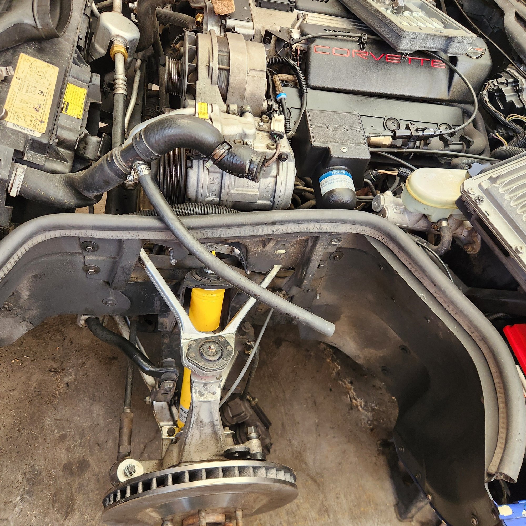

Hi guys! Im New to the forum, i finally found a 1994 manual vette with only 67 k kilometers, unfortunately my damper is vibrating, i Just bought one from dorman but looks differential than the original, do you guys know if i can use this one or i have to sell it an buy another one? I would really apreciate your help and knloledge...
Her are a fe pics of the original and the one i bought...

The LT1 damper is different than the L98, looks like you have an L98 type.

Thanks, i thought my car was a Lt1... I bought the damper before removing it, and in every place i search to buy it, they list the two damper for 89 to 96 corvette... Thats why i dont know what to do... Very confusing.
This is my car by the way...
