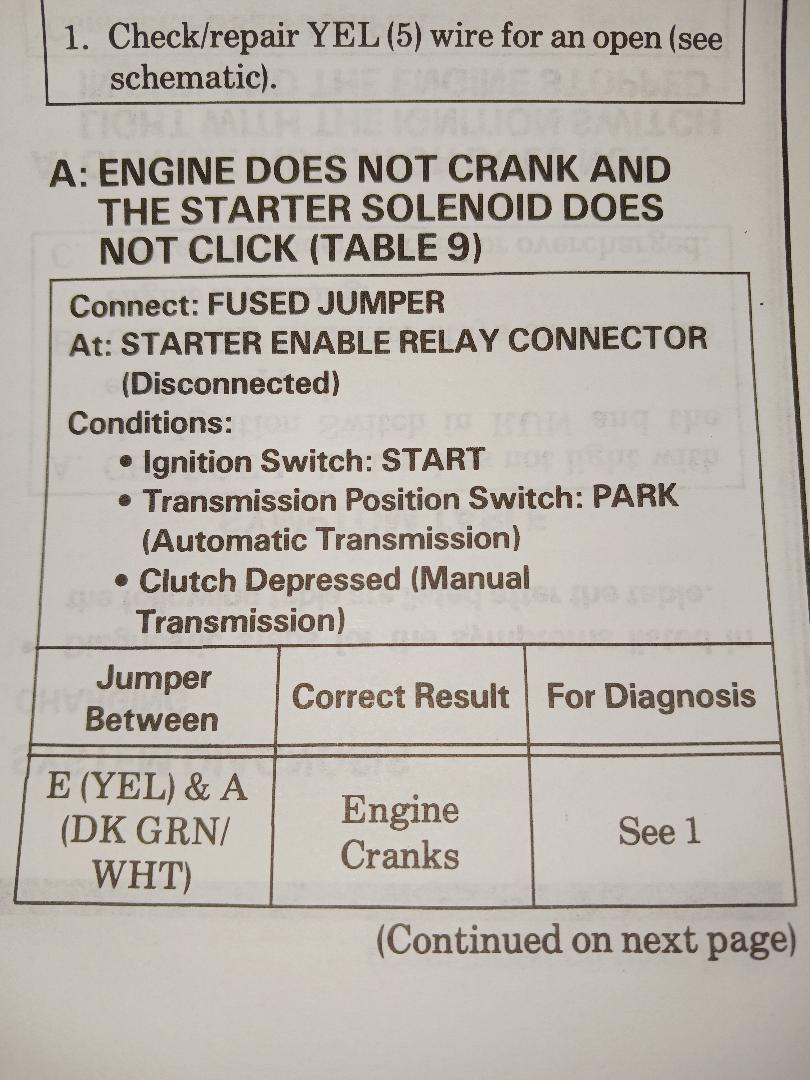

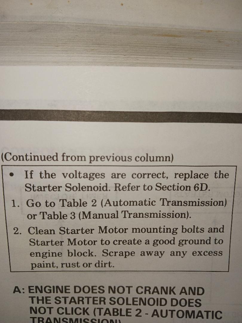

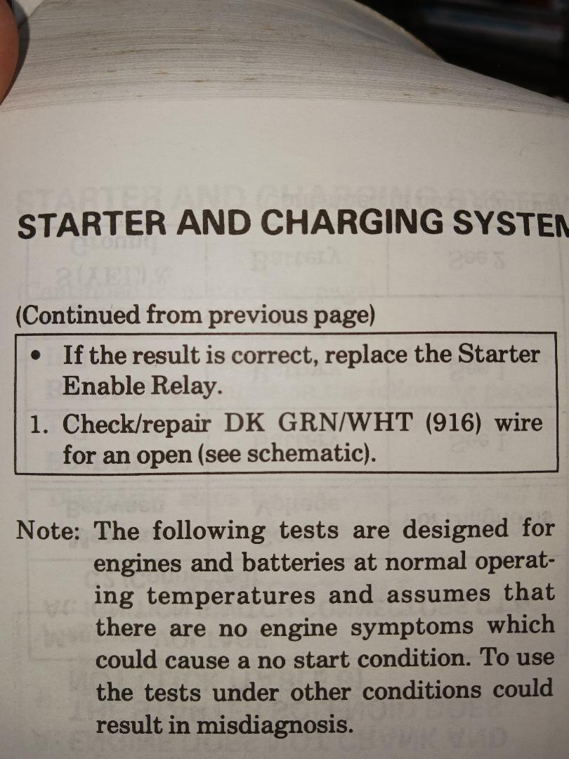

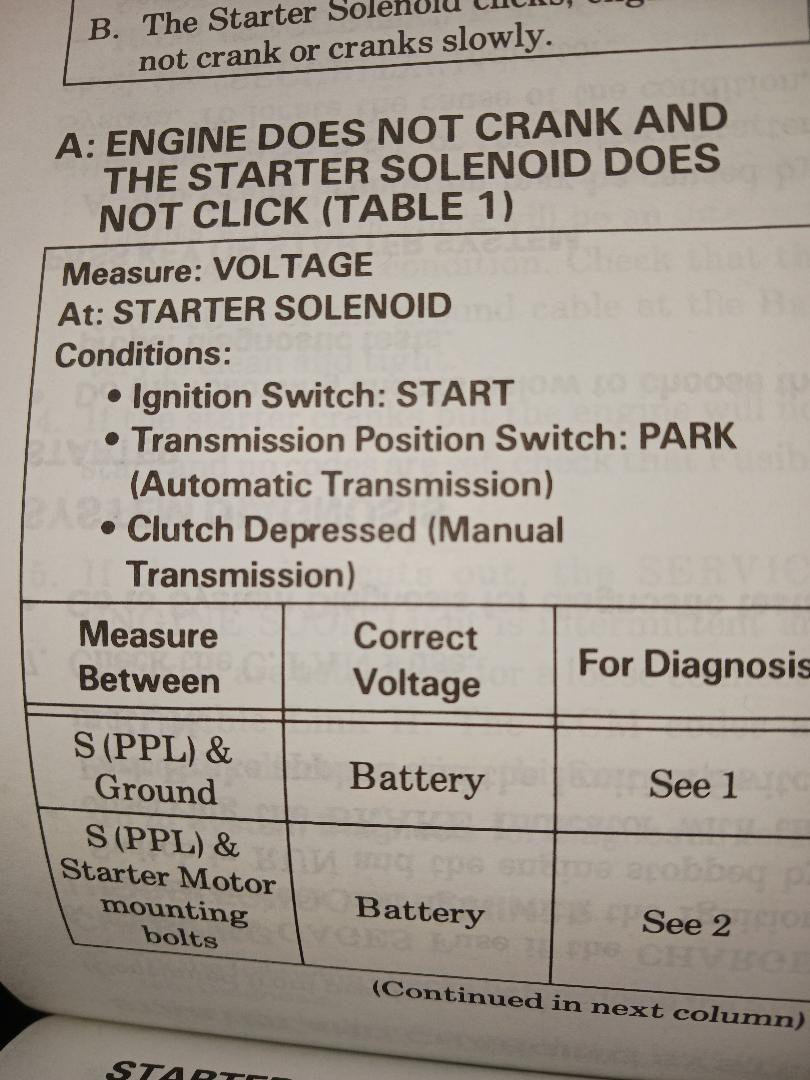

Procedure to check voltage at starter solenoid...
Hello Ted1996 can you please tell me which manual that you have pulled these procedures from? Thank you...
Old Apr 17, 2024 | 06:58 AM
Ted1996's Avatar
Ted1996
Joined: Mar 2024
Posts: 55
Likes: 16
From: Buffalo, NY
1989 GM Service Manual. I purchased an original hard copy on EB.

if you aren't getting voltage to the starter, then the starter isn't the problem.
