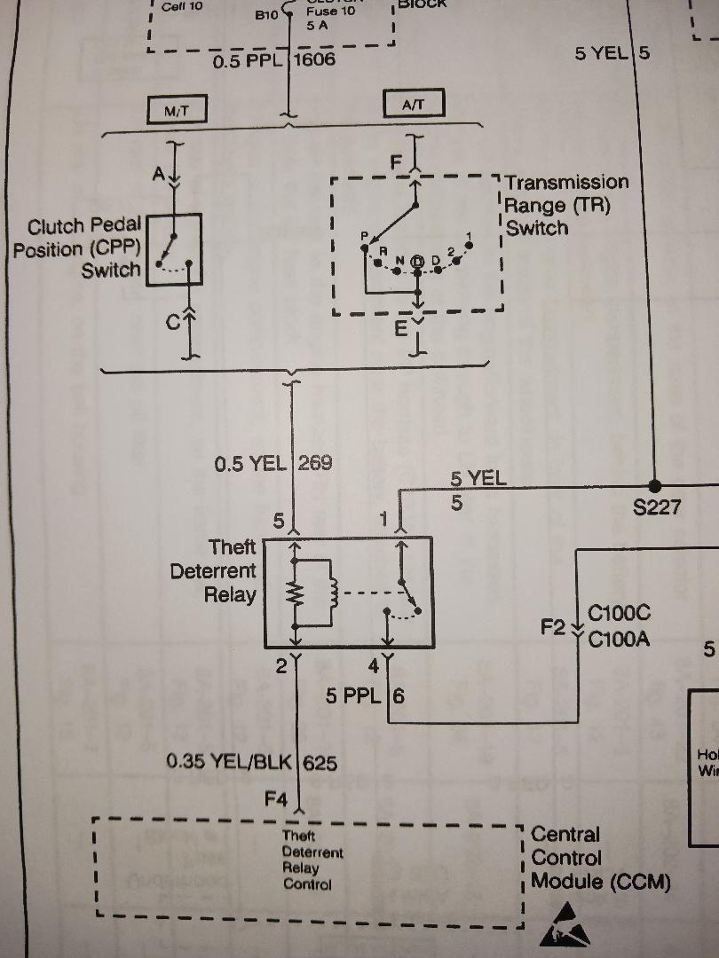

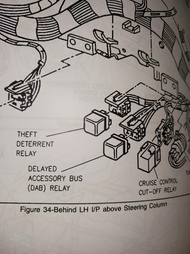

Pulled this from my 1996 Service Manual. It looks like GM changed the name of this relay to Theft Deterrent Relay. Even if you disabled VATS in the ECM, isn't this relay still in play? Others with more expertise would need to comment. My understanding of VATS is that there are 3 main areas of failure; key resistor contacts (which you bypassed), the controller (specific match to key resistance) and the relay that the controller enables. Wondering if the newer C4s eliminated the controller and is now part of the ECM.
There have been several posts over the last few months about VATS specifically in 90-96 cars. Deleting it out of the ECM does not solve 100% what the OP wants to do. The ECM and CCM do multiple communication handshakes about VATS to allow the car to start.
Which is why I asked, what is he doing about it in the CCM.
The system works. You just have to understand how it works. Understand how to diagnose, And then you can fix it.
