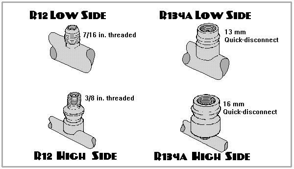

Can you physically see the difference in the hoses or anything to determine if your car is a 12r or 134a
Old Apr 18, 2024 | 04:42 PM
Joe C's Avatar
Joe C
Joined: Aug 2000
Posts: 11,470
Likes: 764
look at the high/low pressure fittings - R12 fittings look like a schrader valve tire stem, with threads on the outside. R134a fittings are slightly larger and look like an air hose quick disconnect' fitting. if your corvette's been converted from R12 to R134a, you will have adapters on both.

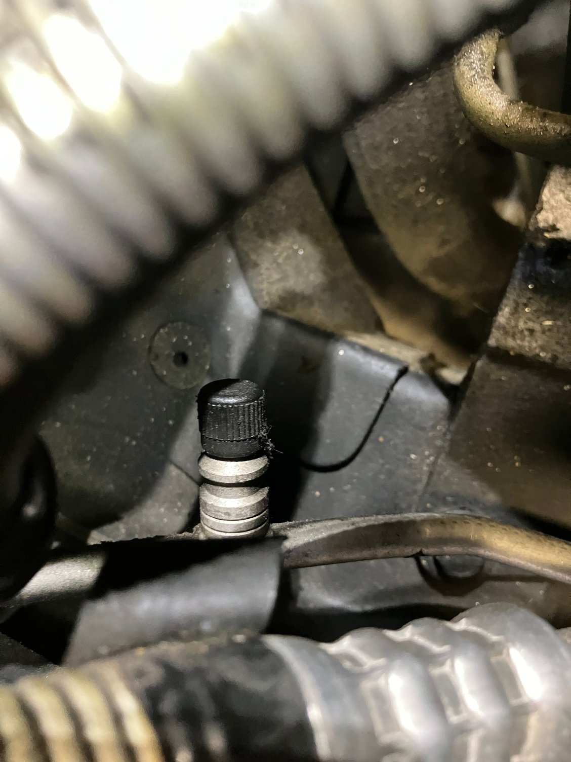

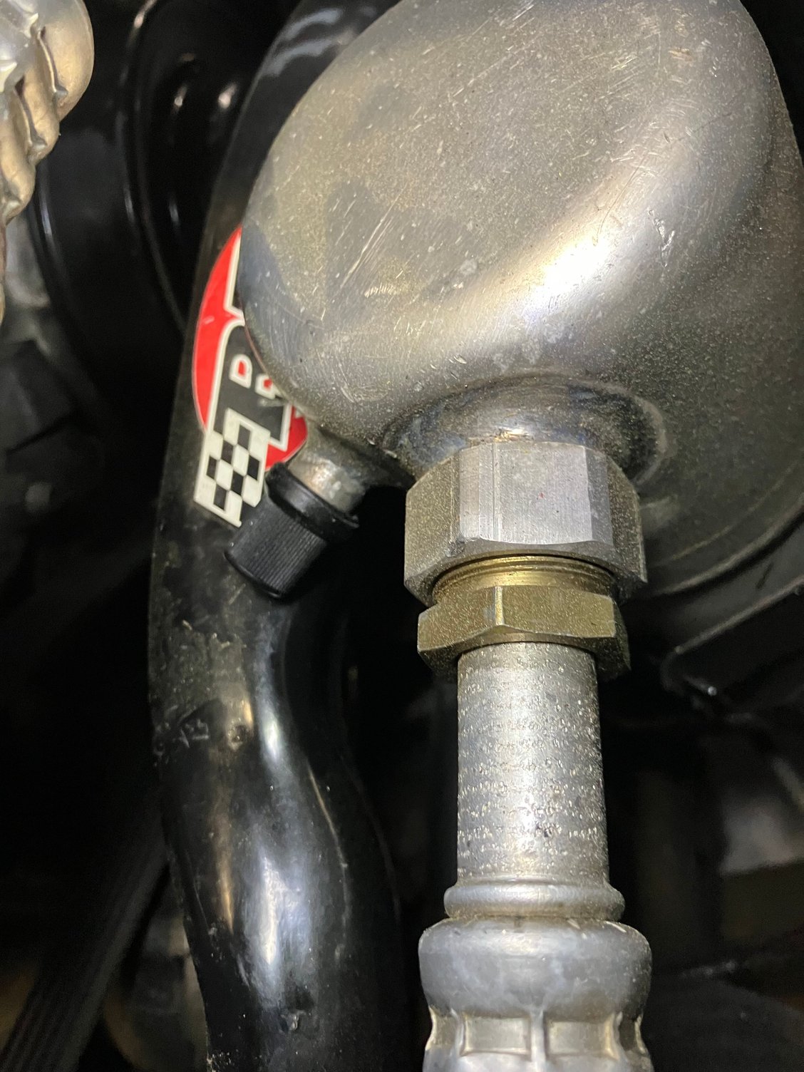

ok, I’ll take a look at it now…it’s a 1991
looks like r12
Old Apr 18, 2024 | 05:17 PM
Joe C's Avatar
Joe C
Joined: Aug 2000
Posts: 11,470
Likes: 764
looks like r12
that would be my guess....
