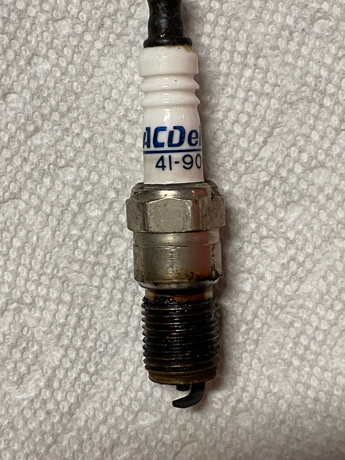

Well this is kind of fun. While waiting for the plug wires, I started replacing the spark plugs. I have no reason to believe that these are anything but stock, though I don’t know that to be true. They look pretty good for nearly 51k miles. For the purists, the gap was somewhere between 55 and 60 thou.
The General specs the gap at 50 thou. I’ve seen opinions as low as 40 thou. What says CF?
Also waiting for my service manual. I’ve found torque specs at 11 foot pounds. That isn’t very much. Again, what says CF?

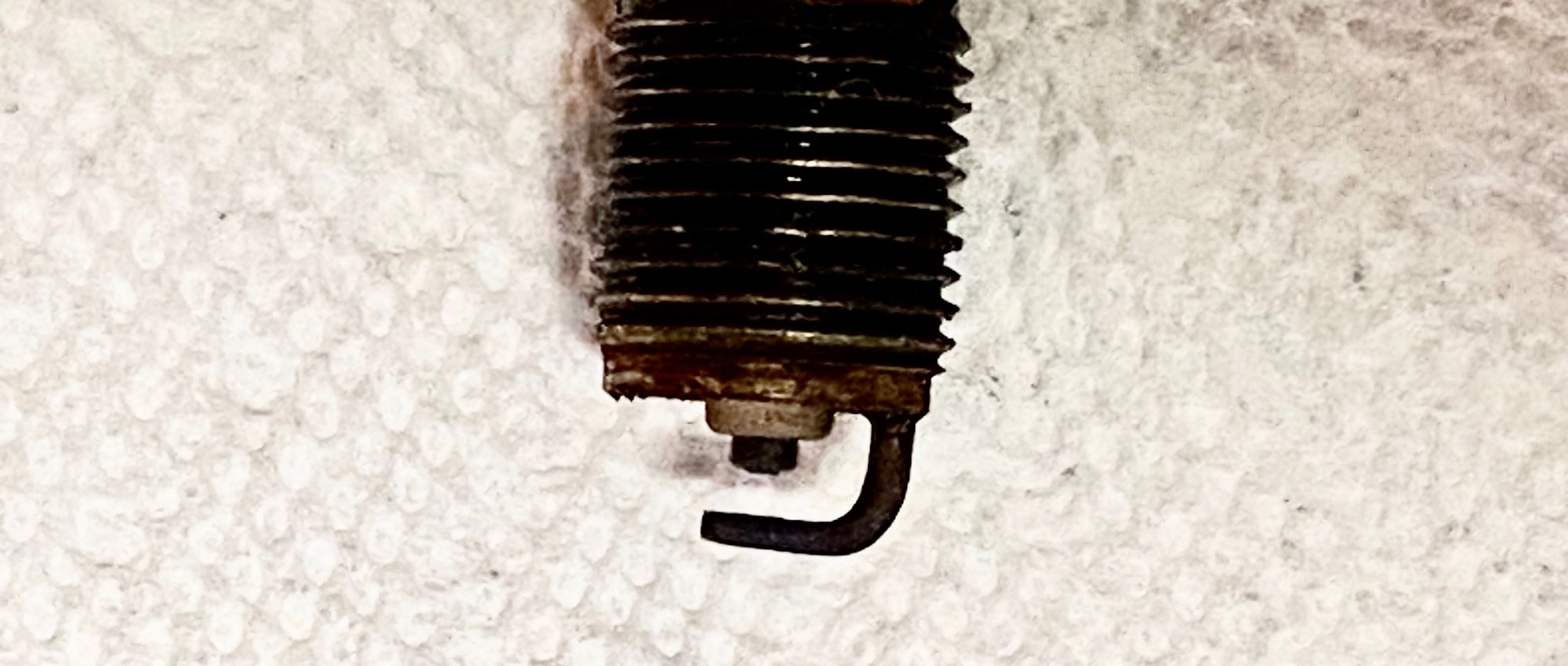

Runs very smooth and even now. The old plug from cylinder #7 showed the same color as the others but the strap looked very white. I need to keep an eye on that one to make sure that the injector isn’t acting up.
