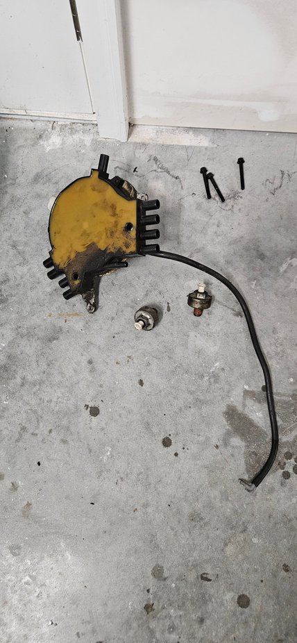

Team,
I was finally able to dislodge the damper and remove the Opti. I also removed the 2 knock sensors. The damper was not easy to slide off. I had to work it by hitting it from behind as suggested and rotating it.
As for the knock sensors, I had sprayed them with PB Blaster, and with some effort they came lose.
On the other hand, I am not able to remove the damper no matter how I tweak it. There is simply not enough space between the crank hub and the rack and pinion. Looks like I may need to loosen up the R&P in order to move it about 1/8", so I can pull the damper out. Any other ideas?

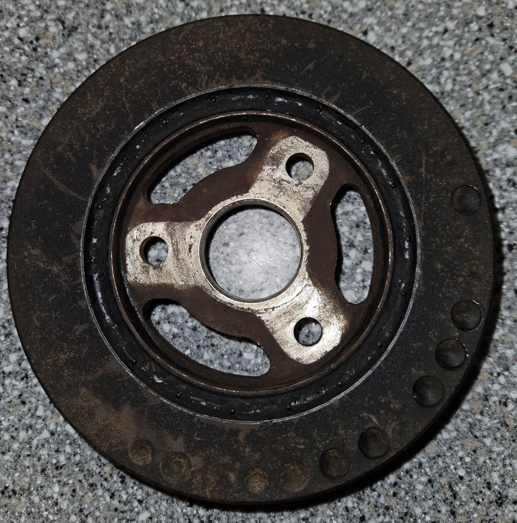

Team,
Why does my damper have so much metal removed from the backside and a weight added to the front? The pictures of replacement balancers I've seen online are nothing like this one.
Old May 3, 2024 | 01:58 PM
jmgtp's Avatar
jmgtp
Joined: Aug 2009
Posts: 1,972
Likes: 243
I can’t remember if mine was like that or not but it may be to neutral balance it, since the LT1 hub isn’t keyed.
Old May 3, 2024 | 02:36 PM
rremesal's Avatar
rremesal
Joined: Jun 2022
Posts: 845
Likes: 212
From: Florida
I just sent it to Damper Doctor for rebuild. If you look closely at the rubber, it is cracked all along it's diameter. The box weighed 10.7 lbs, so the damper itself must be about 10.
