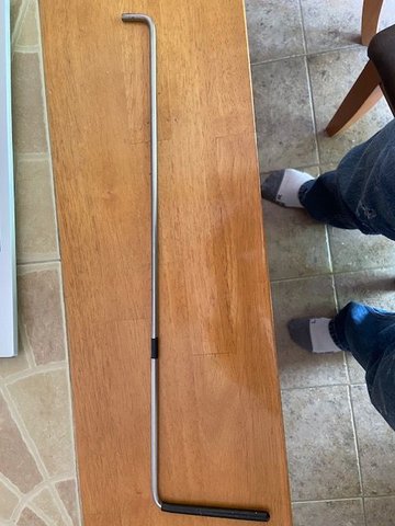

Here's the one I made. Still trying to get a helper to try the push thing. Does it make sense to put penetrating lube in there? How about hit it with a pressure washer?

That tool looks like it should work. You open the door, slide the tool in at the upper edge under the windshield about 12 1/2 inches with the end facing slightly outward. Once you get it into the latch area you need to rotate the handle outward. The latch releases by moving inward. I think if you watch the youtube video, it will be more apparent of how it works.

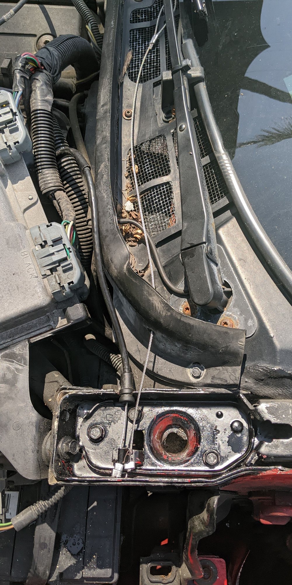

The area below the latch was flooded, and the tiny (1/8" ?) drain was clogged (stupid design). Of course that rusted everything, locked it up and then lengthened my cable. I cleaned and greased everything and it all is good except the length of that cable. Looks to be a clusterfuck to replace. What is this electronic thing in the way with big cooling fins? I need to minimize how much of a PITA this job is, as it is getting out of hand and I only have a driveway with 105* heat to work in right now. How do I shorten this cable? Could I just tie a knot in it and put it back? Some sort of crimp?

I decided to cut the old stop off the cable that needed to be shortened, and added two 1/16" stops from home depot. They seem to hold fine. Problem is I should have put it about 1/8" closer, as it isn't quite enough to open it. Is there any adjustment on these cables under the dash side? There is none under the hood on mine.
