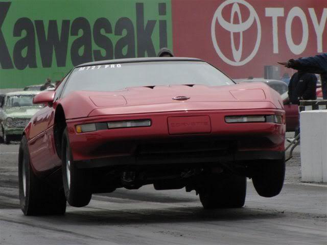

What size headers? Are the equal length headers harder to fit in the tight confines of a C4 tunnel and engine bay? Thanks... what a dream photo... rotating the front wheels, what are those 60 foot times like? thanks...

Thanks. I am using ARH stepped headers; 1 3/4" to 1 7/8". I compared them to Hooker 2151 which are 1 3/4". The TPIS headers are the easiest to drop in because they aren't equal length the primaries take up less space. For a street car it shouldn't matter. Not sure if they are still making the headers though. My 60' are around 1.38. Best has been 1.34.

What rear end is in your wheel puller? Solid Diff... ? what ratio? 4.10:1
