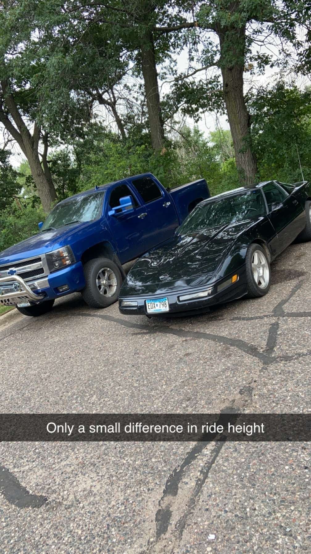

Thank you, that was a very well written response. That helps a lot. A buff and polish is on my list of things to do yet. Paint isn’t awful but could be better. Wheels aren’t stock 91 vette wheels either which some say is a bad thing but whatever I think they look nice. I should note, not all of the work was done by me, like the wheels. Trucks mine too thanks for the help
