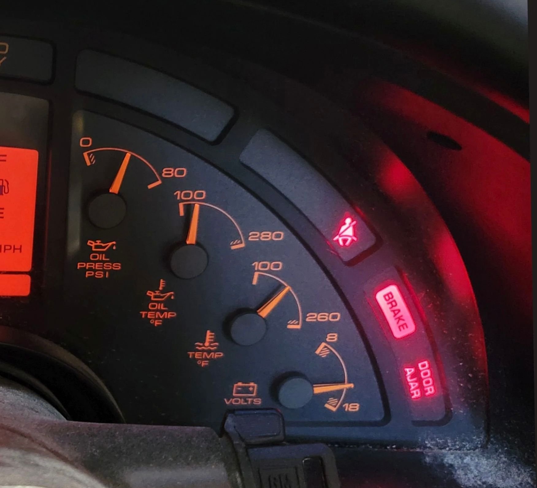

Hi all. I have a 1990 Corvette. Intermittently while driving, the red “BRAKE” light appears on the dash and then will go away. Sometimes on for a few minutes. Sometimes not on at all.
I’ve tried researching it but am getting super mixed answers. Anyone know what this truly means? My owners manual doesn’t even really explain it.

I don’t believe I have 2 brake warning light… Let me see if I can attach a pic

Check the fluid level in the master cylinder. Probably low, before you just top it off and call it good check the brake pads. The fluid moves to the calipers as the brakes wear and returns to the master cylinder when the pads are replaced.

Fluid level is great (little dirty but good level). Pads are super thick.

double check wire from master cylinder to make sure it hasn’t rubbed through somewhere and touching ground, also, try wiggling the parking brake when the light comes on to see if it affects it. If so, parking brake switch is the villain.

also, did you look inside the master cylinder or just look at the outside of the reservoir. Sometimes the reservoir is stained and it looks full when it is actually low. This has bit me in the butt in the past 😉

Put a light on MC and check level.
