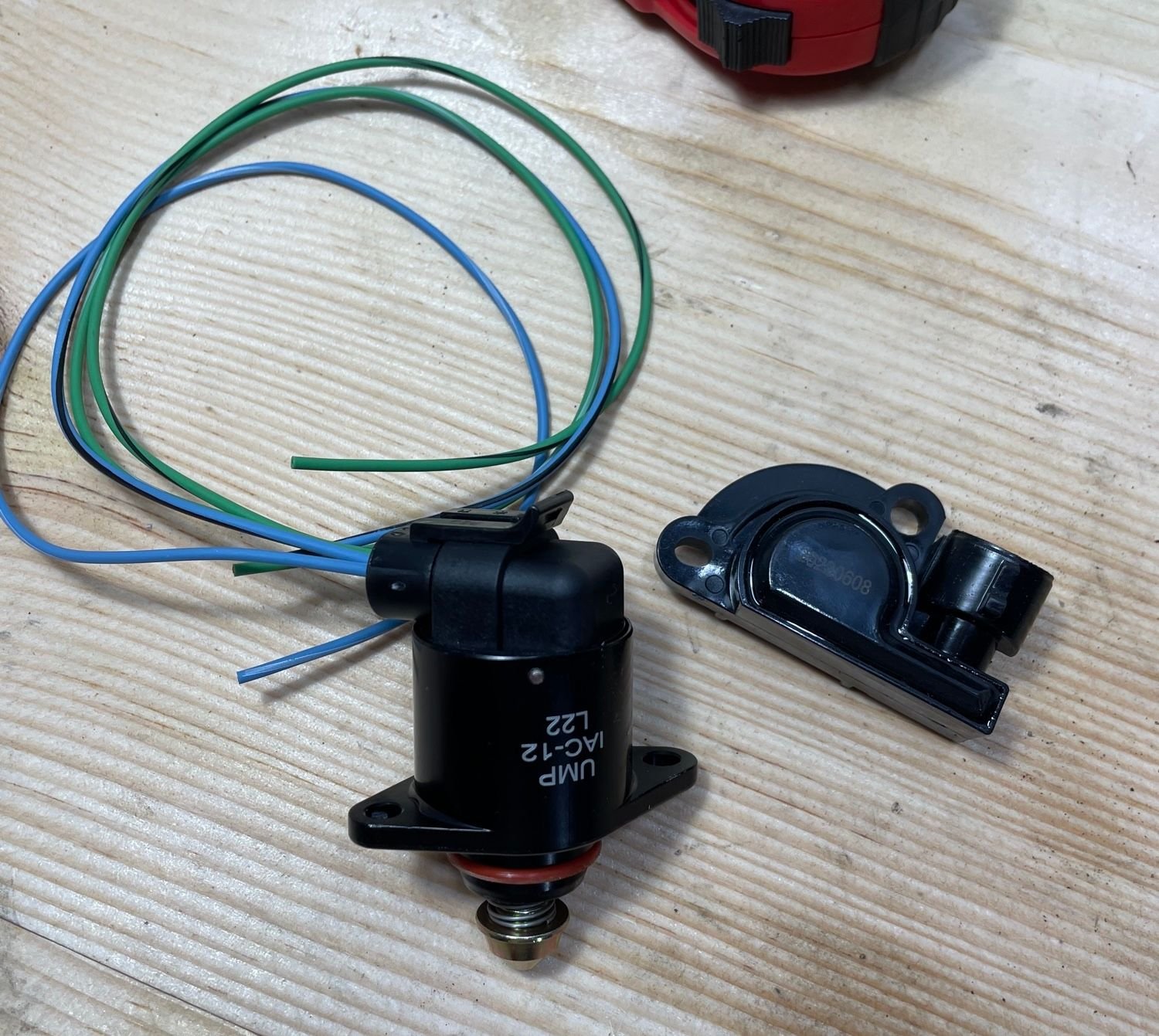

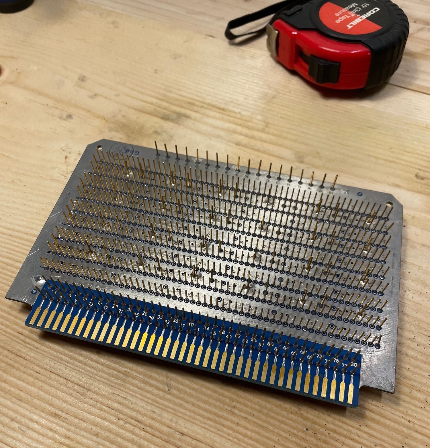

Just to keep the thread updated. I'm slowly preparing for the custom ECU and high HP out of stock TBI with minimal efforts ($, not time).
I've bought 2" TBI from 454 engine for $70, rebuild kit for $50, TPS and IAC for about $70 and OG board with card edge for about $30 to build my custom ECU setup.
The bores are actually huge
It has the card edge that must fit the stock ECU harness connectors (just need to cut the gaps)
The TBI injectors are low Z. If you connect them directly, they consume too much power. I connected my PSU 12V 5A, and they consumed 40W at 7V (PSU can't give more). They definitely need to have some driver. I ordered LM1949 and necessary aux elements from Aliexpress, going to build a pick&hold drivers for those.
I have rusEFI installed on the STM32F407 discovery board. Going to go that way, using the given breadboard, and pre-built PCBs (like 3.3v to 5v adjusters). Will test everything before I'll build own PCB.
I bought Performer dual plane Intake 2101. I didn't take RPM because I don't expect higher RPM (need to change springs, internals etc), so I target torque on lows.
I see that people sell 3D printed adapters on ebay, so I'm going to 3D print my custom adapter using composite material ($45 per kg). One of the requirements is to keep the stock air filter, CFI cover and stock hood. I don't know how height gap I'll have, but with 3D printer I can make the correspondent spacer. Once I took off the stock CFI and manifold, I'll know the height difference
