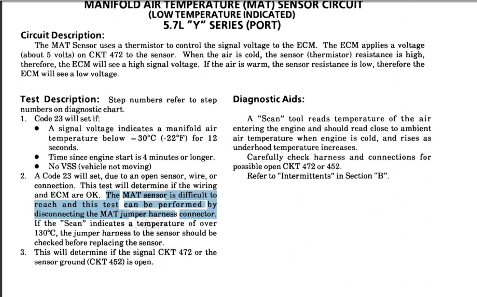

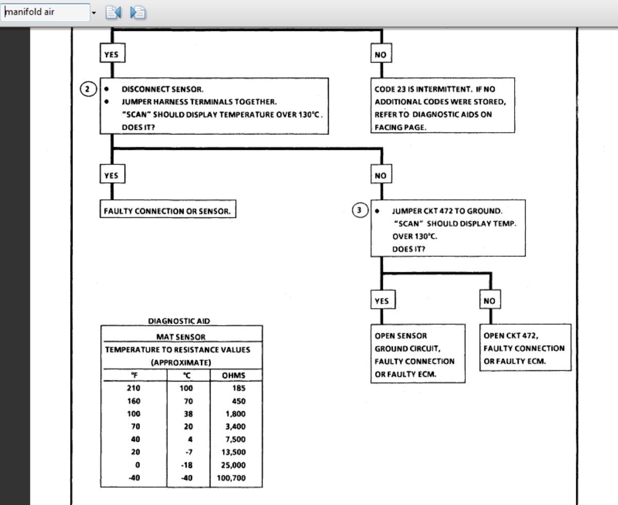

Not so simple. The MAT is not internally scaled in $32 and $32B. Here's a chart I made in order to scale the MAT for $32 and $32B. This could be added to an appropriate scan tool as a lookup table.
My Chart is based upon this:
I assumed that the output is really T+40.

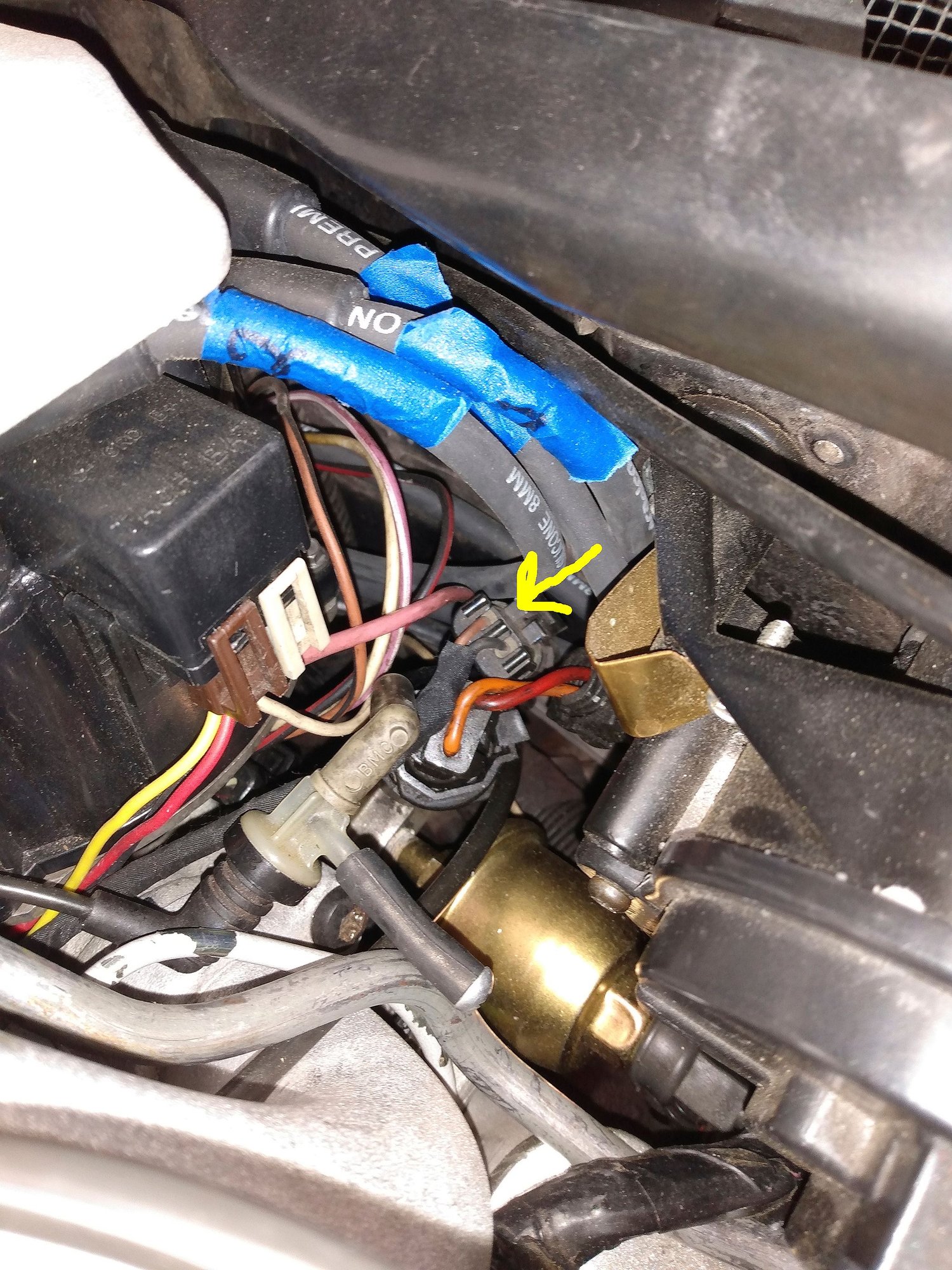

According to the FSM there should be a connector behind the distributor.
Old May 28, 2024 | 03:57 PM
Vets-Vet's Avatar
Vets-Vet
Joined: Jul 2022
Posts: 1,805
Likes: 365
From: Central Florida
I believe it is the black and brown wire on my 87.
