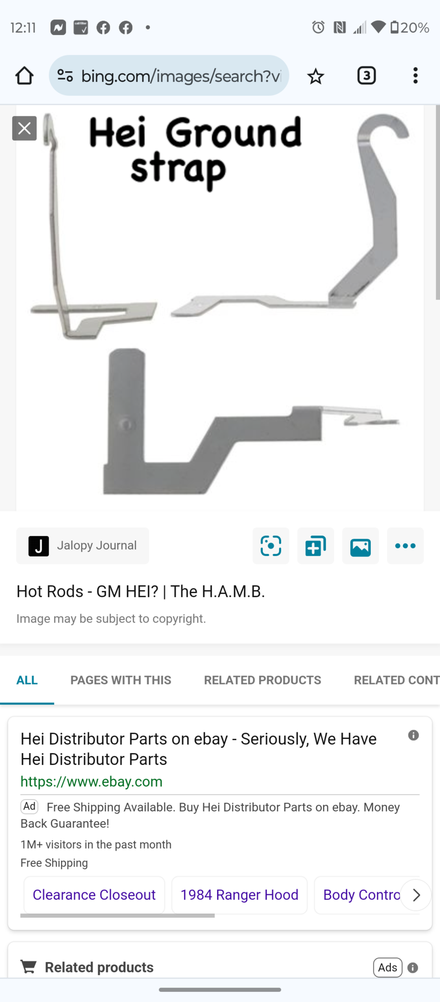

Have blown a couple of coils, also if you put a new cap on Did you bring over the Ground Bridge(stamped tin piece)to new cap
i am not to sure what part you are talking about is it the metal hold down bracket thing?

Old May 31, 2024 | 12:31 AM

Originally Posted by s carter
i didn’t put that because my last coil didn’t have it. could that be the reason?
I can't remember a top mount HEI not having one and one of my mechanics in training forgot it and the car didn't run and if it did it didn't move
If I remember correctly it should be under coil and going to the plug out area, it only goes in 1 way so if it fits it good
