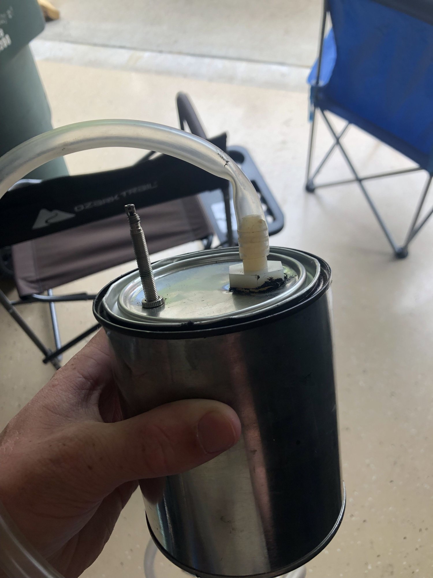

I have an L98 and as such can't help with leak location, but I can help with performing the test itself.
I made a smoke machine with a small paint can from lowes. I put a bicycle tire valve through the lid, as well as a fitting that connected to 3/4 inch hose that I put on my EGR port in the intake manifold. I used mineral oil to make thick white smoke and a bike pump to pump it into my engine. It worked very well and cost basically nothing.

Not sure if I can make a video but I can post some pictures. You'll need paper towels or some other fuel to actually burn and heat up the oil. Light it and let it burn for maybe 30 seconds or so. You'll see the white smoke forming in the can. It sinks and won't escape even with the lid off. When you put the lid on it will douse the fire so make sure you have a good amount of smoke built up before doing so. Also I usually connect the pump before I put the lid on because it gets very hot very quickly. It's hard to get the pump on the valve without burning yourself otherwise.
Flannel_Man is right about the smell. I don't mind it too much but its not exactly pleasant. I recommend doing this outside where the smoke won't blow in your house/garage.
