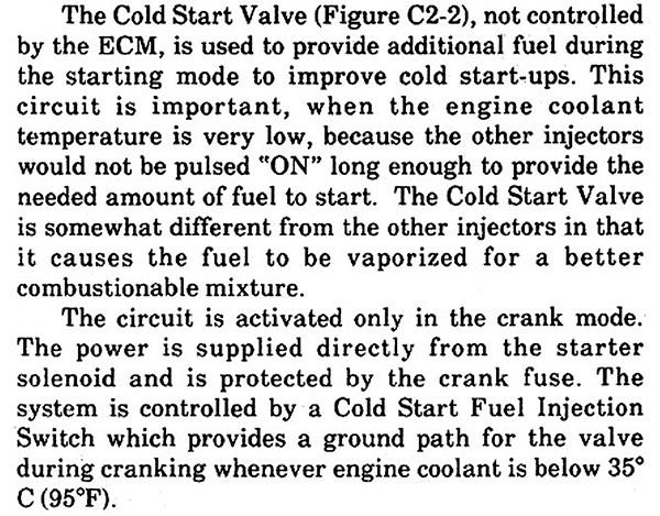

It apparently controls the activation of the 9th (cold start) injector.(shop manual 8A20-7 has a circuit diagram). Shop manual at 6E3-C2-1 provides an explanation & refers to a Cold Start Fuel Injection Switch, which I think is one and the same thing, from what I can gather. By detecting water temp the switch can open the circuit to the cold start injector at various coolant temperatures.

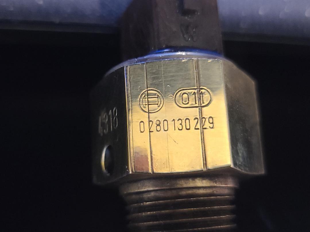

P/N 14084318, it is also a timer, the colder the coolant temp the longer it is on. This is a hard find, I see no new cold start switches made or anything close to it.
Corvette parts yard is your best bet.
I can't vouch for these numbers but the third gen chevy and the fiero folks used it.
More Information for ACDELCO 212312{Alternate Inventory Numbers: 14084318, 19244930

Thanks to Vets-Vet with a few leads on the part numbers - I've researched Delco 212312, GM 14084318 & 19244930 and from what I can see the part was discontinued way back in 2010 so I guess the only option is to block the hole. Presume the the cold start injector will be inoperative. I wonder about fault codes.

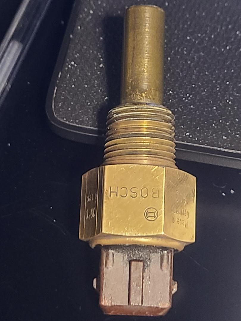

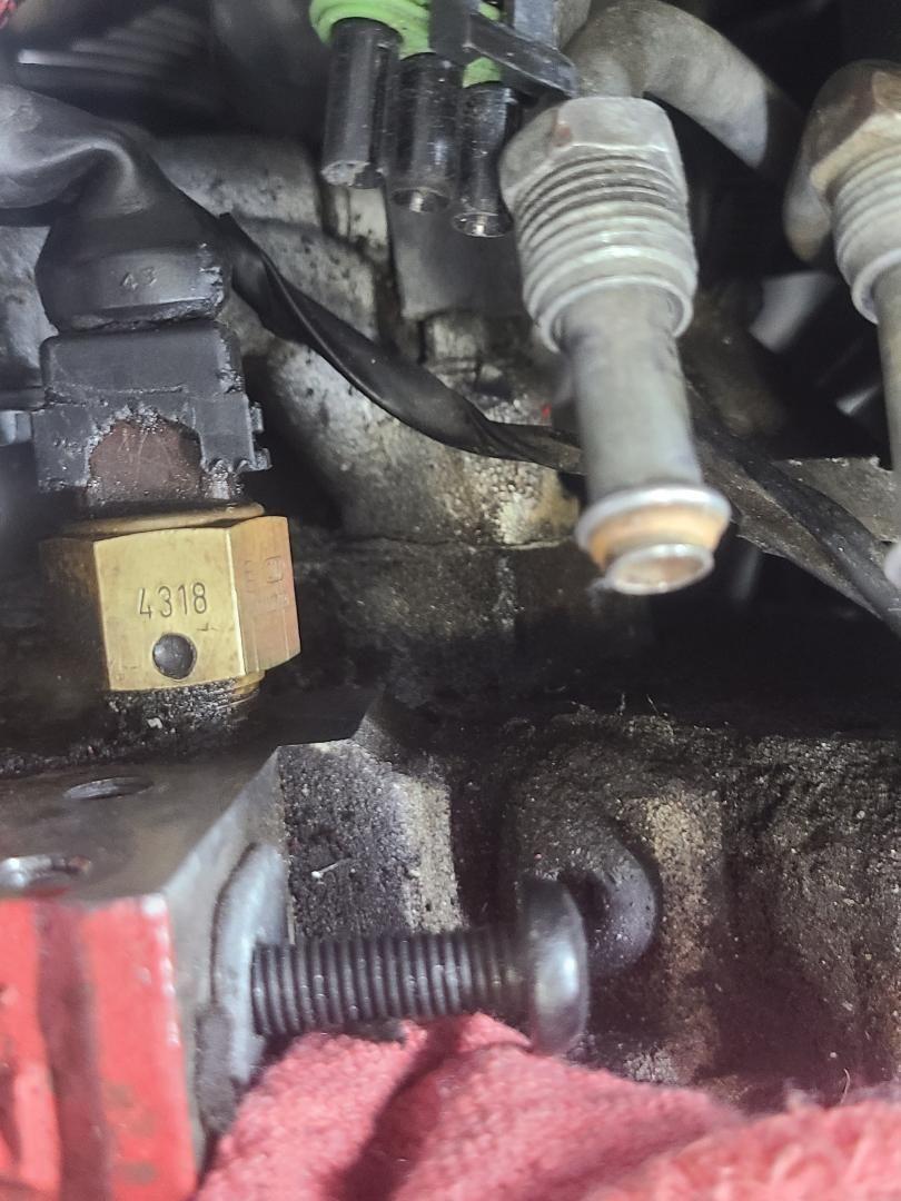

This is what I have in my 86. I'm not sure if I need one also. I can't find one. I have the motor apart and figure I may as well replace it. My car is running very rich and from what I have read, it sounds like I need this. Anyone know where I can get one?

""My car is running very rich and from what I have read, it sounds like I need this""
If it were to somehow stay on maybe, but I doubt that is it. Your connector looks bad though. Unplug it and see what happens. Right next to it in the front of the intake manifold is the more likely suspect engine coolant temp sensor. The cold start valve only opens for a maximum of 8 seconds.

Keep in mind that the CSI circuit is ONLY energized during cranking and also take into the account of the temperature limitations <95dF. If I understand that correctly, you can only get the 8 seconds max of enrichment from the CSI if and only if you're hanging on to the ignition in crank for >8 seconds below the temp threshold. Inadvertently on? Highly unlikely but leaking all the time maybe.
