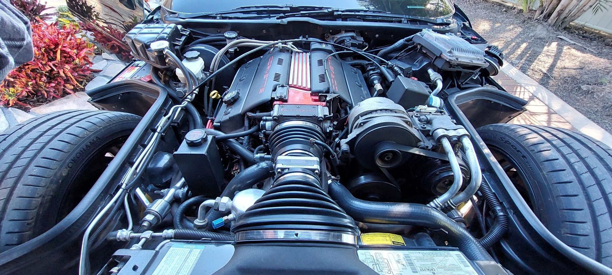

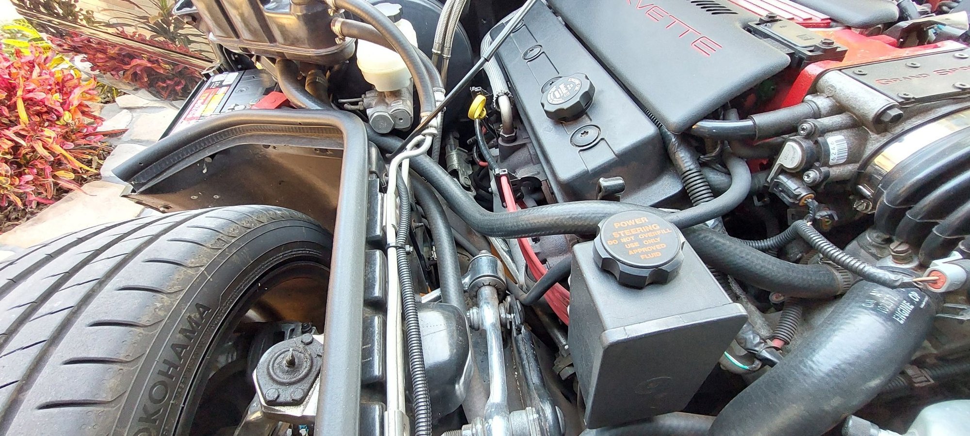

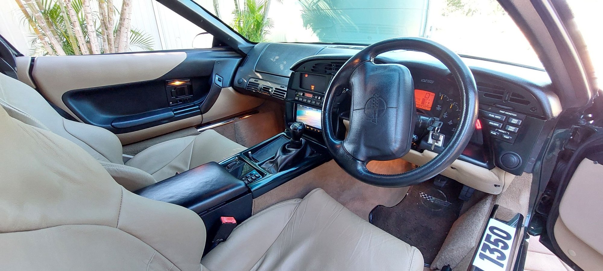

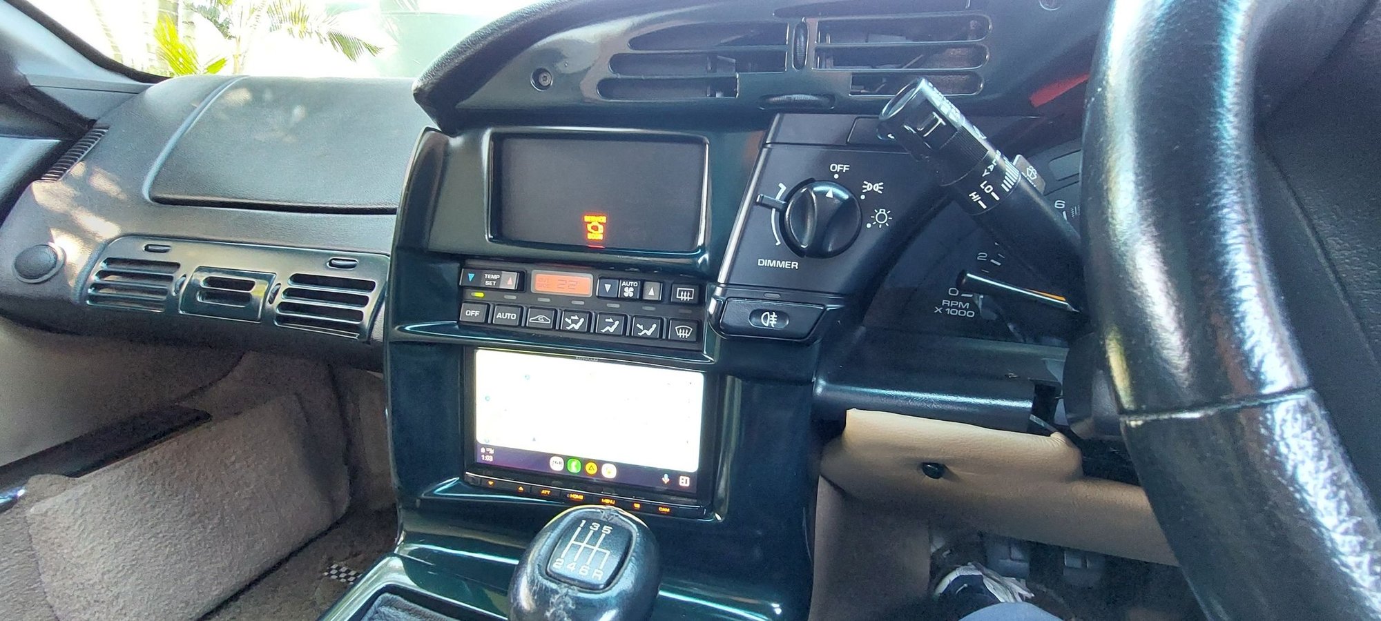

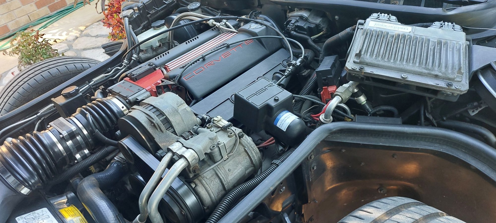

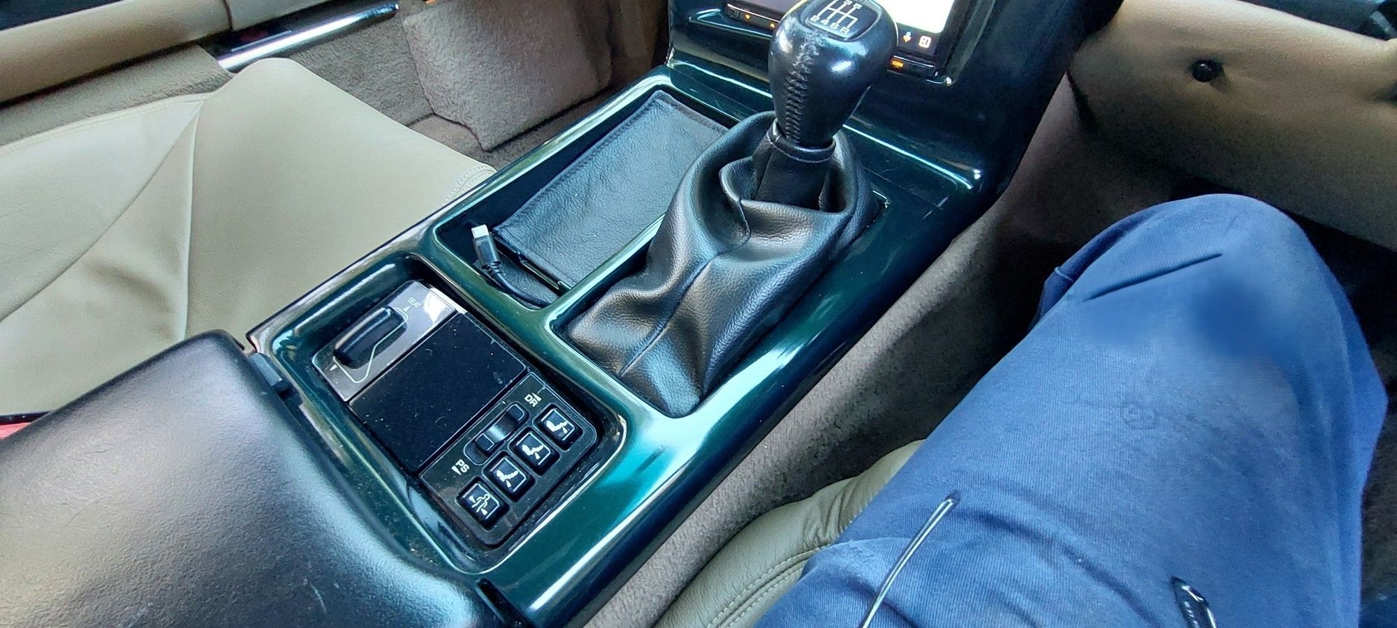

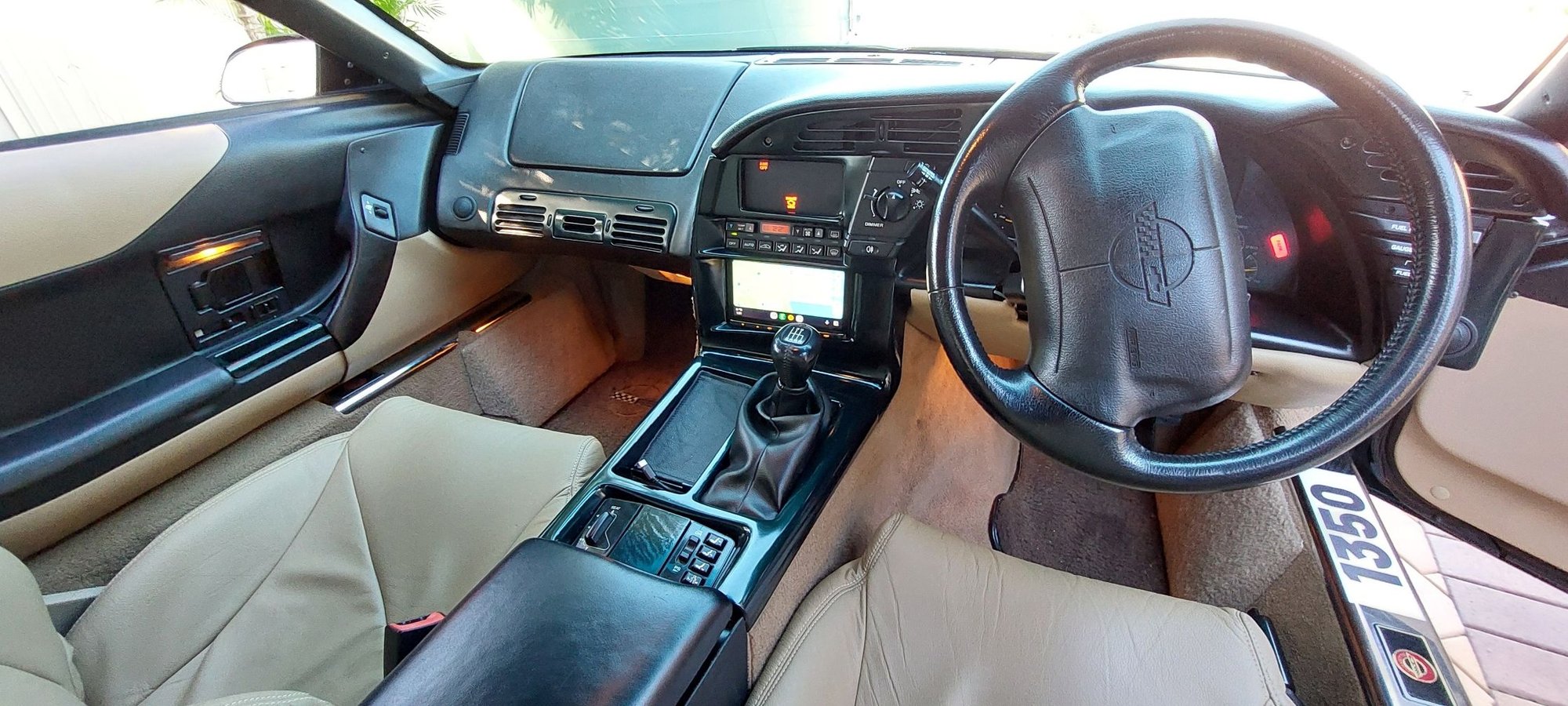

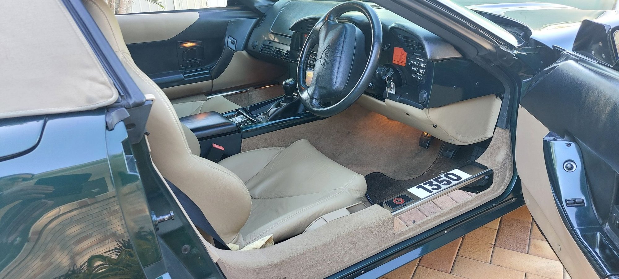

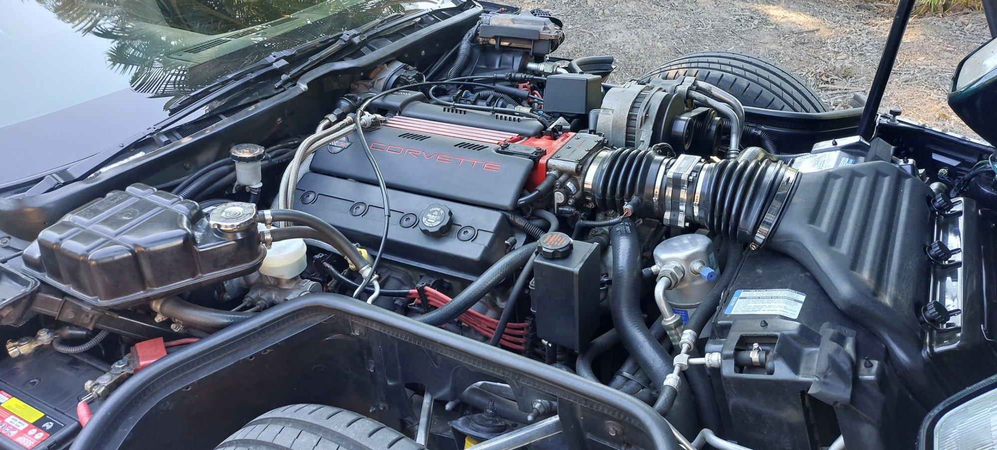

I just took the girl out to get some go-go juice, to get ready for this week's run with the club.......so I took some pictures for you Max.
Front view
Left hand side view
Left had side view
Right hand side view
Close-up right side
RHD

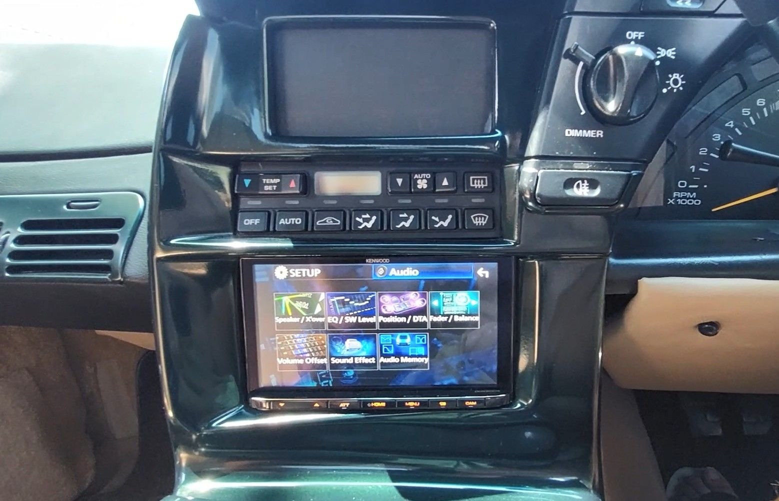

Trick paint and custom console with mobile & charger port. (Deleted useless cup-holders)
New headunit with trick painted dash surround.
Sunday seaside cruise session.
This is (IMO) probably a prime example of a RHD, 1996 LT4 convertible, now that I've fully gone over her with a fine toothcomb.
The interior is pretty close to being identical but in reverse and with a few updates & tweaks by myself like -
I replaced the whole stereo system with all new up-to-date stuff with 3 cameras.
Tweeters in the dash that look like they belong there. Can you spot them?
As I'm an automotive painter, most of the dash surrounds like the headunit, all the vents and both inside door handles have been painted in the same Polo Met Green paint as the car, but I've tricked them up so they look black to the eye but change when the sun shines on them. I reckon it looks pretty cool.
The console is also painted & I custom it by deleting those useless cup-holders & making it into a more usable space that now holds my mobile phone and it even has its own rechargeable port.
I also chopped out the old coin holder (under the console lid) & custom it into another USB-port.
Anyway, enough of my dribble. Here are the pictures ;-)

Thanks for indulging my curiosity in the RHD conversions. Yours looks very well done and the personal touches you've done are very tasteful. It's a beautiful car. It's mind blowing to me the amount of work that must have been done to do all that. Was this conversion done a long time ago when the car was fairly new, or more recently?
Btw, have you made any progress on the steering wheel controls?

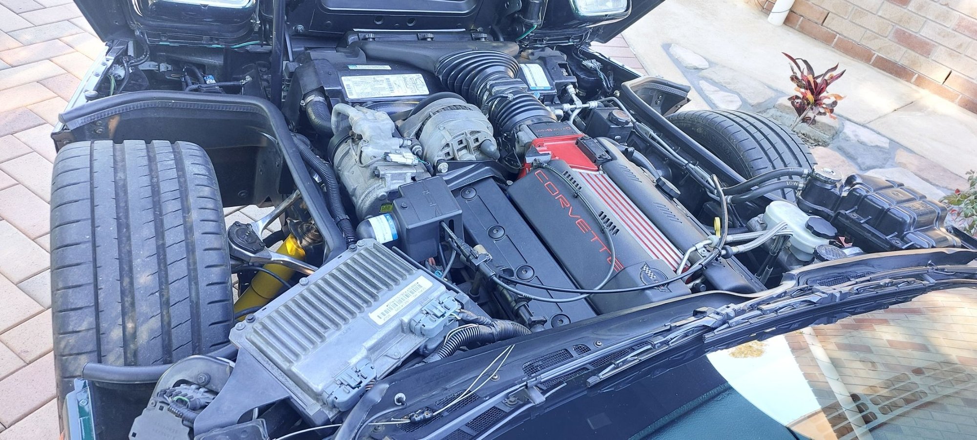

That conversion it pretty cool. And I thought the number 6,8 spark plugs were a pain before, ouch.

Yes, Yonker.

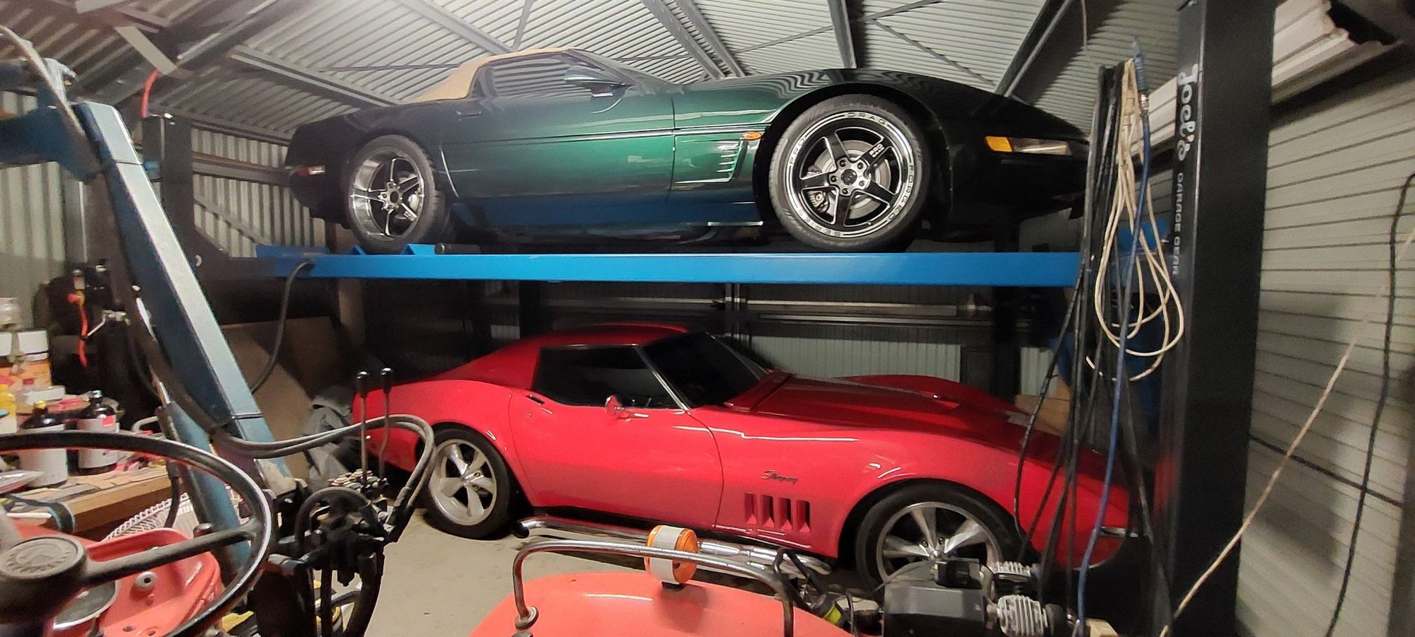

This is my first Vet after owning Aussie classic cars most of my life & I've quickly found that if you need to take something apart on these C4s, you need to take 2 other things off before you can achieve that objective.
The joys of owning such a beautiful sports car.....but it's worth it.
That's why I brought a hoist when I replaced the clutch early last year. Since no interest was shown by mechanical shops in my coastal town of Australia, I figured the labour costs to complete such a change-over would pay for half of the hoist, so why not eh. Best thing I ever did too.
And now I have another parking space for when my Corvette friends come to visit ;-)

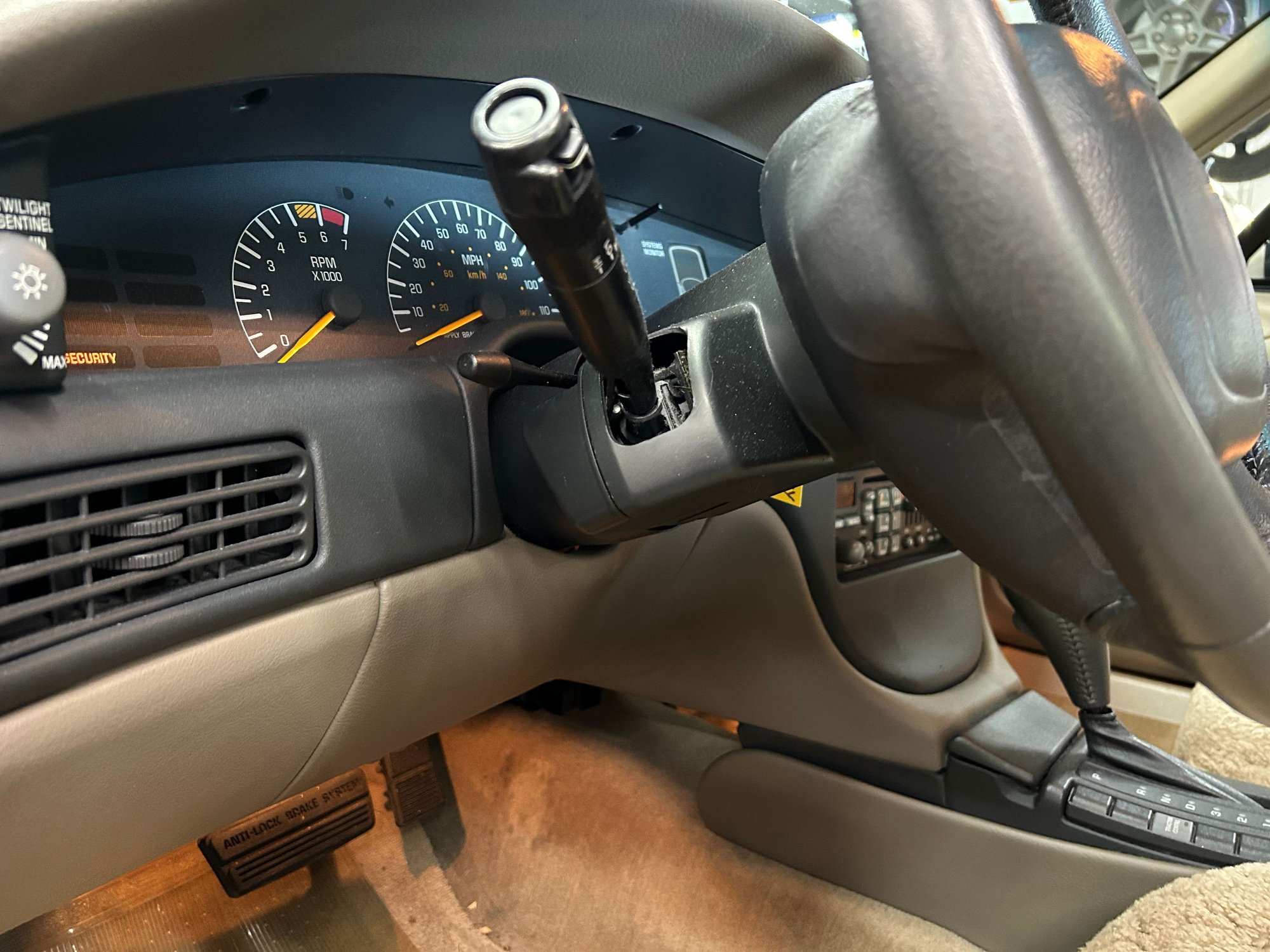

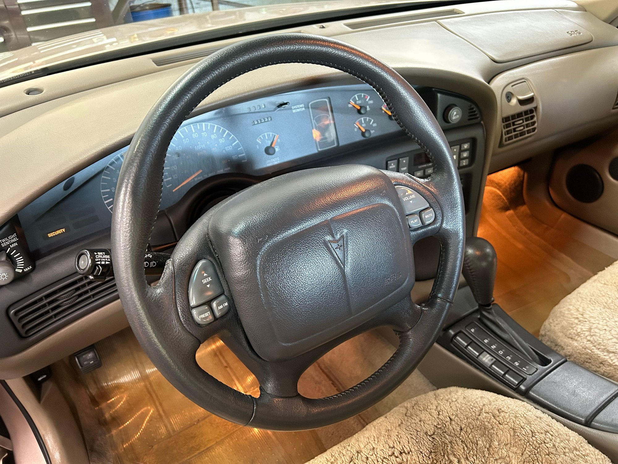

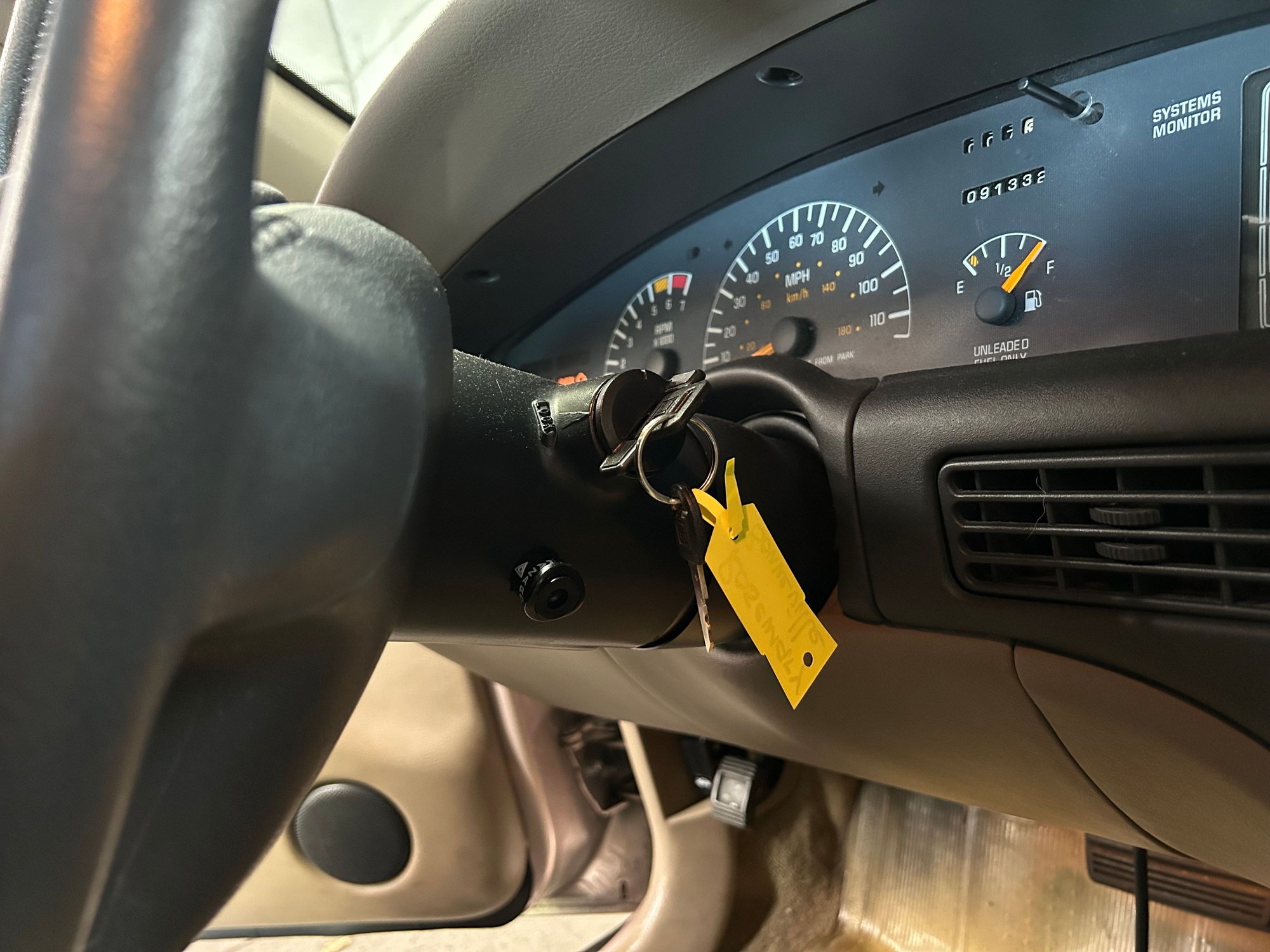

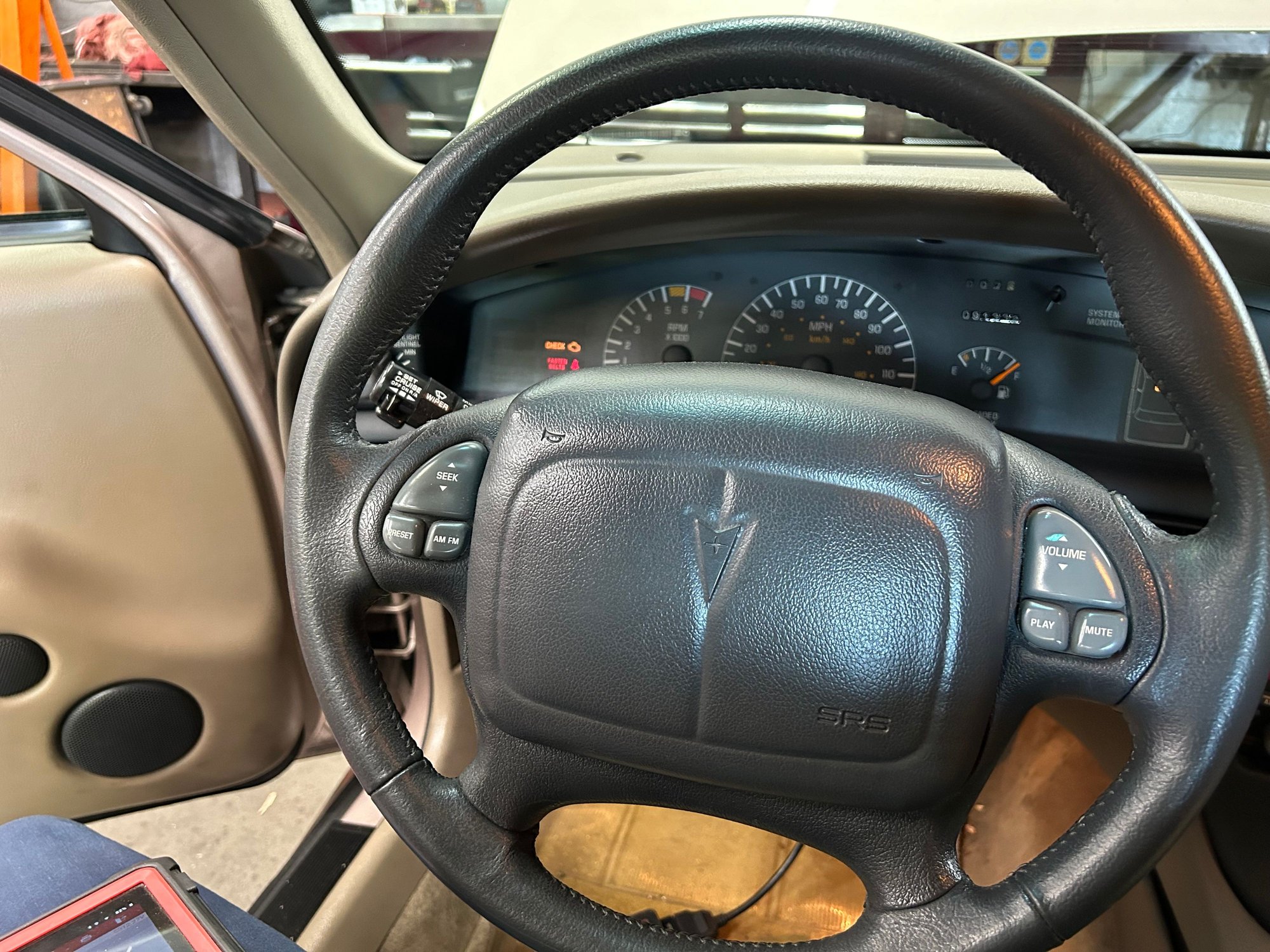

It just so happened I had a 99 Pontiac Bonneville come into the shop today that appears to use our steering column design. I took some pictures. Like I suggested earlier, use the clock spring out of a car like this and its steering wheel, and all you'd need to do is run the additional wires up the column to the new clock spring. I see someone already posted a Camaro wheel. That's an excellent option too as I think they use the same column design. Of course neither of these cars are common place where you live, but maybe Holden used the same column in some of their cars of the era.

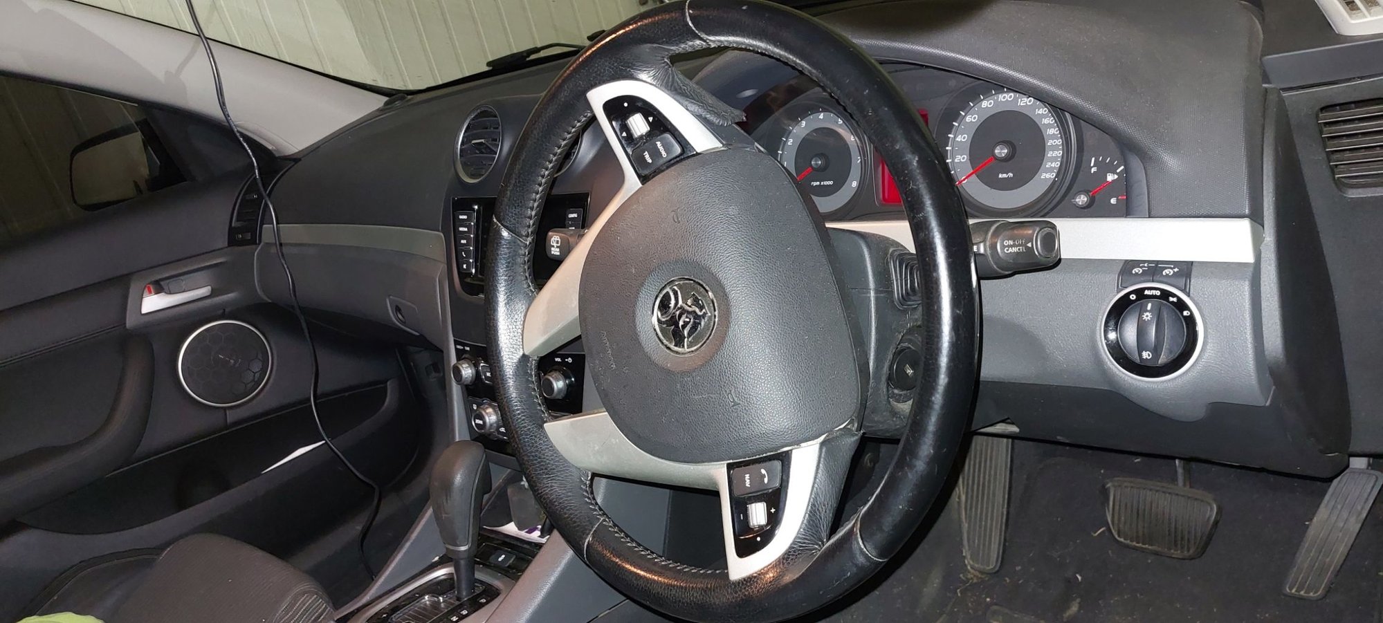

Thanks Max. Those pictures will be handy for future reference and yes, that steering column does look similar. The wheel also looks similar to the 91-93 C4s.
I thought about the Steering Wheels on the GM Holden's in Australia. That's where this idea came from.
The earliest Steering Wheel that had buttons on it was the 2006 VE Commodore.
I have the last of that model sitting in my garage, which I brought new back in 2013, so you never know. But if it did happen to fit, the airbag would need further investigation.
I'll post a picture of the 2006 wheel followed by my 2013. They both look the same in design bar the colours.

Yeah, that Holden is using GMs later column design making it much less likely there'd be any compatibility.
