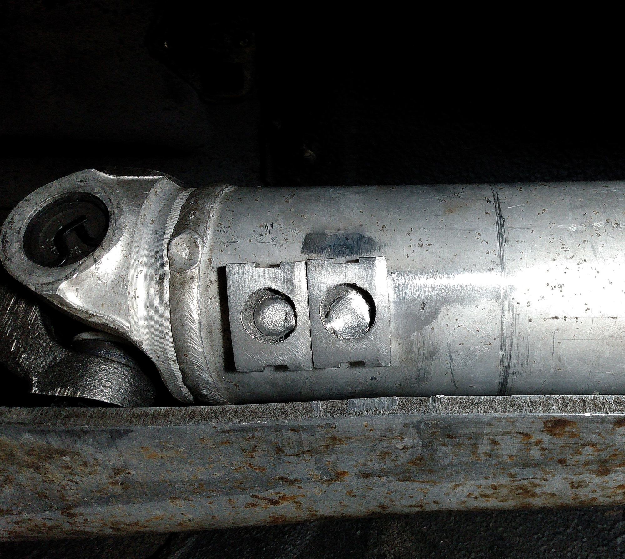

I mentioned driveshaft because I picked mine up from being balanced this past Friday and it was $80. I put a new yoke on it several months ago and new universals a year and a half ago. I had the original big a** weight on the yoke and thought it might need a "small" change to the weights / balance...... (see pic)

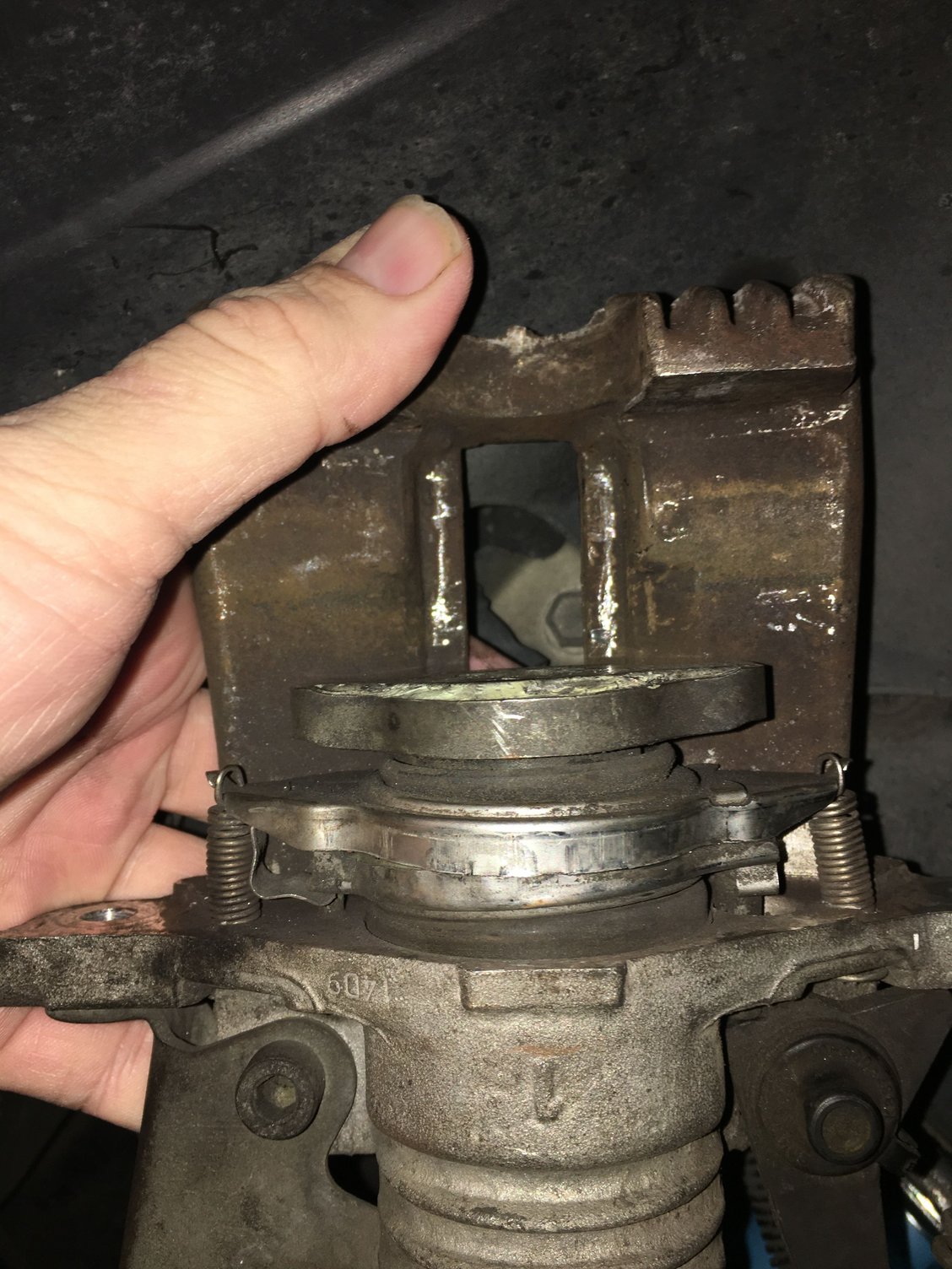

Found another anomaly doing the rear brakes. The left rear caliper is working properly, piston travels nicely, slide pins free, rubber hose okay, all is good...so I thought.
I went to replace the rear brakes (just because I’ve done everything else back there so why not) and noticed I could not get the left side to compress all the way to get the new pads on. Turns out, the person before me messed up the plate that goes under the piston, mechanically keeping it from going all the way down. There are two tabs that have to go through the top plate but are bent under the plate. In operation, the wheel is not stuck and does not get too hot. And I would never have noticed it but for replacing the rear brakes. This is something that could not possibly have happened on its own, and almost assuredly didn’t come from the factory that way. So, it had to be a Bubba. I took it all apart and fixed the problem, and the new brakes went on flawlessly. Now... I haven’t driven it yet (this was last night) but WTF are the chances that this little cheap piece of bent *** tin would be the cause of my madness and thousands of dollars, buckets of sweat, blood, and tears... Anyway, here is the picture, notice the left side and how it is crooked.

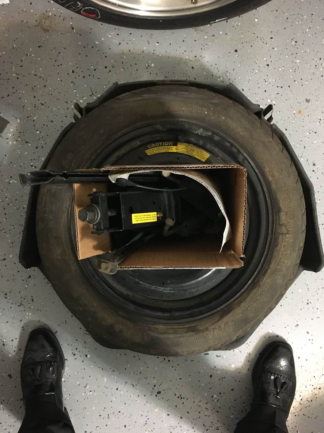

On a side note, I took off the spare tire for access to the rear, and liked the way it looks so I will keep it off. Here is a picture of all the bits that goes with the spare tire, the tray, its
brackets and bolts, jack and handle and hardware. This all comes to 43 pounds. So in a way, its like removing one of those (see picture below) from the back hatch area.
