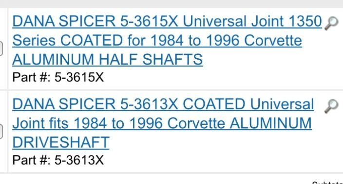

Vader, per your recommendation I found the ones to order. I’ll order 4 of the 3615’s & 2 of the 3613’s. 👍🏻

Like others have said the Spicer grease less are the only way to go. Remember to get the coated version any time it's going on an aluminum shaft. The half shafts are 1350 sized and the factory driveshaft is 1310.
