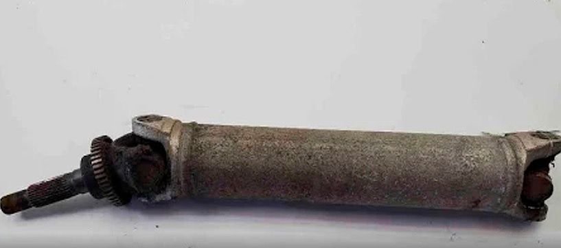

I’m working on a 89 Coupe. Are the Rear ABS Reluctor Rings pressed on the out board half shafts? I need to replace the wheel bearings. Thanks!

The rear is not part of the bearing. The sensor mounts to the buckle and it picks up the tone from the reluctor ring that is on the shaft.
You can replace the wheel bearing without disturbing the ABS.

"" the reluctor ring that is on the shaft."" The axle (actually called spindle) shaft. @ChumpVette are the wheel bearings replaced or the entire hub ????

Thank you for your response. Since I don't have it apart it was hard to see up in there. The places I was looking at in the description for replacement wheel bearings said it was not an anti lock wheel bearing which in retrospect makes sense if it's on the spindle.
