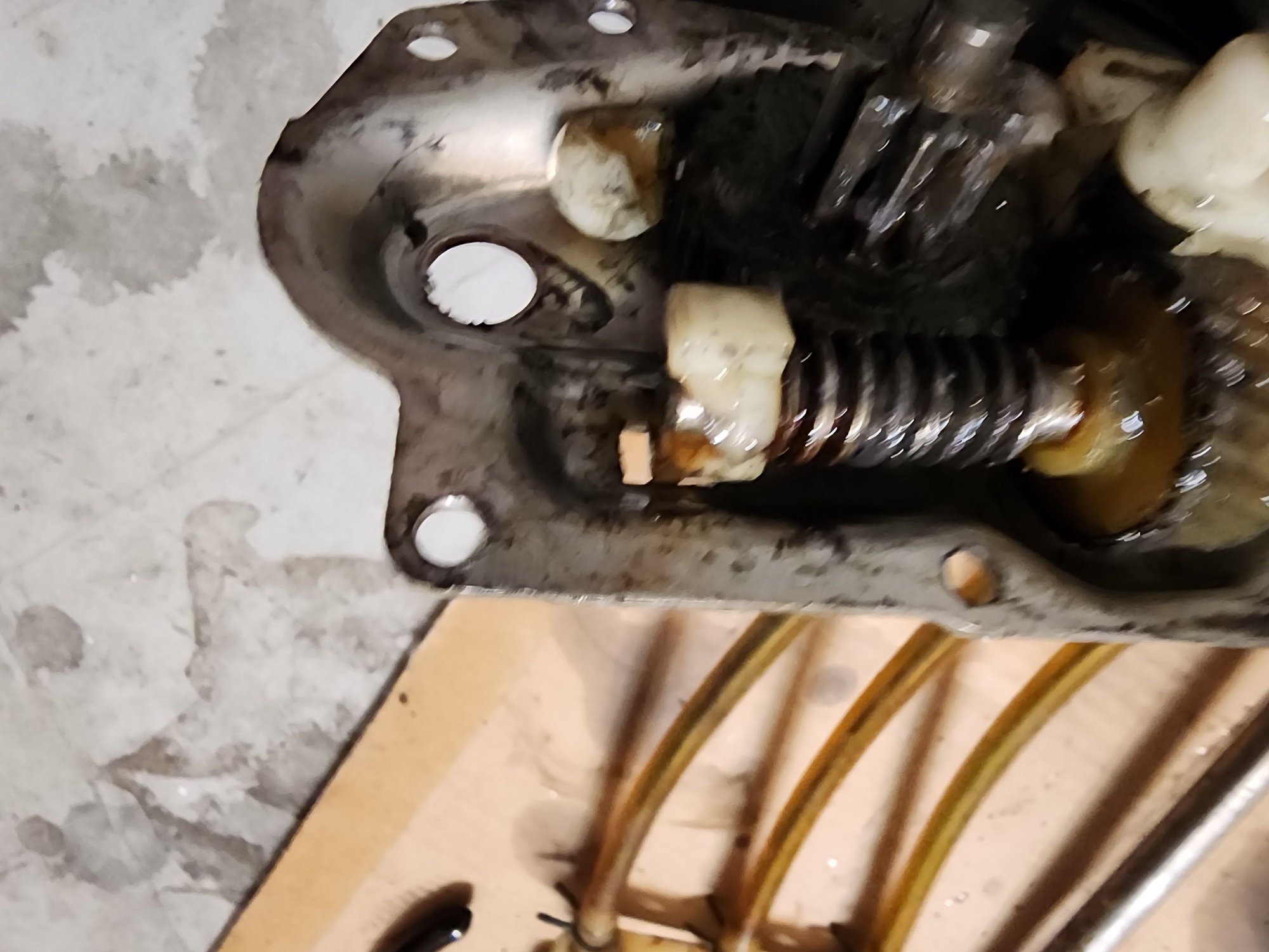

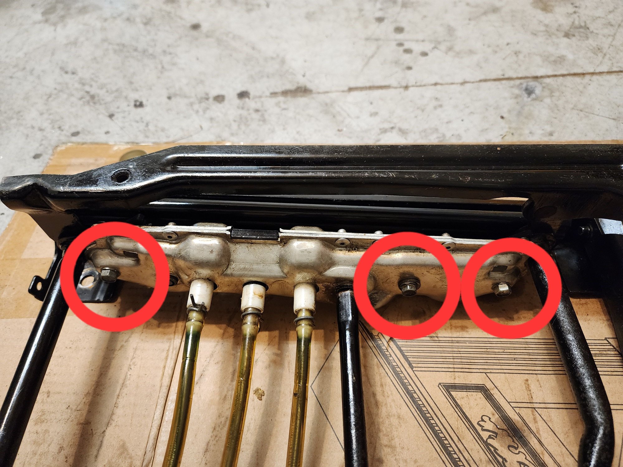

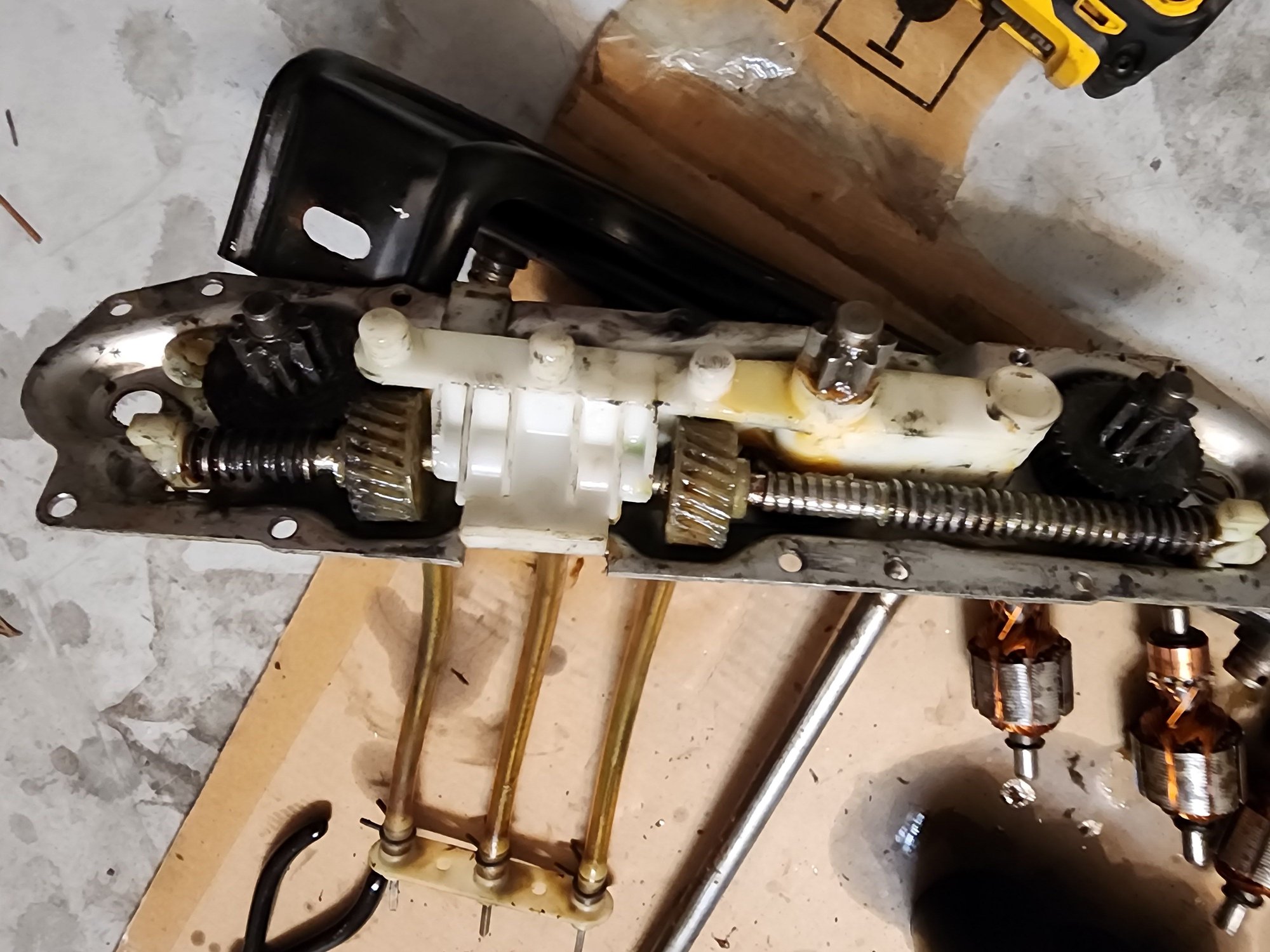

Originally Posted by Ronocala
Thanks. Can they be rebuilt?
Yes, I rebuilt mine with epoxy lol. It's just a few bolts to remove the transmission from the frame, and two cotter pins to separate the frame. Drill out the rivers that hold the two halves of the transmission together, and get screws, washers, and nuts to reassemble.
There's a guy on ebay selling a kit. I'm not sure if I'm allowed to post a link, but I will. (Mods if this isn't allowed, please remove post)
https://www.ebay.com/itm/28584293714...emis&media=SMS
