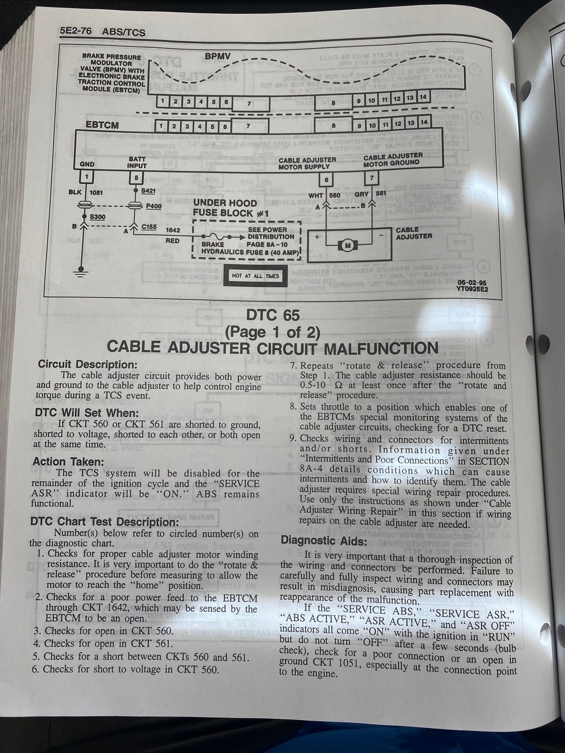

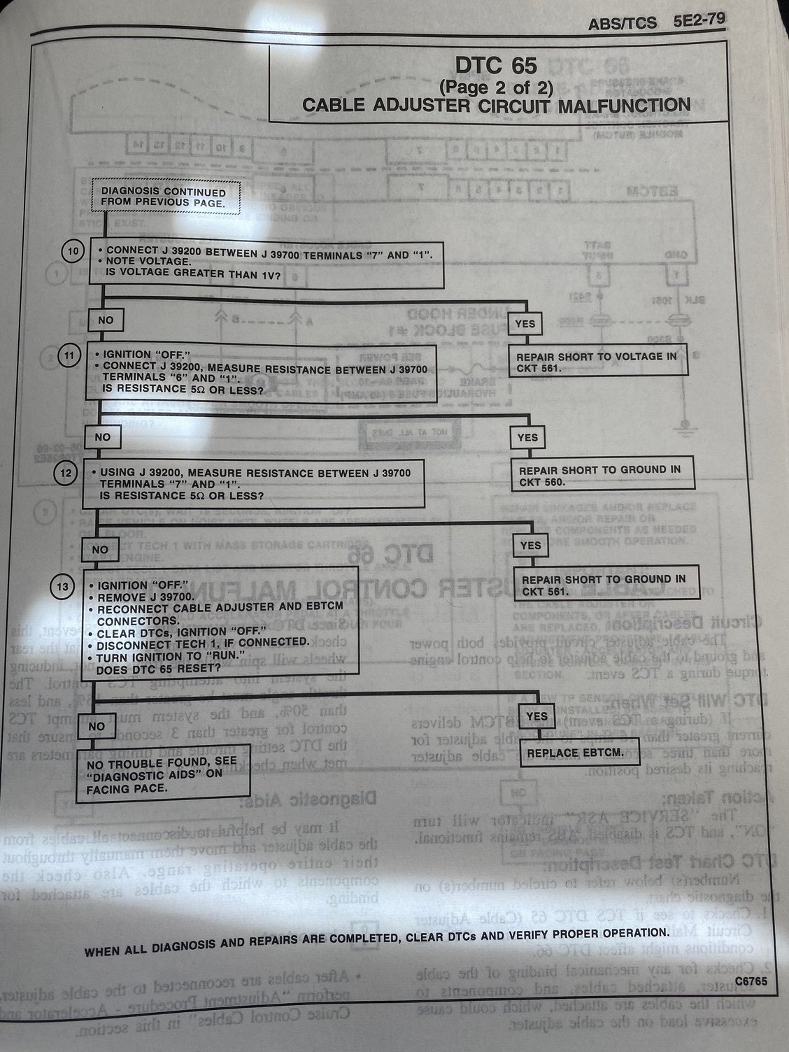

A friend has a 1996 with ASR code 0065. What is the diagnosis for this and how can it be cleared so the light comes off the dash information screen? What is the problem with the ASR in this code? Any help would be appreciated!

In 96, there is no code 65. They went to OBD2.

You can try clearing it, but it has to do with the throttle cable adjuster.
Here is the FSM on that code
