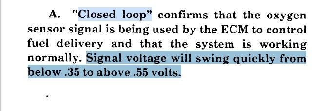

A closed loop is a good idea to look into, I hadn't thought of it until now. Most of the time, the problem occurs just before the engine warms up. How to test it? what exactly happens when switching to closed circuit?

"" what exactly happens when switching to closed circuit?""
The O2 sensor is added to the calculation for fuel mixture. Do you have codes ??

thank you for your reply, I will try to check signal voltage in no start state.
