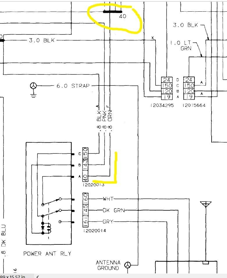

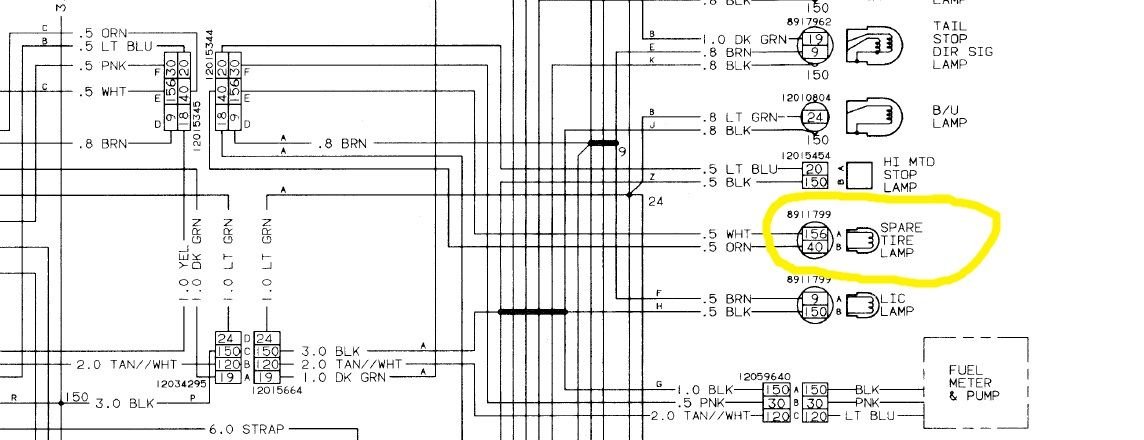

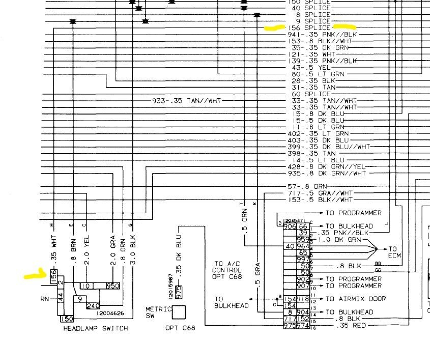

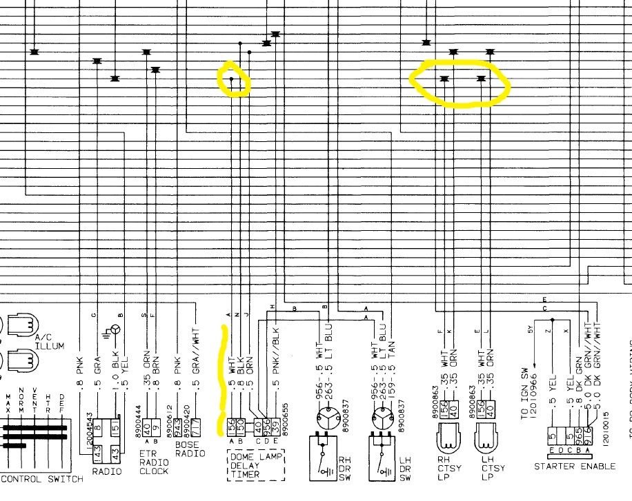

Using 87 wiring diagrams. This spare tire lamp involves the headlight switch and dome lamp delay timer ( GM P/N 10098435 forum sponsor Corvette Central) which would be suspect. Circuit 156 originates at the headlight switch and is spliced into dome lamp delay timer, the left and right hand doors as well as L and R courtesy lamps and spare tire lamp. I did not follow the other side of the spare tire lamp circuit 40 but would believe it to be ground. I will double check circuit 40 to see if it involves the reverse lamp, does it go out when taken out of reverse ?
Circuit 40 does go to ground and into the antenna relay for motor direction.
