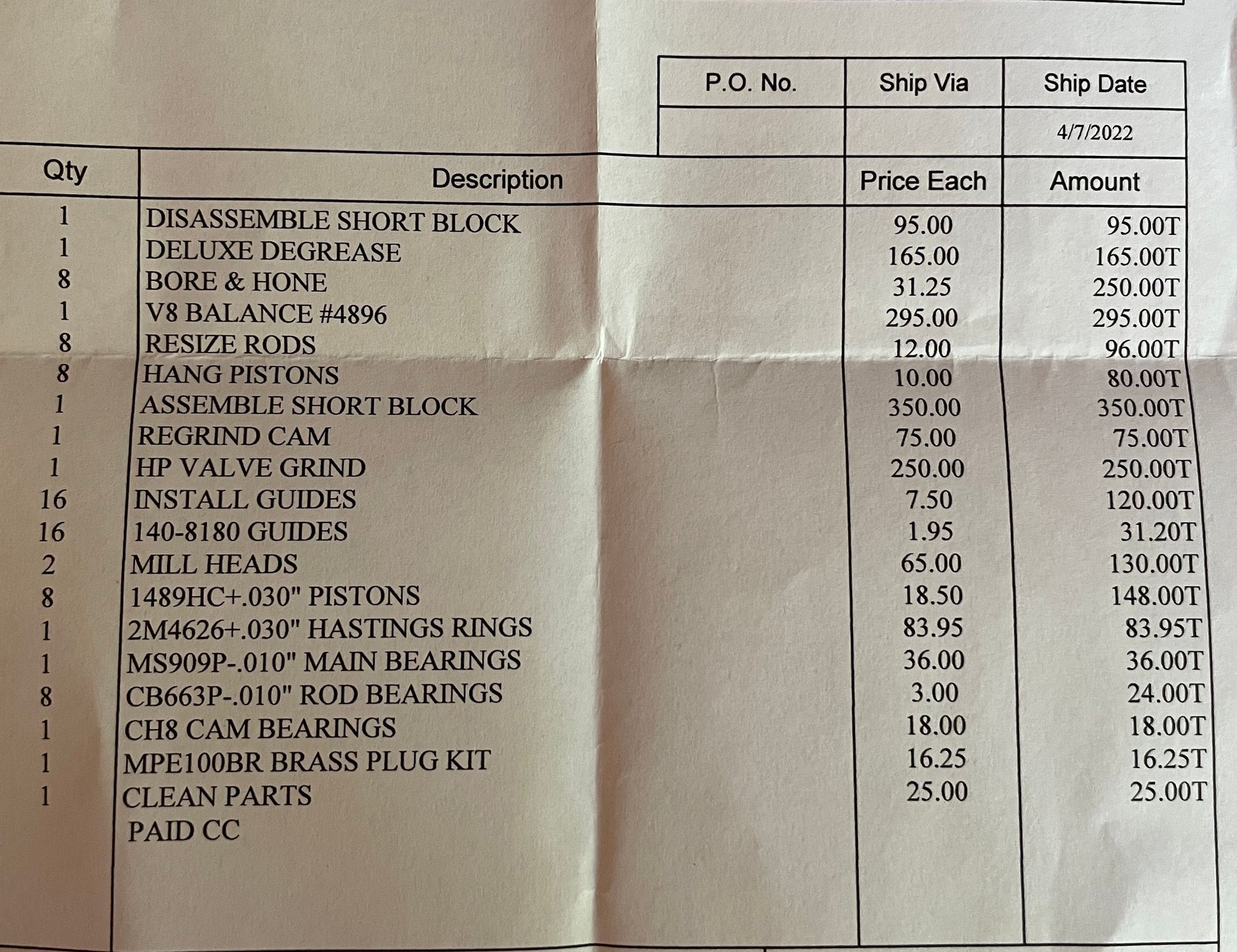

There's definitely a bypass in the filter housing. I was just playing with it again just now. It isn't stuck open though. If the bypass is 4 psi (read that somewhere), this spring feels about right. There's a bit of tension.. but definitely not just stuck open. I'd take a picture, but its back on the car with a filter attached. There's a good chance I'm wrong about the bypass though.
The rebuild was done about a year ago. There's about 1000 miles on it since then. The pressure has always been low at idle, but not zero. I don't recall what the idle pressure was before the rebuild. Maybe there is something off with pump/pickup. Here are my observations:
- Cold start, idle oil pressure is ~40 psi
- As oil temp rises, pressure falls.
- around 180 F, idle pressure is effectively zero (sometimes actually zero).
- I've tried 2 ACDelco oil filters and heavier weight oil. Issue remains
- Off idle, pressure is perfect. >=10 psi per 1k rrpm
I don't understand what internal conditions could exist to produce the behavior. What could be happening that produces tons of cold pressure idle pressure and zero at warm.... but great pressure otherwise. There's a bypass spring in the oil pump itself, but that's for high pressure.. right? Would poor machine shop work allow for good pressure everywhere but idle? The shop was difficult to work with, and did have some dopes working in it while they had my engine. The rebuild was over COVID, so personnel challenges.

If there truly is a bypass in it, the only thing it's bypassing would be the oil filter; it would still be going to the oil feeds internal to the engine which would be causing (back) pressure. The reason oil pressure drops as temp gets hotter is the viscosity of the oil. As oil get's hotter, it gets "thinner" (I use this term loosely, it really means it just flows easier . . such as out of passageways, reducing oil pressure). This is why multi-weight oil exists. Eg, for 10w-30, it has the viscosity of 10w at cold, but as it heats up, it tries to correct this decrease in viscosity by performing as a 30w oil.
I know a lot of machine shops that are of the mindset "It's good out of the box!" when it comes to oil pumps but in building motors, I've found brand new ones that were out of spec. The other aspect of this is considering what tolerances your motor was built to. I like to build my engines on the "loose" side, going towards mid range on the crank mains and towards the top of clearance on the rods to promote oil flow to the rods. This requires me to run a high volume pump (also running a Derale cooler).
Looking at this: Plugging the oil filter adapter bypass? Has anyone done it and how? - CorvetteForum - Chevrolet Corvette Forum Discussion
This just reaffirms my position - If the bypass is stuck open, it just skips the oil filter and your bearings/oil feeds should be causing enough of a restriction to build oil pressure. If the adapter is stuck closed, it's just going to force oil through the filter. You should still have pressure from the oil feeds in the engine regardless.

There is absolute -zero- reason to run a high pressure pump unless very specific build considerations. The fact that you're only getting 10psi/1krpm with a high pressure pump says either you have a bad reading (you said you already verified with a mechanical gauge) or something is very wrong/out of spec internally, or bad oil pump.
The "general" rule of thumb is 0.001" clearance per 1" of journal. Checking service manual for an LT1, different journals have different limits.
Mains (in inches)
#1: 0.001-0.002
#2,#3,#4: 0.0010-0.0025
#5: 0.0015-0.0030
Rod journals: 0.0010-0.0030
I like to get my crank journals to around ~0.0018 for all (which is within limit) and 0.0025 for rod journals. So you seem to be within spec except for your #1. . . but I don't think two tenths is going to cause that issue. The one thing I don't see on your work is an align hone on the mains. Generally, they're pretty good in spec, I just do it for insurance, but if you don't, I could imagine those clearances opening up a bit. Have you seen a bunch of glitter in your oil?
I haven't seen any glitter in the oil, or found anything on the magnet I run through drained oil. I'll pull the engine again, and see what I've got going on in there. Maybe a bad oil pump (like you mentioned)... or something else.
Thanks again for getting me off my wild goose chase this started with.
