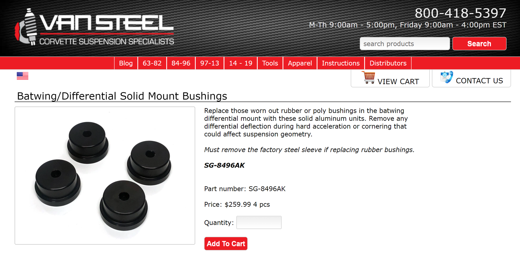

Can Steel has some solid aluminum bat wing bushings.
But yes, poly can distort and break down. I’ve seen it mainly on swaybar mounts, but also in lower front A-Arm and also in the rear.

I have not run solid aluminum bushings yet, however if I was going to do that the Batwing would be the place I would do it - HOWEVER the road noise would likely be terrible. Another drawback is that you need to remove the steel bushing shells from the Batwing, so the installation and reversal if you can't stand the noise is going to be much more difficult.
Aluminum Batwing bushings are available at VanSteel as mentioned by CV.
