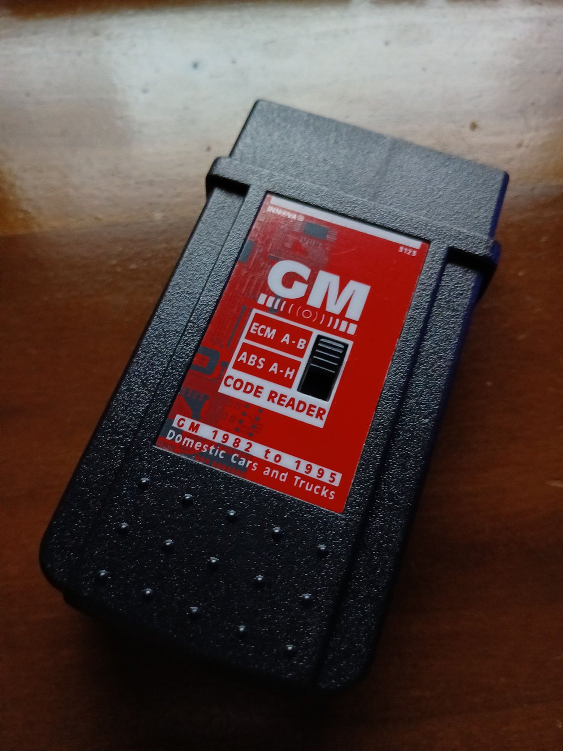

there is a code reader for the OBD1 system.

I wouldn't waste money on a code reader these days. I'd get a scanner that can actually read and log data. It'd be far more useful as not every malfunction will throw a code...
