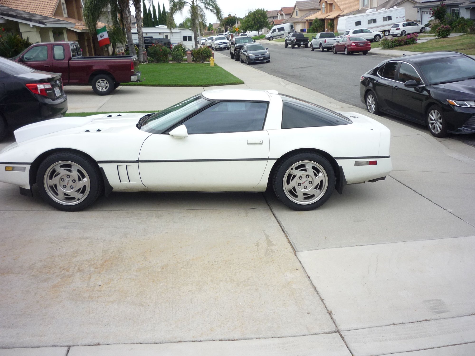

Prochager P600b-printed off the CARB website says intercooler has to be on the front of car-so I just redirected the air thru it. A lot of work....
A lot of folk don't care for a scoop, but I figure if it's functional then it isn't rice LOL!

So it looks like you built an LS turbo'ed in a 240SX that actually has a front grill. It does look like a really nice build. You could never build that in Kali and pass smog (yes jealous!) However on a C4 bottom feeding air it is much more difficult to make it all work. Also on a side note-it's not just static CR but also add in the cam/boost for dynamic CR. I'm 8:1 static but max on dynamic.
