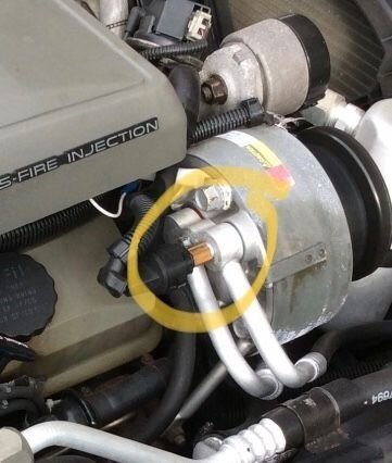

I found a number of older threads on the forum discussing this switch but I have been unable to find a replacement switch that threads onto the schrader valve on the back of the compressor. I ordered one that looked correct and stated compressor mounted but the threads were too large. When I got the car the switch was missing and a homemade jumper wire was in place. Hopefully someone here has a P/N and source to purchase.

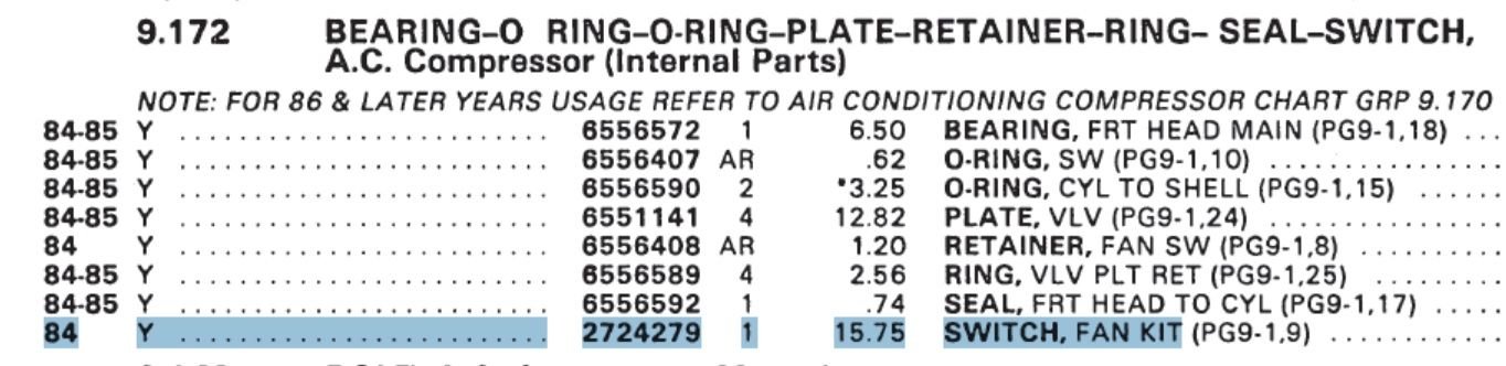

I see GM 2724279 high pressure cutout fan switch 84-96 , be careful with this info as I am not sure and don't have an 84.
Some sites show it crosses to 89019195 which is on rock auto and shows the 2724279 # and list's it as compressor mounted.
https://www.corvettecentral.com/c4-8...igerant-454645
Thank you but that is a different switch that mounts in the case of the compressor. The one I’m looking for screws onto the schrader valve of the hose assembly on the compressor.

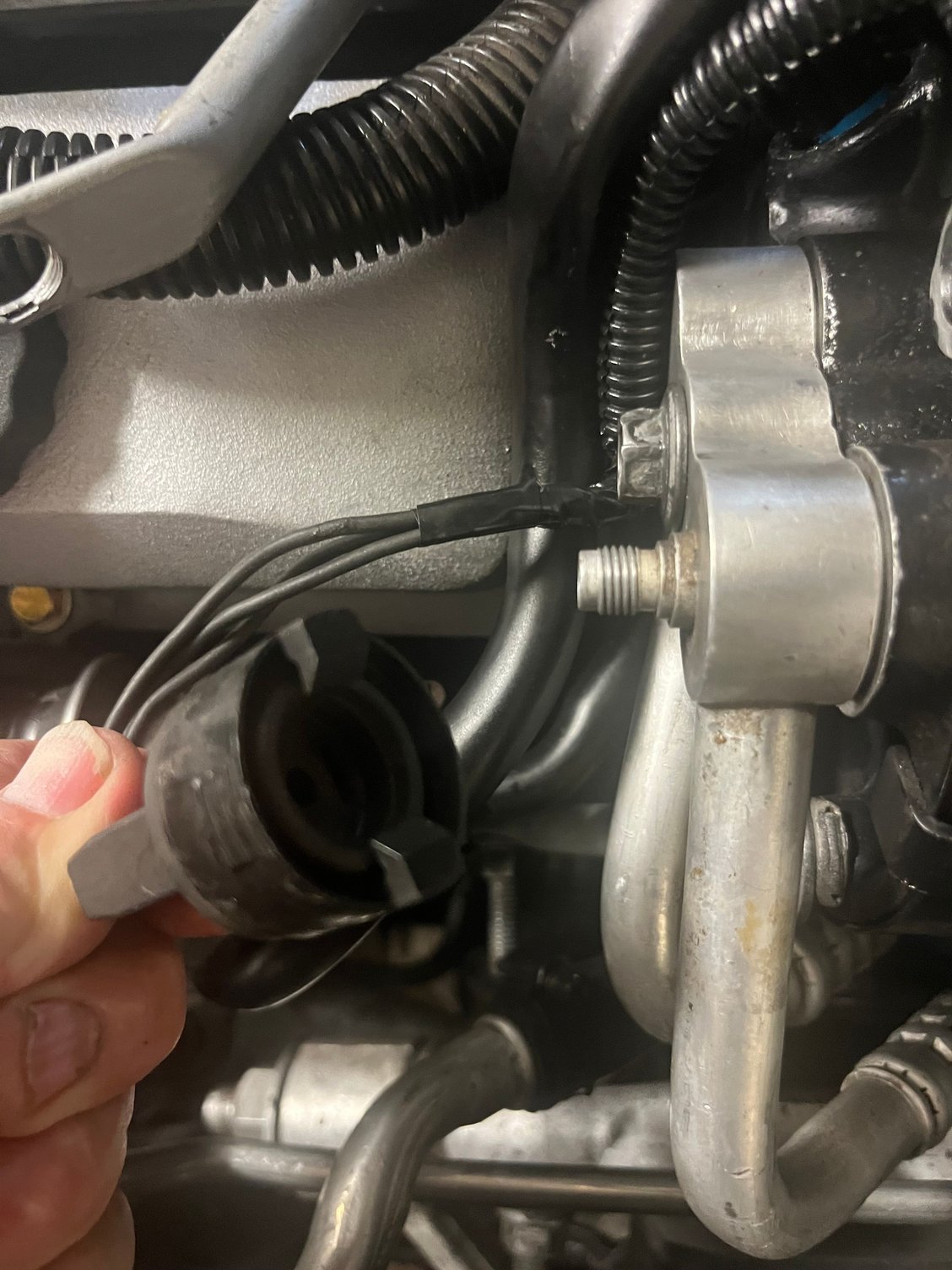

I'm not an A/C expert, and I'm not near my car right now to look, but I don't ever recall seeing a switch attached to a Schrader valve. I'm wondering if somebody didn't improvise a fix.
Every one of those type valves or switches I've seen are screwed or clipped into the back of the compressor.”
Not sure what year you are looking at but on the 84 there is a 3 wire, 2 terminal plug that connects to the switch in question.

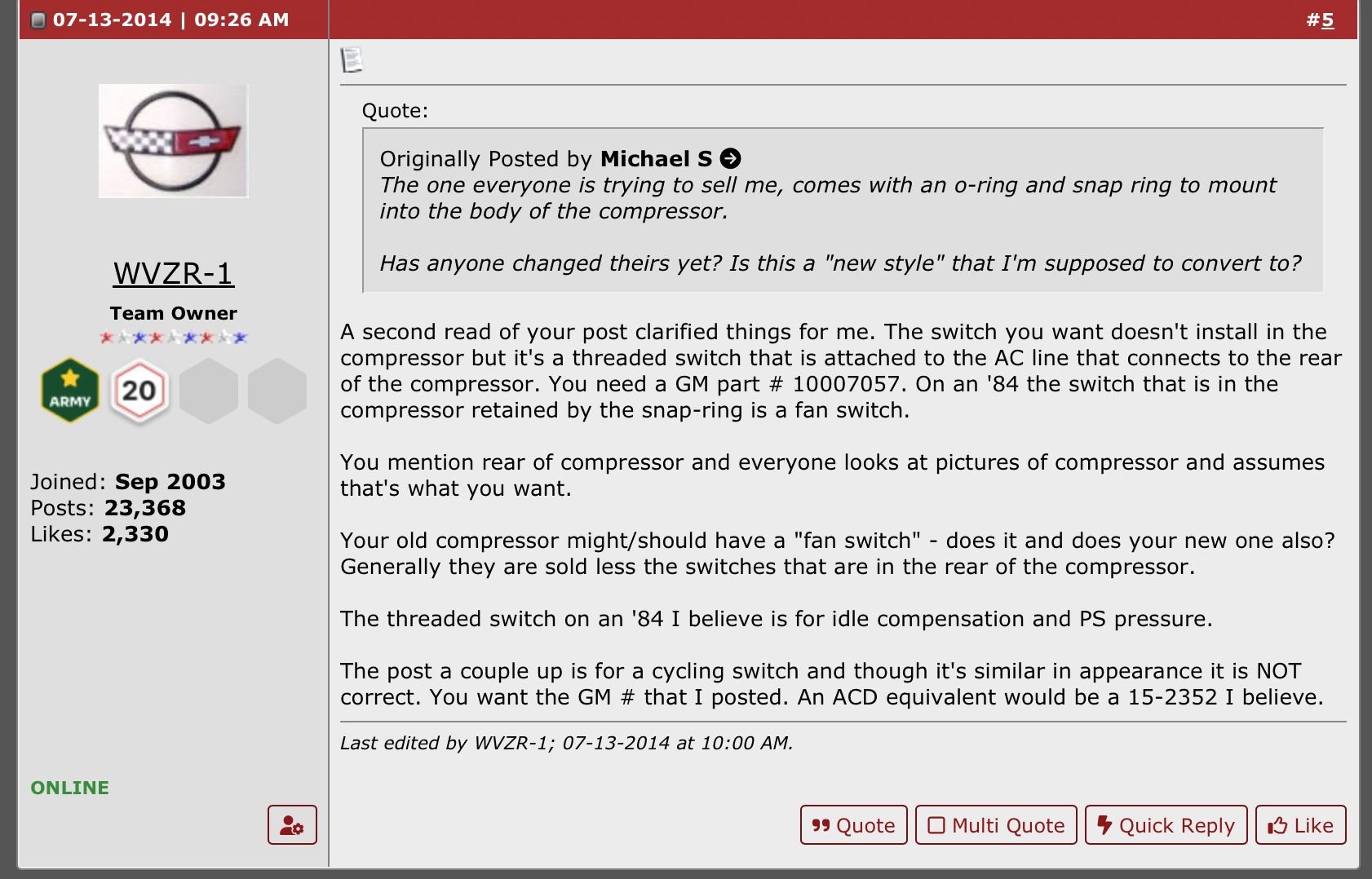

@WVZR-1 has the code cracked…
I know my 84 is the same as his, switch screws into a Schrader valve on the 2 hose assembly which is bolted to the rear of the compressor. Just like the pic already posted shows
Granted I only know it's a schrader valve since dad snapped mine off flush and the guts of the valve stayed with the sensor

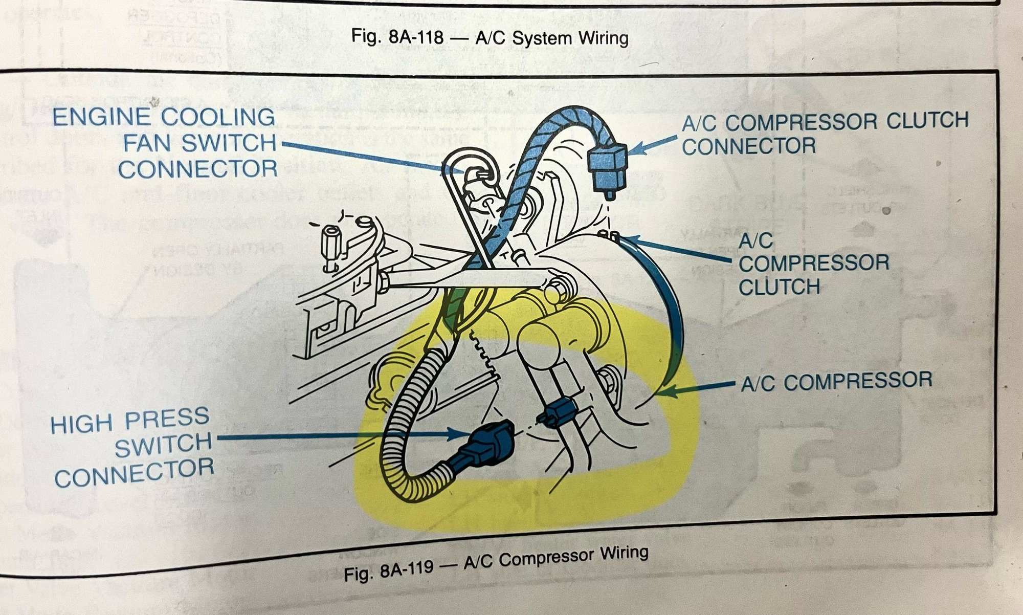

Here is my wiring harness and the description from the FSM.
Factory Service Manual
My 84 harness/connector

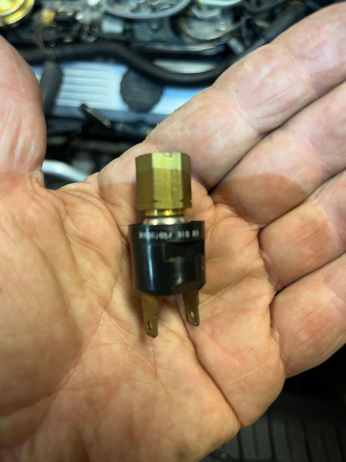

To close the loop on this in case someone else stumbles by looking for the same information. The original GM PN 10007057 has been discontinued and I have been unable to find anyone who reproduces it. I was able to find a NOS which fits perfect! Perseverance pays!

So, a question: Is there actually a Schrader valve under that fitting, or does the system have to be evacuated to change it?
I'm trying to source one myself, and if I do, I'll try to run some tests on it to determine cut-in/cut-out pressures. With that data, perhaps we can determine if something else can be substituted.
Great find!
there is a small “tit” inside theater depresses the Schrader Valve on the service port. In the FSM I believe it gives the cutout pressure rating and function of the switch. I don’t have the manuals with me at the moment to check but I will look when I get a chance. The problem I had with all the other switches is the threads are too large to fit the connection on the line. It is a different size than the switch that mounts on the evaporator outlet line.
