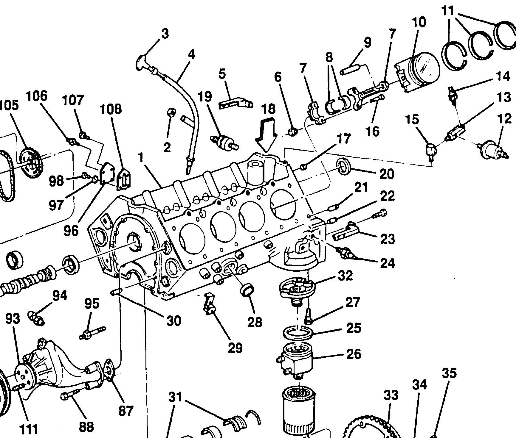

I'm heading toward the final assembly of my l31 > l98 replacement.. any Idea where this bracket goes ?

Did you pull the motor, it looks familiar I think it goes on the driver's side bell housing bolt to hold the transmission harness.
There's also a similar one on the 4+3 between the T10 to hold the OD and shifter harness
Maybe? There's a pair of similar for most years. This image numbers 5 and 23 are similar but part numbered differently.
Well you answered a doubt I was conflicted on, I was very strong on the location by the filter #23 but I couldn't totally commit to #5 but I kept on thinking about being there
