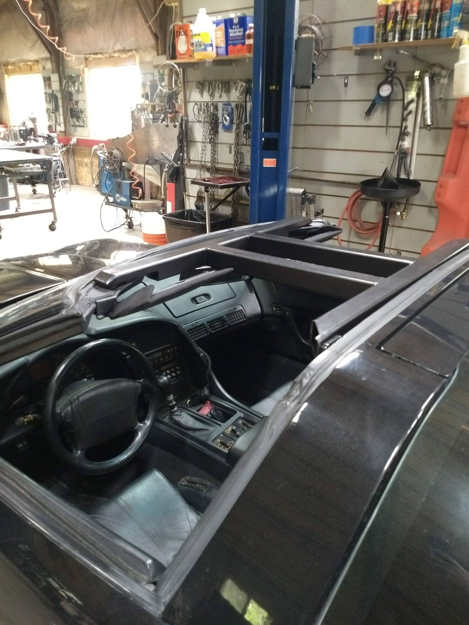

So even though I still have time to drive im planning some winter projects (as if I need more).
It has been a tough year for me and only have taken the car out a few times. But I've got the itch back so this weekend will be some more test and tune. Car is running great. Just been tough to enjoy it...
Anyways, besides body work, I'm thinking of fabricating a targa top truss bar for it.. i think ill also make a fiberglass top to mount to truss bar for it as well (so the car will look like it has t-tops that are removed). The ones they sell, are they steel or aluminum? Just wondering as I was gonna do aluminum. Thoughts?
Also was going to make a tie bar for the upper shock/a-arm mounts in the front.. thoughts??
My car has a 6 point roll bar, but now that I'm used to how it drives, was thinking it could be a little stiffer. I never drive with the targa top on it as its in bad shape, and also I only drive in nice weather.
If your not familiar with my setup take a look at "just for the hell of it" in the c4 general section.
Im all ears for thoughts on this.
Oh, and was going to beef up the arms that go from the a-pillar to the frame. While the car was on the lift I could almost see the front flex a little (hard to explain). But this all had me thinking.....
Thanks everyone

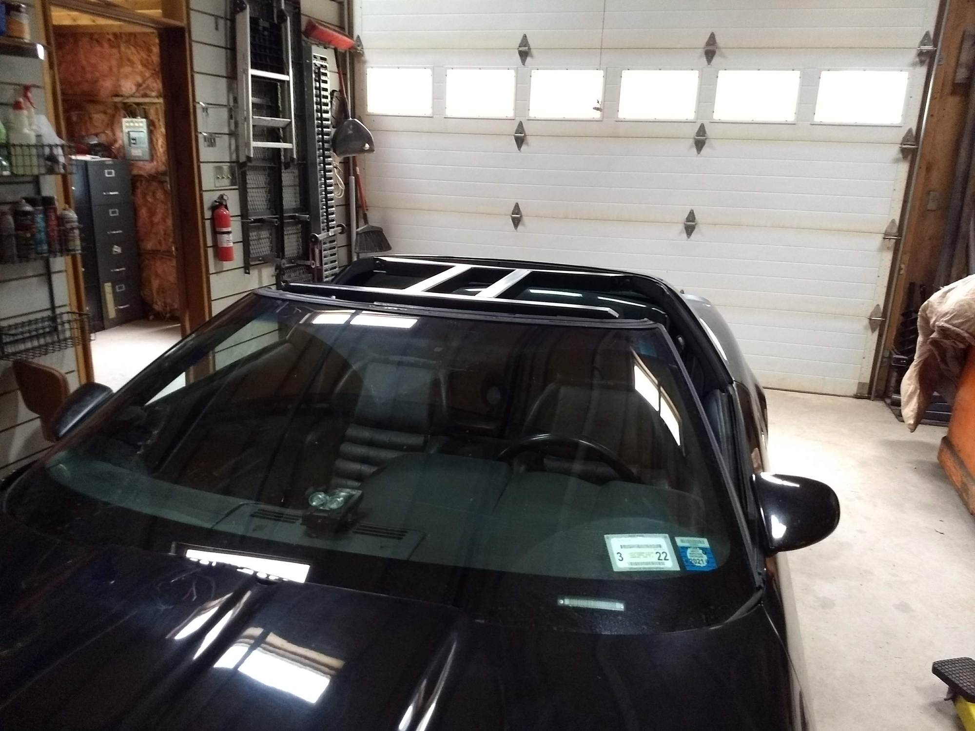

Here's the brace I made a few years back. It's steel square tubing. It works really well and it's low profile. The car feels as stiff or stiffer with it on as opposed to the factory targa top. I was thinking about making an easily removable fabric top that fit over this but haven't gotten around to it yet.
