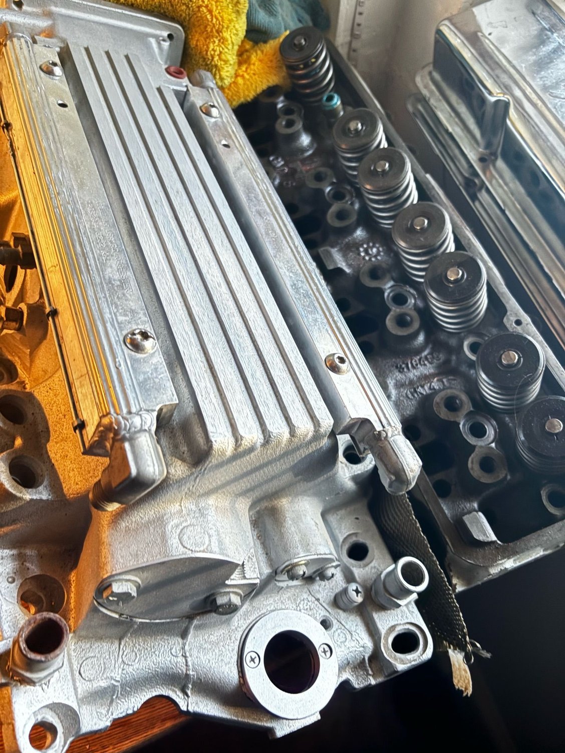

dont get me wrong this thing handles crazy with my current alignment specs. having a shop to work in is a luxury. i will attach some images. car was in 1 accident. figured since im gonna be doing body work i might aswell go all in. I plan to stay with the small block for power. since i have alot of SBC parts. 2.08intake, 1.94exhaust ported heads. A LT1 manifold modified to fit a SBC gen 1. got a remote t stat. KB111 Pistons. 383 Crank

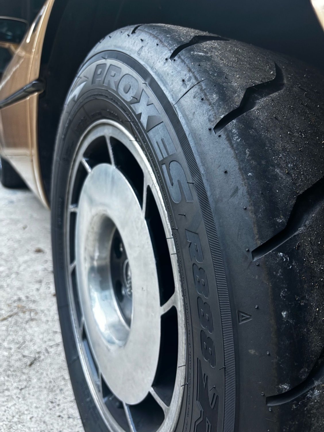

Also she likes proxies 888r
