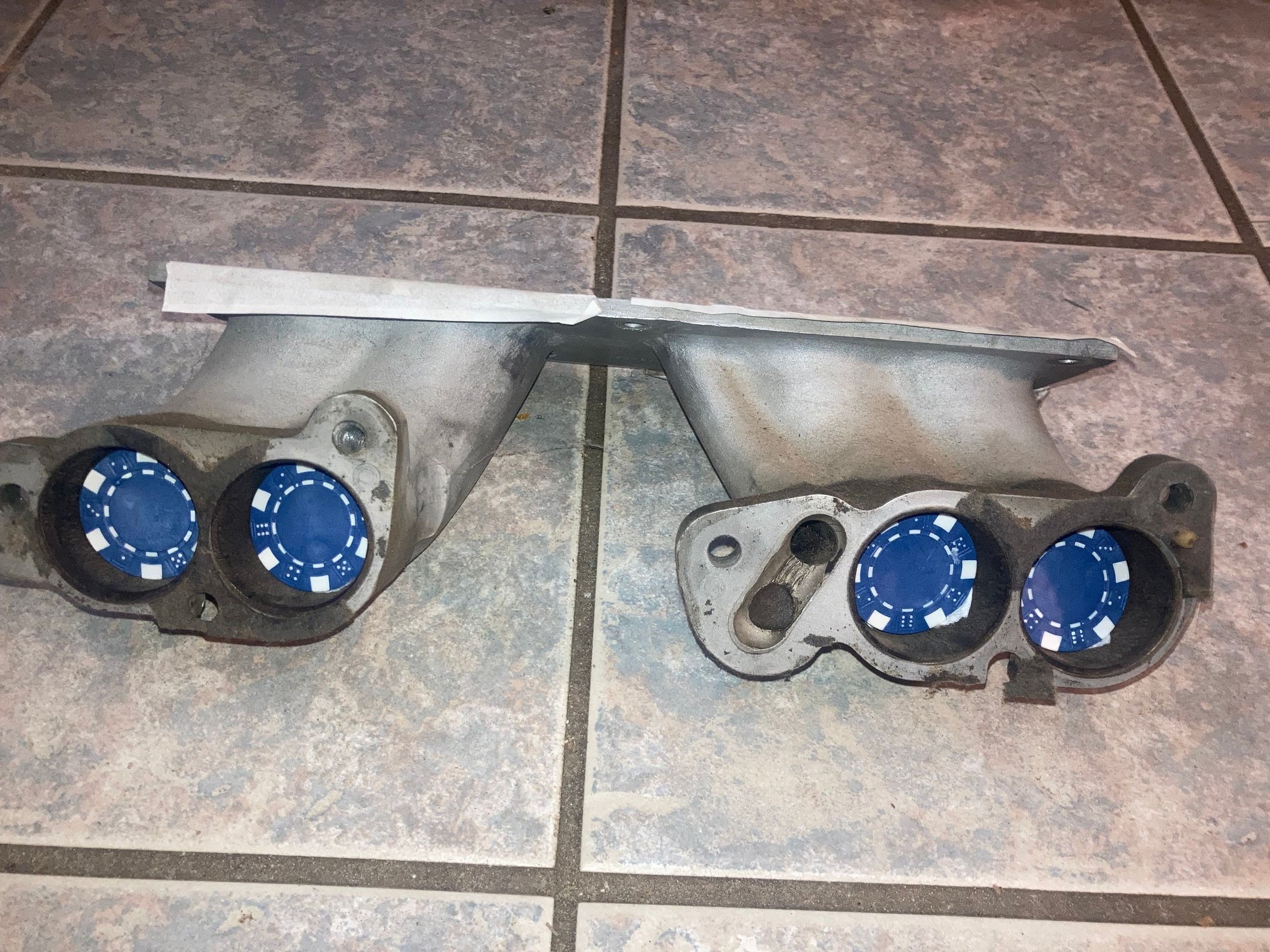

You could try to find an LT1-specific superram (base and runners) and adapt throttles to the runners somehow, or fab some custom runners for this purpose.
Maybe just put 40 mm throttle blades on a shaft right in the runner and convert the runner to a throttle body.

Quick mock-up:

Originally Posted by tequilaboy
Quick mock-up:
Nice!, I picked up a used one for fitting from speedmasters
