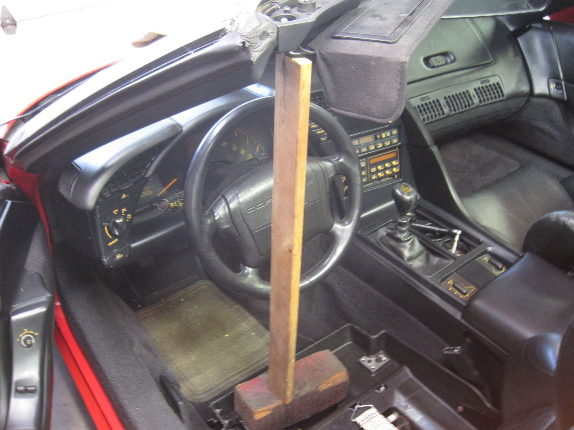

How do you compress the spring, push the nut on, and hold the visor up at the same time? I don't have three hands, so after some head-scratching I came up with this. I used the power seat 'tilt' to hold the visor in the full up position. I pre-flattened the prongs on the nut with a hammer on the anvil of my bench vice. Then popped the nut on with a socket and gentle tap of a plastic mallet. Cheers.
Ye sir, good idea to bring up. I did a version of that... finally.
