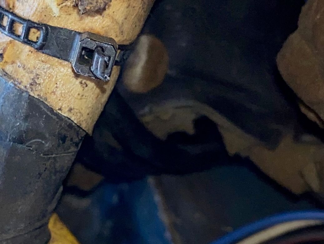

Anyway. Crawling under there I see that the cable release wires go under an underlay and then upward toward where they come into the firewall.
The only way to get to the grommet to lock it in place, or to even see it, would seem to be to cut the underlay because you can't really pull the underlay out of the way. There's just too much on top of it with wiring and brackets and other junk.
Which I do not want to do.
So my question is how are people getting up in there to lock that grommet in place with that underlay in the way?
I don't have the replacement cable yet, it'll be here tomorrow, but I was just looking under there to see what is what. I ended up getting it off eBay because I'm not paying Zip half of what the part itself costs just to ship it a few hours up the road to me. I'm tired of that nonsense. So hopefully it's not too short. I've read that some of those Dorman ones are too short.

It's just the getting to it so that you can see what you're doing part of it that's going to be a problem. If it just went straight through the firewall under the underlay rather than going upward six inches or so under the underlay, it would be simple.
I'm probably gonna have to cut it and then duct tape it back together afterward. It's the only way that I think that I will be able to see where it comes into the firewall to do it right.

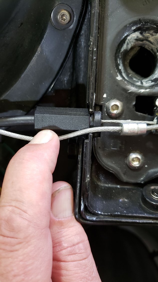

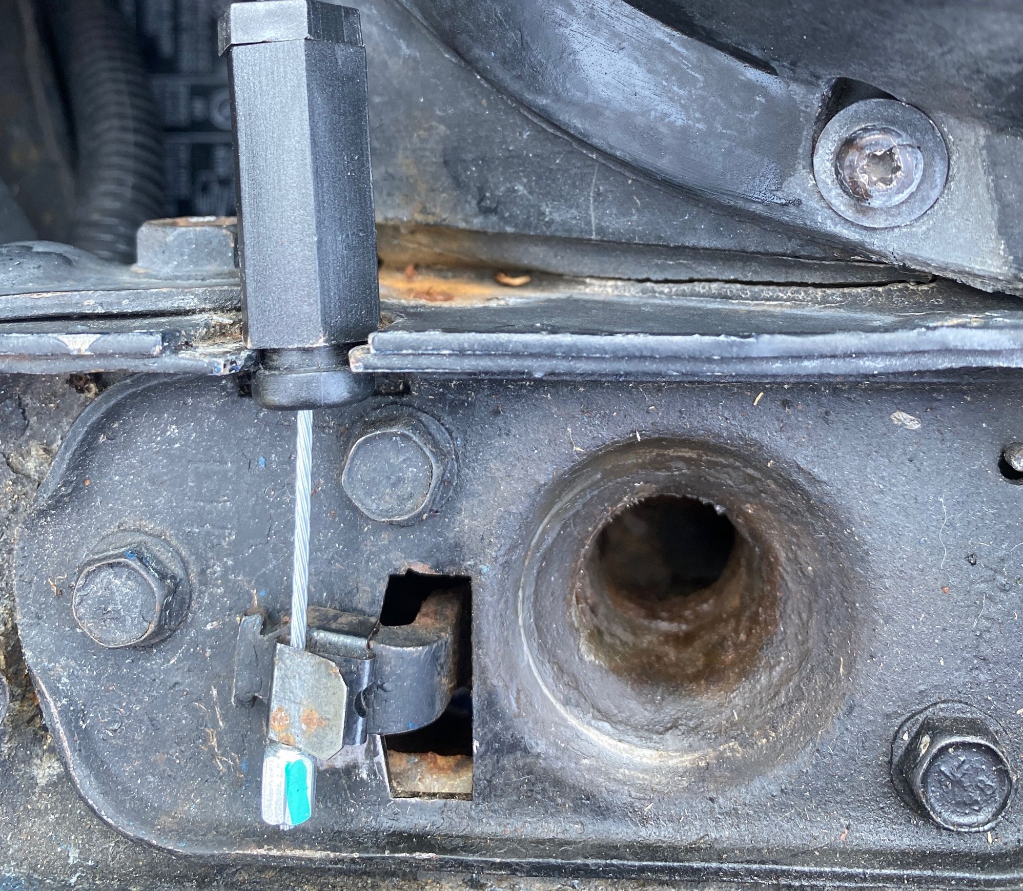

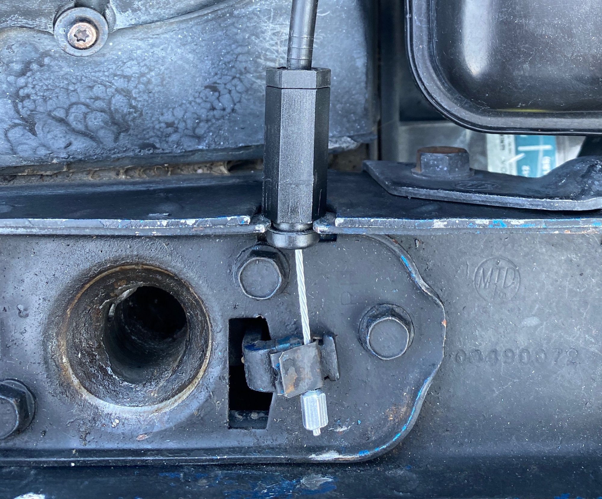

RH side cable is too short. I'm completely out of adjustment, too.
Not gonna latch.
And I even ran the RH side cable behind the distributor.
Actually, neither one works. Neither can be adjusted to allow the latch to grab...
Here's the part #...
Don't buy it...

Just PMed you.
I believe I got rid of the adjustment nut and that did it. Been fine for years.
After thinking about it, yes I cut 1/2" of the male threads off and didn't use the lock nut.

Originally Posted by FostersPerformance
Just PMed you.
Oh, good. That's what I was wondering about.
I'll do that tomorrow.
I'm done messing with it for today.
Thanks! Appreciate the help on it.

I did cut the underlay a few inches, though, so I could get my hand up there to push em through and seat the grommet properly.

Anyway. I went out a few minutes ago and followed Foster's instruction on cutting the male threads down about a half inch and then cutting the plastic securing nut off, as it was therefore useless at that point.
Everything works now and I have that nice pop when the lid opens. Dremel made it quick and easy versus tinkering around with a razor knife.
