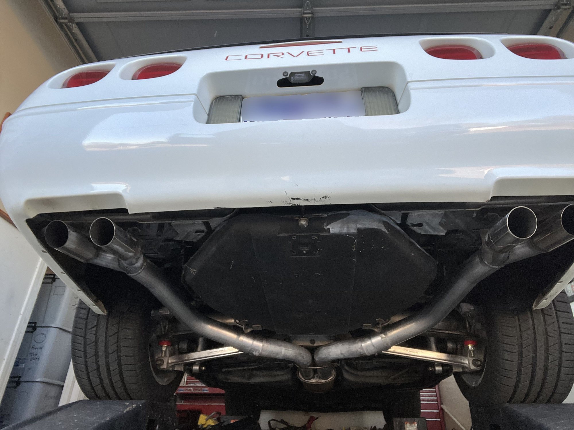

First, I wouldn't weld or patch anything with a hole. That's just me. Replacement exhaust parts for these cars are relatively inexpensive, and I'm just the type who doesn't like what I consider to be a "band-aid" fix.
That said, I considered a Corsa and a few other systems. Corsa has a great sound and IMO looks the best, but it's very overpriced. I got the car up on a lift and everything was neat, fit well and looked almost new (my car, C6, has less than 50K miles). The stock systems are good for up to around 415HP, so I just decided to leave mine alone. I'm beyond the age where I'm going to rev my motor every time I go through a tunnel; I'll leave that to Mustangs and pickup trucks with glass packs.
I bet you can get a full stock system, gently used, for a good price. Good luck.
