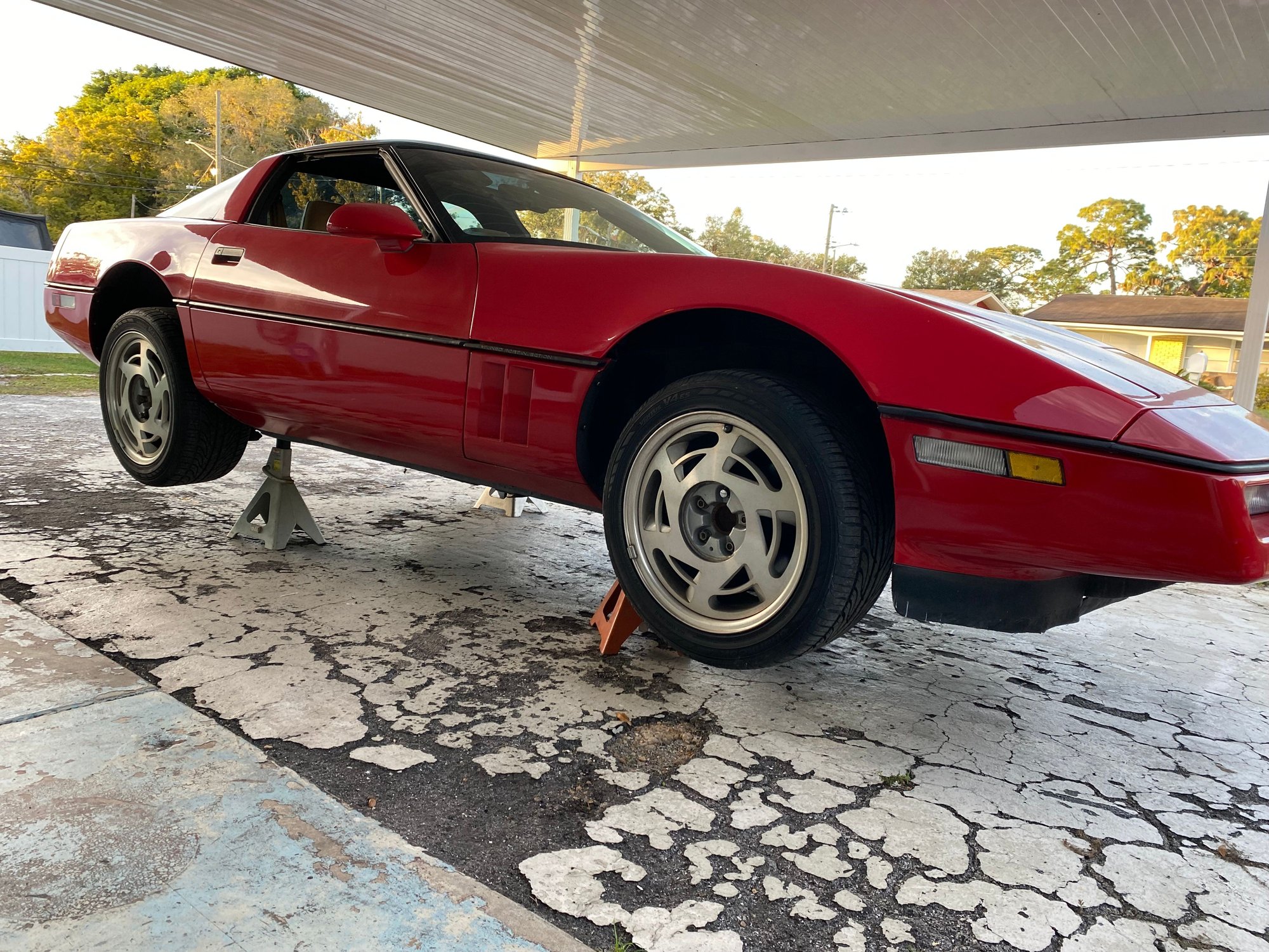

I place the floor jack right under the mirror, jack it up until the side is off the ground, place the stands underneath, then let the jack down and do the other side. Make sure your targa top is tight.
