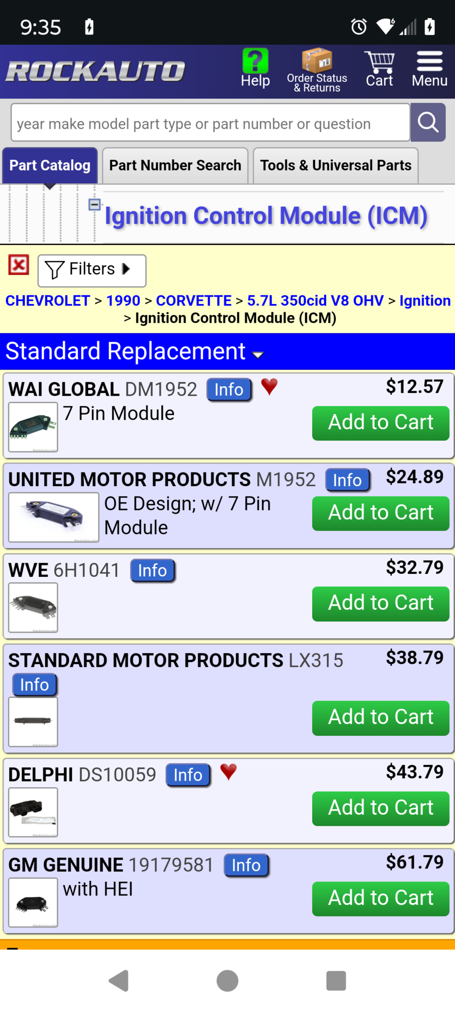

Which hei module do you guys use? I haven't had to buy one since the 1990's and always bought a genuine GM, they were 60+ dollars then, but not available anymore.
Any quality suggestions? I see a lot of cheap stuff for under $20, I want to do this once, and forget about it for a while... thanks
Old Oct 28, 2024 | 09:38 PM
C4industries's Avatar
C4industries
Joined: Feb 2024
Posts: 266
Likes: 112
From: New York
Rockauto shows it available for $62
​​​​​https://www.rockauto.com/en/catalog/...ule+(icm),7172
Thanks, I appreciate that. I am going to pull it first to make sure I have the correct pin count, 1989 model

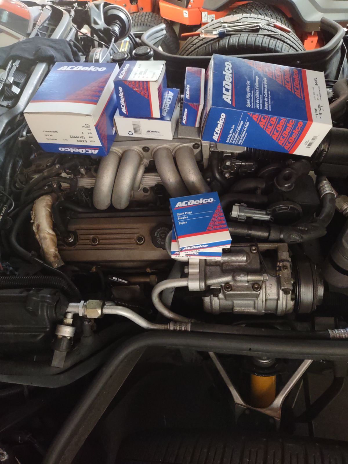

Well my parts came today, minus one spark plug, RockAuto only had seven? Anyway every AC Delco boxed part is made in Mexico, except the HEI module which I'm pleased about that. On some of my other forums that I'm on and some friends of mine also say a lot of ignition aftermarket companies make that stuff overseas now too...This was my first time using RockAuto, they're not too bad I guess...
