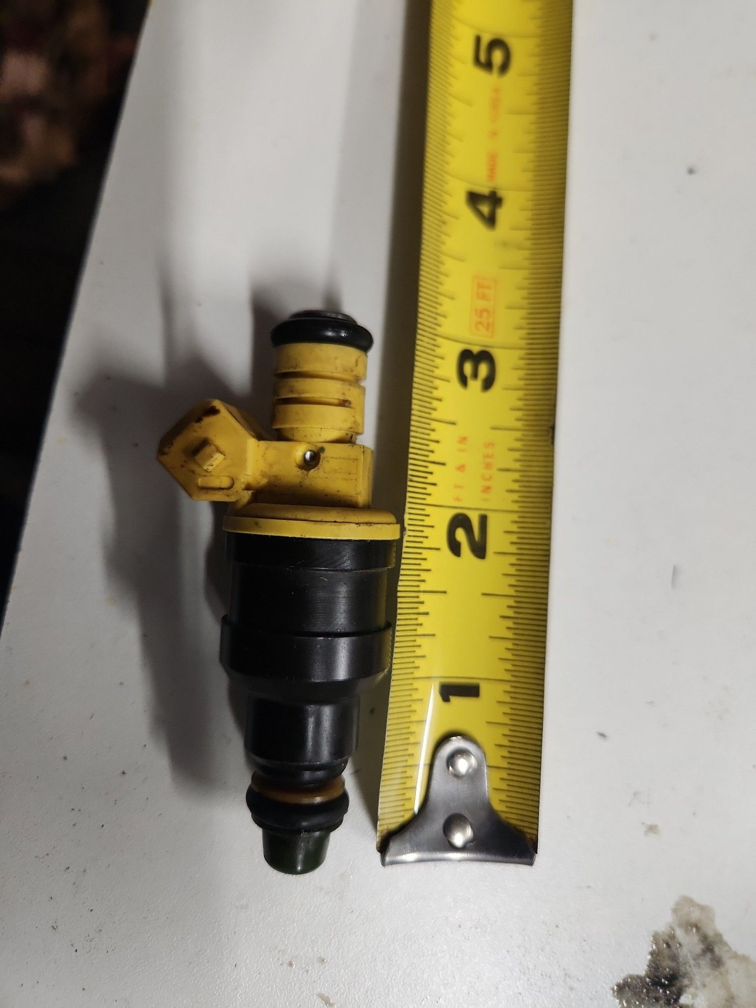

Can you measure the length of your injectors for us and tell us what numbers are on them? You should not have to install the injector connectors before hand. Pics help as well. Short injectors are sometimes double oringed at the bottom. I had to double check it has been a while, install injectors in intake manifold first.

Thank you for clarifying that - I’ll try putting them in the manifold before the rail.
here’s the injectors I’ve had - the only marking I can read on it say ACCEL 4357 and it’s 3 inches tall.
I have a chance to try again tomorrow and can report back.
Fuel injector is 3 in long

Is your engine stock ?? I am unsure of those injectors, but it is because of my lack of knowledge not neccessarily the injector. Make sure to clean the intake and fuel rail sockets for the injectors and use and small amount of motoroil as a lubricant for the orings. Injectors are usually loose enough to spin even when the rail is tight. Clean the injectors themselves and make sure the orings are new. As for the car not having many miles, you are not encountering mileage issues you are seeing age issues. The car is after all 36 years old. The good news is the parts are mostly inexpensive and the car itself is very fun to drive. Retainer clips are for ease of intallation but serve no purpose after install. The 4 bolts, torqued equally onto the fuel rail, will hold the injectors. Their length appears appropriate.

As far as I can tell the manufactures number for that injector is 150824, 24.3lb injectors @ 43.5 psi. 4357 is not really referenced accept in two places that I could find and I would not stake my life on it.
