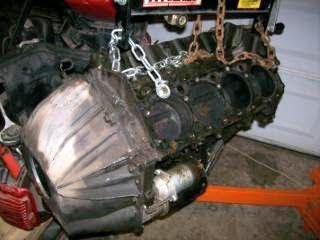

On a 4+3 I know it's very doable
Mine
Mine
On a ZF6 tho, I have no clue
Mine
Mine
flannel, did you reinstall like that too? the issue i would see almost insurmountable would be is the restabbing of the trans input shaft into that. it might technically be possible but i cant see it.
maybe…just maybe…because the clutch assembly wasn’t disturbed , the alignment would be easy. but then, who is doing this and not replacing rms and inspecting clutch for wear.
ive reinstalled 8 or so trannies and its always the last inch thats an issue. i cannotimagine how this could work but i could be wrong

Viking, actually yes, I did reinstall it that way as well. The clutch had less than 5k miles on it, so I reused it all. Still have the alignment tool hanging on the pegboard next to the one for my F350s ZF6. I was actually expecting it to be a nightmare since about 2 months earlier I had helped my dad replace the hydraulic TO bearing in his F250s ZF5 . That thing fought us for every millimeter for a couple hours and all we did was roll the transmission back to replace the bearing and then roll it forward, nothing changed rotationally for alignment. By comparison the 4+3 somehow magically aligned perfectly and the engine slid right in place
The last inch shouldn't give you any issues. By that point you have your bolts in and everything should be aligned, the only thing to possibly fight you would be the input shaft bearing. Try this if you are stabbing the transmission to the engine, get new bolts of the same thread pitch as the mounting bolts, as long as possible. Then grind the hex head off, just the hex pattern, keep as much length as possible. Then cut a slot in the head end for a flat screwdriver. Boom. Alignment studs. Run them in a couple threads, but don't get them tight, cause you'll be backing them out via screwdriver. Line up the mounting holes to your alignment studs and shove er home till a bolt is long enough to grab and crank it together swapping studs for bolts as possible
