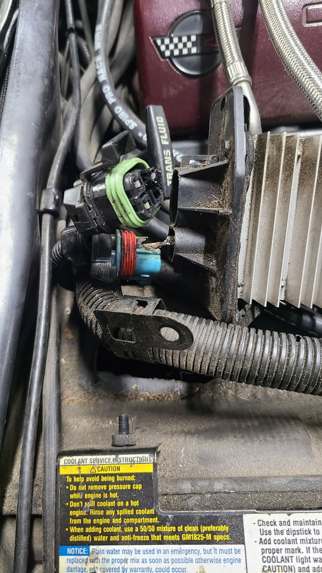

Blower motor works, but the controls via the module are definitely the cause of the blower not working. HVAC controls, C68 is working fine..
But, I need the plugs as they are a bit toast.. If anyone has a lead on where I may get some, I would appreciate it.
1993 LT1, Electronic AC.
I have a new module, just need to get new plugs, depin/pin as needed.

Pretty sure the blue is a AC Delco PT204

Here it is. The slots to fit are correct.
https://www.rockauto.com/en/parts/ac...onnector,10138

Originally Posted by WVZR-1
Are you wanting 'pig-tails' or just connector shells that you could release and reuse some and then use terminals for the damaged ones?
I want the whole pigtails. The pins are fried to the blower control resistor module for one of the connectors. I am just going to cut it off. Its the 2 pin. The other one, the pins fried to the plastic. I pulled it out, and would rather have all new connector. I think it is AC Delco PT157

Both are offered in the after-market and I'd buy local were it me. The likely hood of receiving other than what you expected from RA is often a result.

Looks like O'Reilly's has it. My neighbor works at Auto Zone too. I will check. I would think Dorman has them too. Seems like the parts are covered for many years too.

Fixed it.
I hate soldering old wires.. They just dont tin well.. But, its all working well now..

I know I am late to the party but I found that the information here to be very helpful, but the part numbers provided proved to be less that helpful due to them not now being available. What I did find with much help from O'Reillys Auto was standardbrand.com part number S1016. It was not inexpensive at almost $60 but it fit perfectly and came with three robust wires with almost a foot long in length. It installed easily. Hope this helps someone needing the same.
