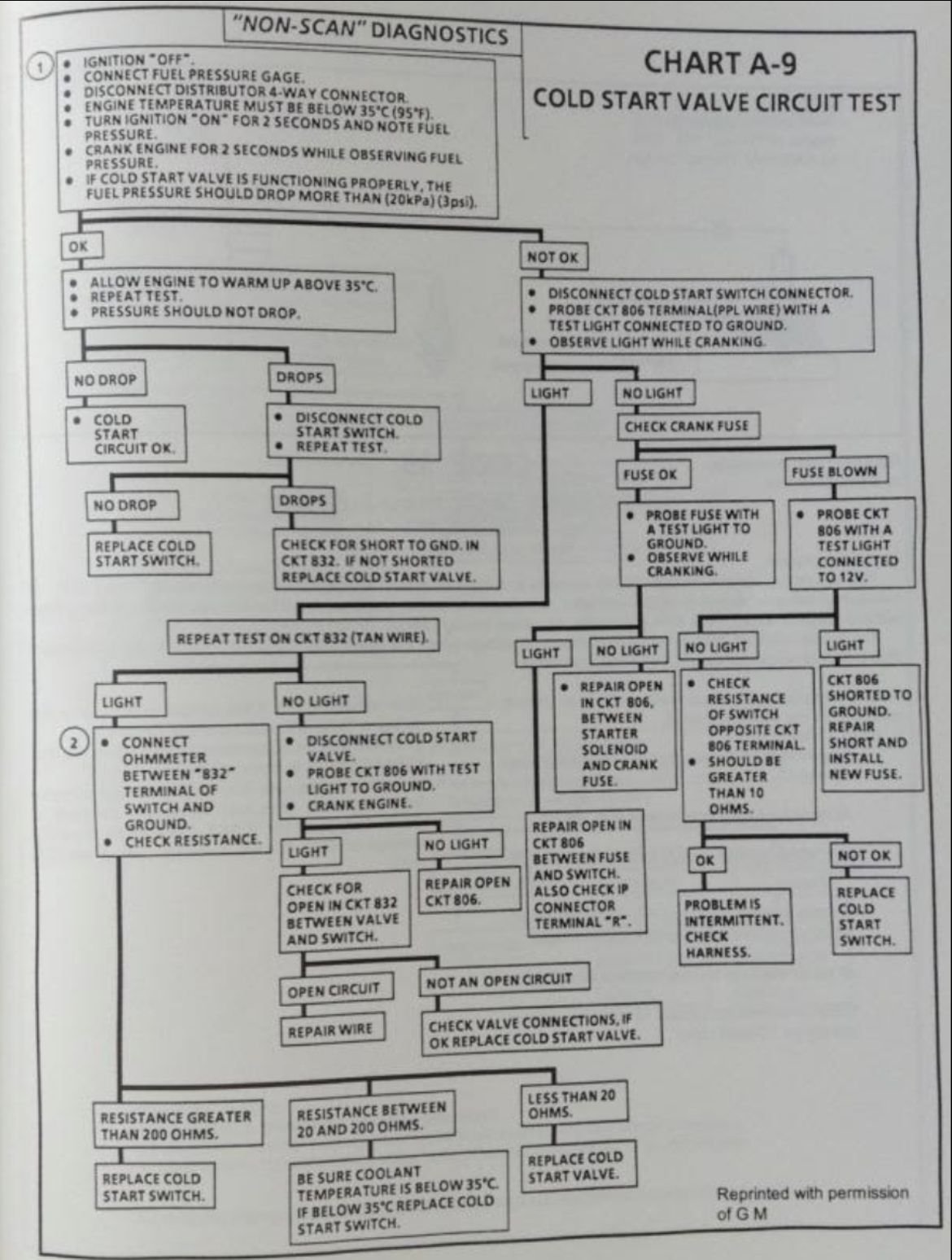

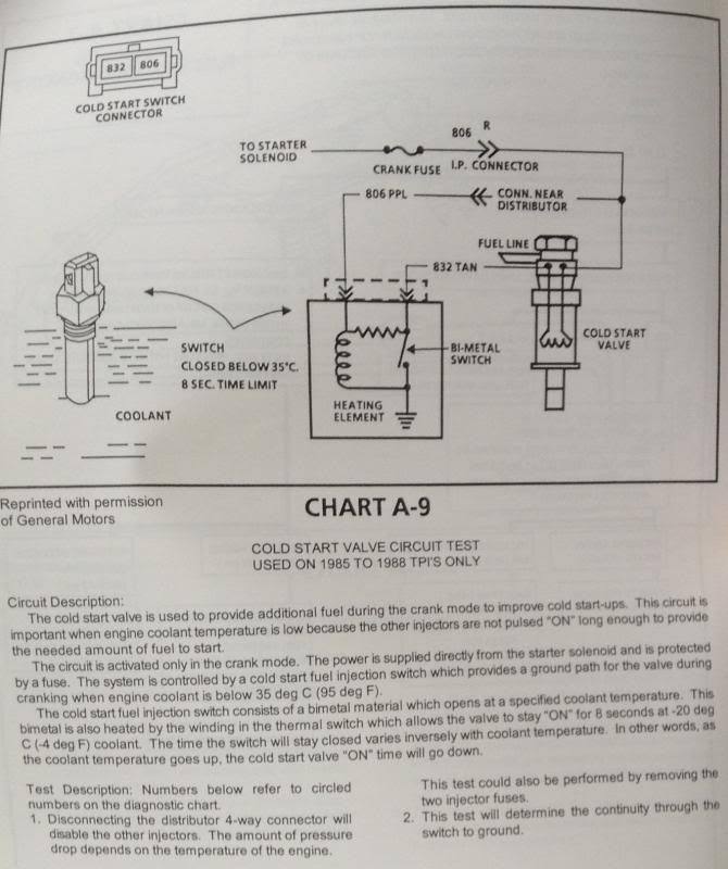

When the ignition switch is turned to the crank position power is sent to the purple and white wire of the cold start timer switch and the ninth injector. The timer switch controls the ground side of the injector.

Originally Posted by Tunedport90
I haven't seen this version of the CSI troubleshooting chart before. Thanks for posting it.
I LIKE the initial test for pressure drop in the first step. Note that the third bullet is "disconnect the distributor 4-way connector". << This is to disable reference pulses from reaching the ECM. If ref pulses are not disabled, the fuel pump will run as soon as the engine is cranked, invalidating the pressure readings.
I will add that coolant temperature is super important. If the thermo time switch has opened because it is 95F or above, the test will not validate the injector itself, just the entire system. So 'my way' of applying 12V directly to the injector while watching the pressure is a more definitive test of the injector itself. If the injector is ok, then further testing of the thermo time switch is necessary.
I don't understand ctmcloskey's comment "as the control system is a bit over-complicated." What? The 90-96 fog light circuit is more complicated. There's only two components, two wires and a fuse. It isn't ECM controlled, and is only powered when the key is in CRANK. The L98 CSI system is identical to the CSI system used on air-cooled fuel injected VW and flat 4 914s in the late 60s, early 70s. This very simple, effective first start aid has been around a long time, because it works.
He also says "It is a nice way to start the engine when it is really cold outside." I've never considered 95 deg F to be "really cold". Actually 95F is "hot" to me. But the L98 needs the CSI for easy starting at up to 95F.
